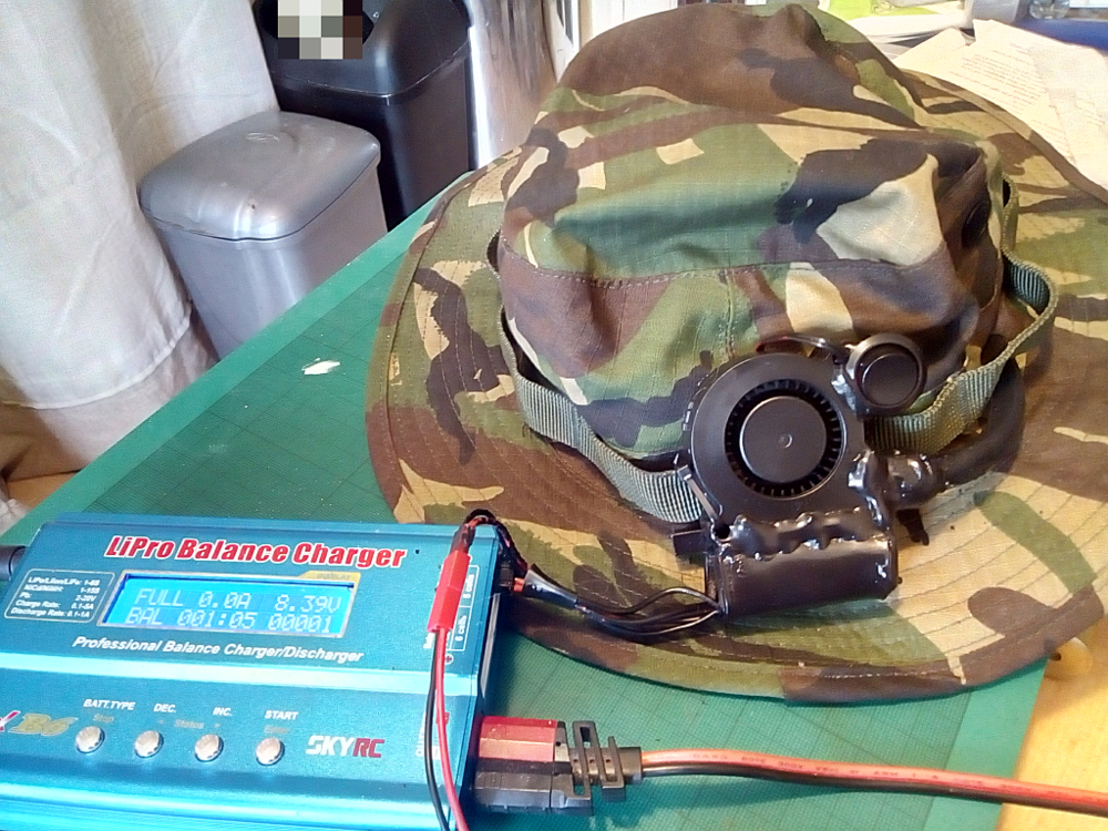

41 minutes ago, Rogerborg said:
Good news, my hat is fully charged!
I've just thrown that unit together from a 12V fan[1], a small 7.4V lipo with some kydex wrapped round it to make a holder, a switch, and some silicone tubing, all liberally[2] hot-melted together and finished off with Poundand's very best rattlecan black.
[1] This is running much quieter off of 7.4V than the visually identical one sealed in to my Space Soldier helmet.  I wonder if that might be a 5V unit.
[2] Liberally in the sense of sloppily, lazily and without any care or pride in my work.
If it works and it does the job who cares what it looks like. I keep telling myself that about the wife.?

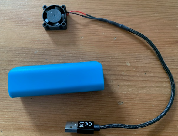

Just had a 25x25mm fan arrive today. 5v version - planning to use a cheap Poundland 2000mAh rechargeable USB power bank.
It's a perfect fit on my paintball goggles (Empire E-Flex) - sits flush with the top of the lens.
@Speedbird_666 I have mine blowing down into the goggles as it’s my spectacles that do the fogging not the goggles themselves
Oh I will add if you have some mouldable putty (like Sugru) to surround the fan/s it will cut down on a lot of the fan whine and will protect it a little too

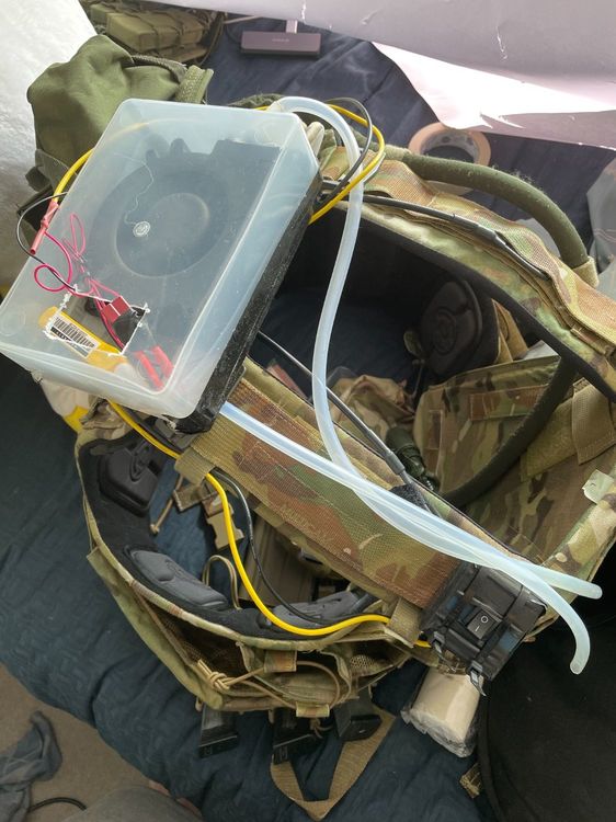

This was my invention, with the switch relocated to my right shoulder
Wow! Is there not a chance that would blow your eyeballs out! Looks v powerful ??
I'm trying to work out a way to keep the pressure up. If i put the fan exhaust next to the goggles, or run a very short tube, its like a leaf blower, but when its tubed up the pressure drops to the equivalent of a person exhaling, which to this point has been enough.
If i tape the box up, theres not enough airflow coming in for the fan to work.
So thats my next thing to tinker with.
Or try with 2 smaller fans in a series circuit, but last time  i ran out of time, tubing and patience

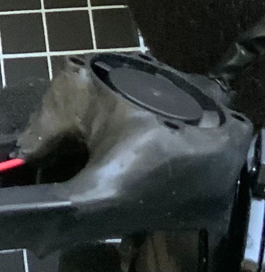

I quickly put my setup together on a spare set of goggles (before I cut up my 'good' set).
I'll wire in a switch at some point, but initial results in testing so far are promising.  I will definitely use Sugru to mount it to cut down on noise/vibration a little as my Peltors tend to exacerbate things.
