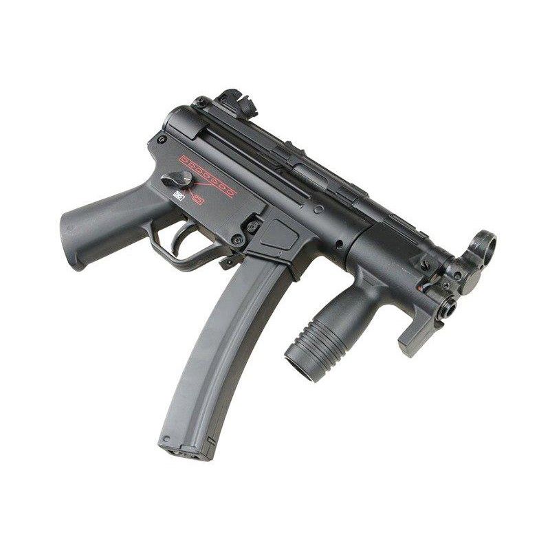

loctez Posted June 11, 2021 Posted June 11, 2021 Hi All, I picked up a cheap Galaxy mp5k to have a go at some CQB (usually play woodland and most of the rifles are too hot/unsuitable for indoor fields) This is the standard no frills/no rails version. What have people seen as a solution to mount a flashlight onto this bad boy? The options I have come across: 1 - Gaffa 2 - Drill and mount a small section of rail to the handguard 3 - top rail + canted side mount rail Any suggestions?

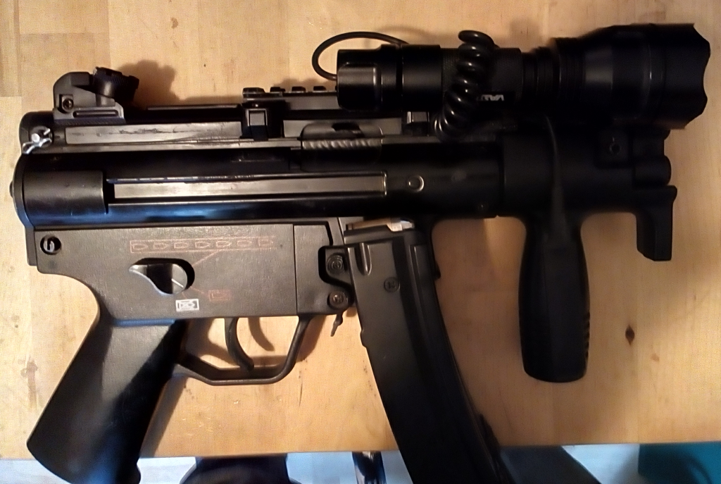

Speedbird_666 Posted June 11, 2021 Posted June 11, 2021 You go with something like this (Yes, I know it's gopping to look at)
Supporters Rogerborg Posted June 11, 2021 Supporters Posted June 11, 2021 ^^^ That gopping solution is surprisingly cheap from PatrolBase. I've gone with a clamp on rail (MP5 / G3) and an offset mount FTW. Good job on scoring a Galaxy, they're cheap, fun little guns, and surprisingly shooty: mine was 0.9J (310-315 fps) out of the box and is up to 1.04J now (335fps) with a 6.01mm AOLS barrel, Maple Leaf rubber and an M100 spring (plus o-ring stetching and greasing) on the stock air components. I think the stock spring is maybe an M90. Should you ever need to know, the hop unit is Jing Gong equivalent. The weak points are the sloppy hop, stock battery, the motor and the lonnnnng trigger pull. 7.4V lipos can fit down the tube and you can even just about squeeze in a small mosfet - I recommend switching the wiring to the rear. Retain the plastic gubbins in the front though, as it gives some rigidity to the muzzle. Pushing or pulling on the grip can deflect the muzzle, which is an issue if you've got a tracer or suppressor on it, it can actually cause the BBs to impact on it. The slide hop isn't great, it's not precise and mine was loose from the factory and loved to wind itself off. I'd recommend tightening up the screws on both sides, cable-tying the hop arm to the barrel, and/or packing rubber o-rings under it to give it more stickiness. A better motor really helps with trigger response. With a Big Dragon M140, 7.4V lipo and mosfet mine is pretty snappy now. The trigger itself is problematic, you can't shim out all the slack or else it doesn't reset, although I've got small pieces of rubber glued front and back to take out as much as possible. An optical trigger mosfet might solve it. Luke at Negative Airsoft demonstrates on this pre-gopped example (and yes, mine was missing the motor pinion grub screw too)...
Speedbird_666 Posted June 11, 2021 Posted June 11, 2021 21 minutes ago, Rogerborg said: ^^^ That gopping solution is surprisingly cheap from PatrolBase. I knew I'd seen it cheaper somewhere - but couldn't remember the vendor! I picked out Z1 only because I saw it in the store last week. Worth a punt for £9 IMO.

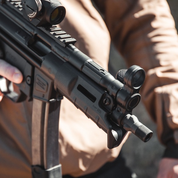

Wavey_Gravey Posted June 11, 2021 Posted June 11, 2021 Magpul make an mp5K hand guard, m-lock slots all round. Or just pop it at 12 O’clock on the claw mount providing you don’t need to use your irons.

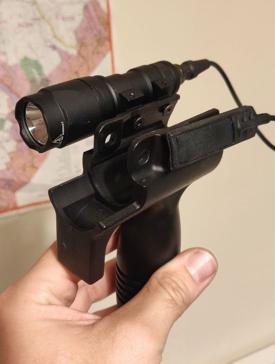

loctez Posted October 14, 2021 Author Posted October 14, 2021 So for those that may stumble across the thread in the futureverse I have finally come up with a solution. I picked up a cheapo weapon light/surefire clone that had a detachable rail mount. Drilled two holes in the plastic handguard and just direct mounted this on. Pressure pad on the other side of the handguard. Doesn't block irons, foregrip can still be taken off for battery replacement (have not re-wired), no "goppy" rails and didn't cost that much. Will report back when if all falls of in the first game.
Supporters Rogerborg Posted October 14, 2021 Supporters Posted October 14, 2021 Nice to see an ungopped solution. Do you find that tracer deflecting your shots? I couldn't get on with a similarly sized Lighter-S and have had to go up to a Spitfire with a larger inner tunnel.
loctez Posted October 15, 2021 Author Posted October 15, 2021 Cheers, saw a lad with a gopped pdw a few weeks ago and scoffed at his weapons inferiority. 9 hours ago, Rogerborg said: Do you find that tracer deflecting your shots? I couldn't get on with a similarly sized Lighter-S and have had to go up to a Spitfire with a larger inner tunnel. Not at all, I remember reading your comments and having a play. I tried to flex the grip about but couldn't get it anywhere near to being an issue. Maybe your threads somewhere are a little off?
