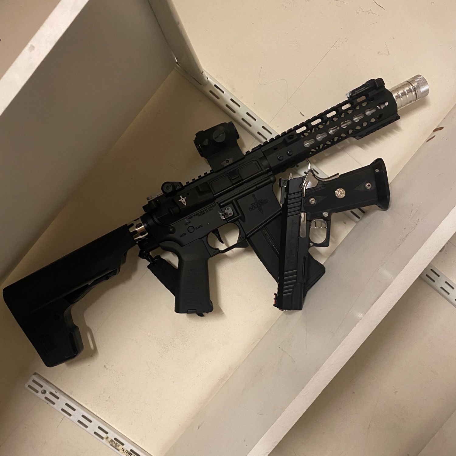

There’s an AEG in one of those photos but something full auto, HPA and blowback is being worked on to replace that

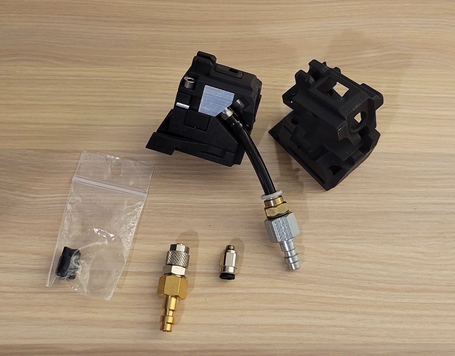

I’m very excited. Finally managed to find one of these Tanuki HPA adaptors. Now I’ve just got to patiently wait for it to get here from the states
Now comes the magic of just slapping an MP5 mid cap into the KC
Suddenly the 11 MP5 mags I’ve got start to make a bit more sense

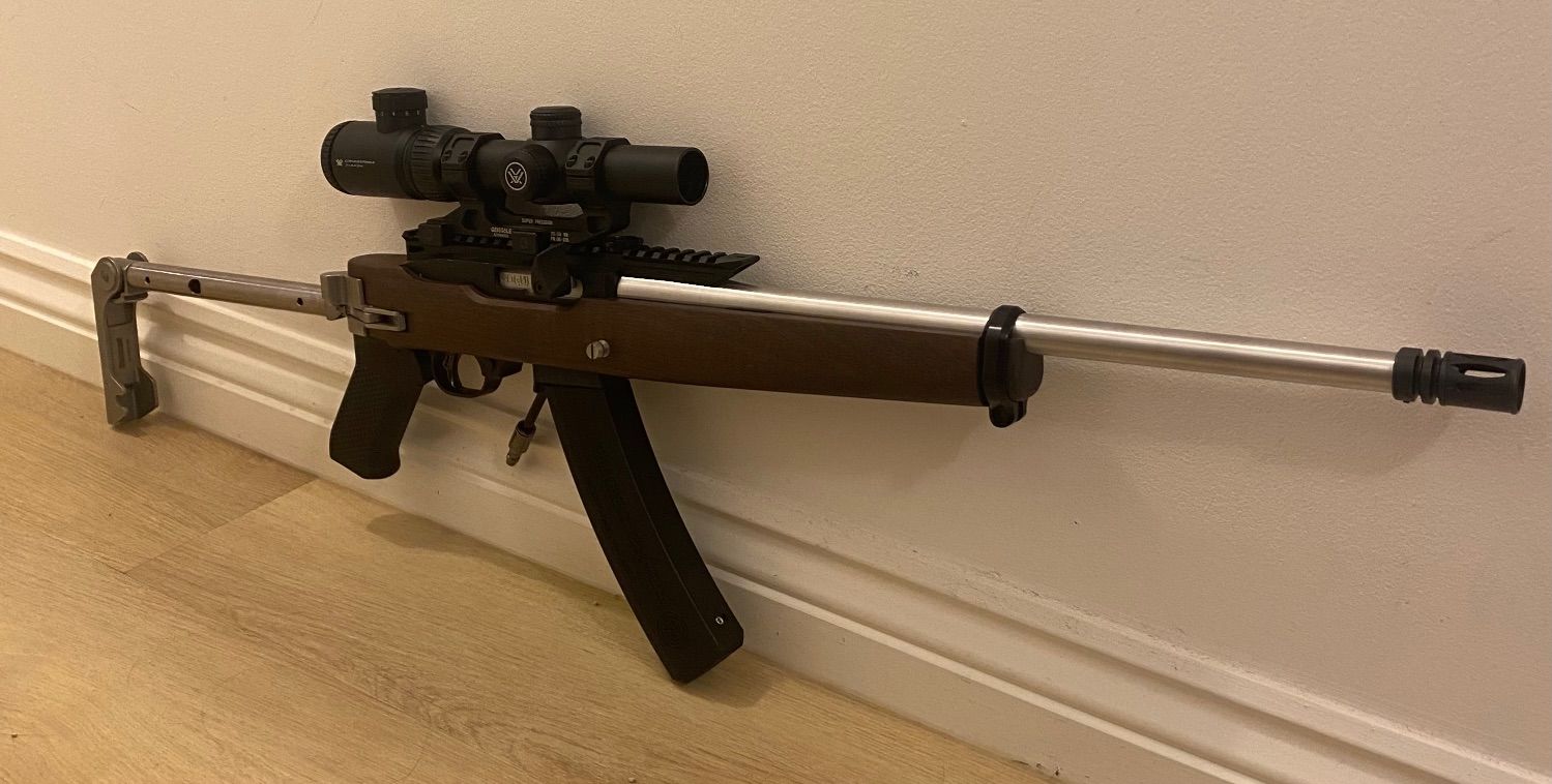

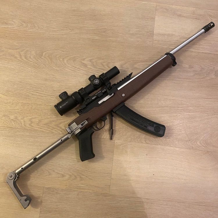

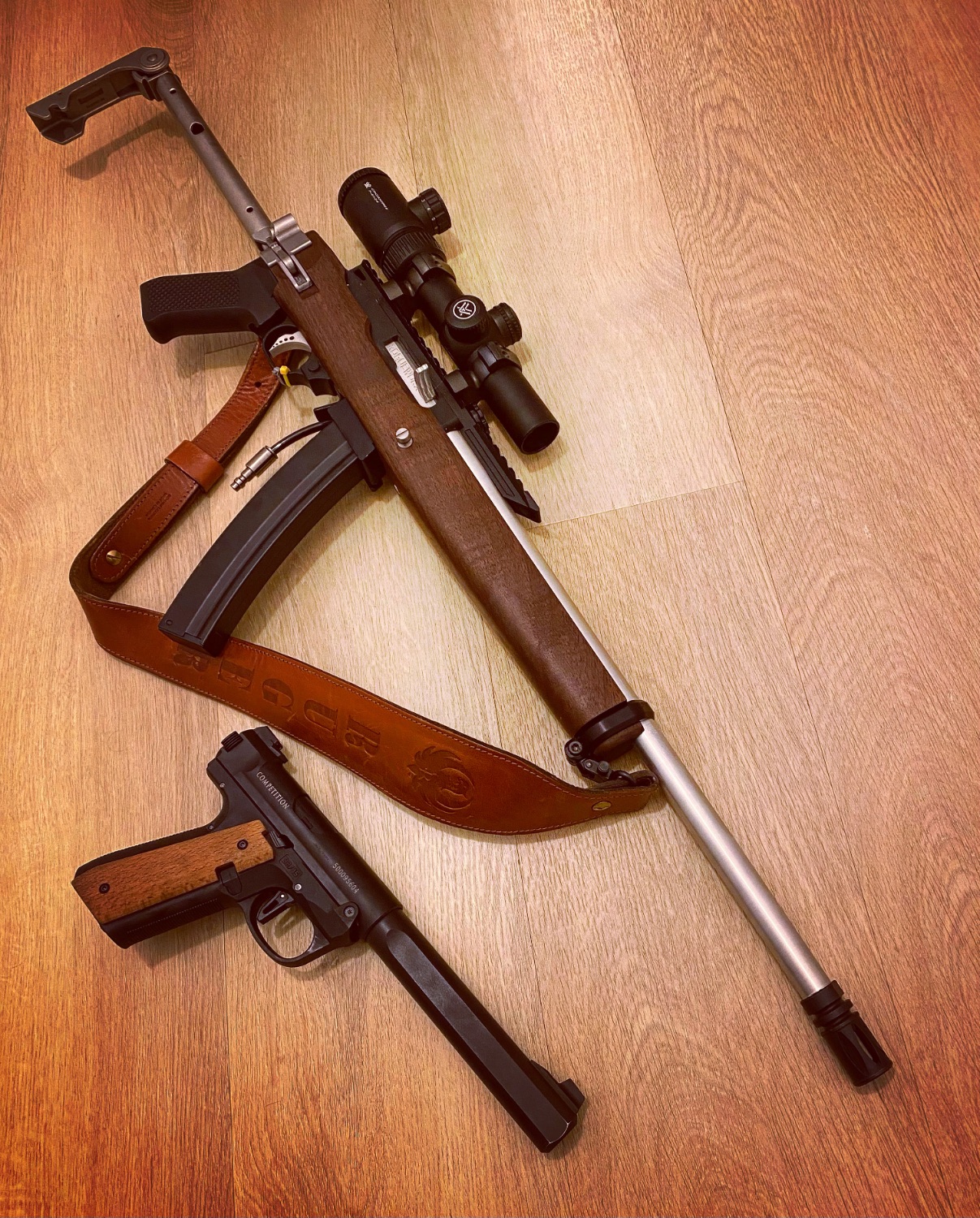

So that HPA mags adaptor arrived. It’s only gone and changed my life.
Gone is the heavy, cumbersome drum. In are the dinky 65rd aeg MP5 mags. The adaptor is extremely tight fitting in the magwell leading to extremely good consistency, I put about 50 rounds through the chrono on my DMR build and ended up with a deviation of +-3fps! I’ve put the Rogueworx Steel bolt assembly in that gun and the noise it makes it essentially porn.
I’ll take some photos today and, if I can work out how, a cheeky video of how loud the DMR build is and how quiet the Sniper

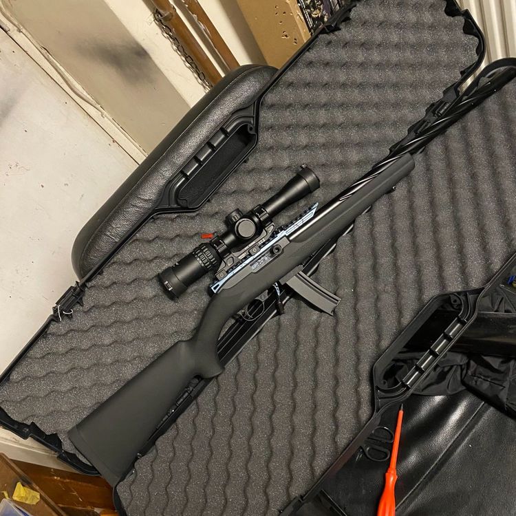

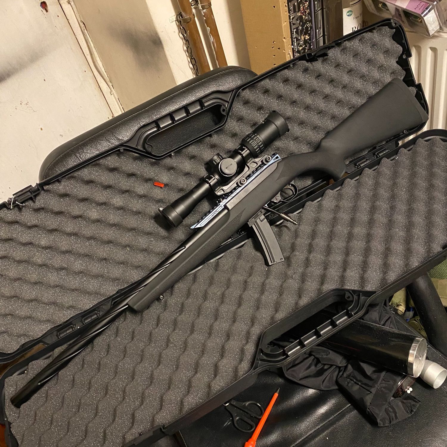

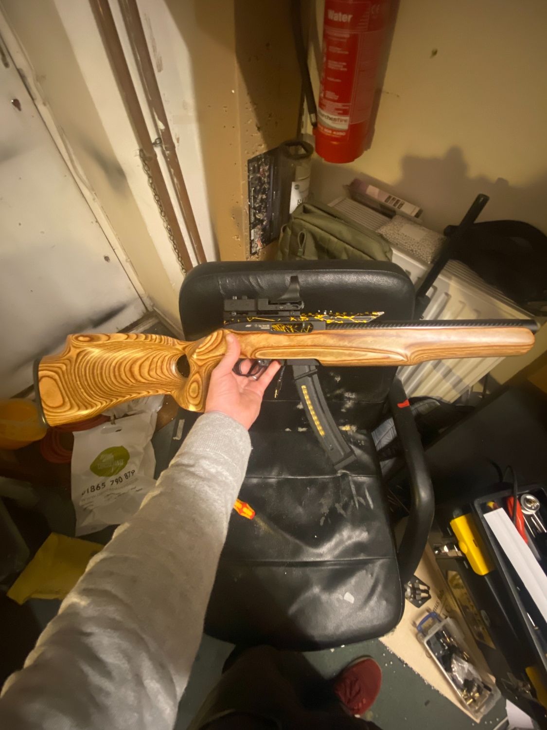

As I’ve got a custom outer barrel being made for this KC and I was really bored, I cut down the stock outer and wrapped it in vinyl.
Stubby, full auto build is coming together
Stubby, full auto KC02 ready for Sunday

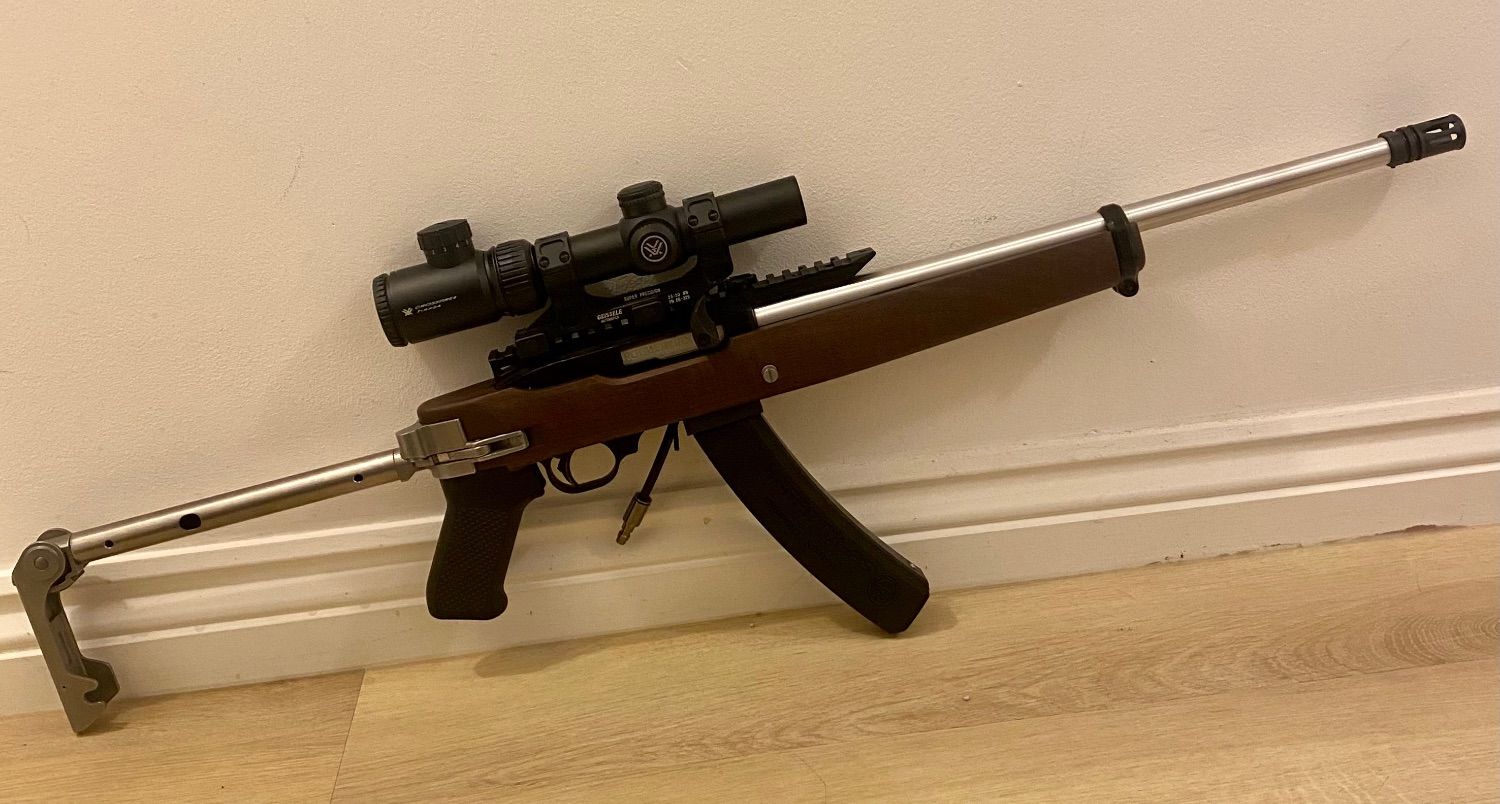

This thread has taken some odd turns. It was meant to be a straightforward journey; buying a battered KC02, slapping it in a wooden Ruger 10/22 stock and tapping the mags. It’s ended up with three completely different builds that range from dinky full auto madness at 1.1J to single action at 2.32 all housed in RS stocks for the Ruger 10/22 that I’ve picked up off Brownells. The beginning of March should be interesting as I’ll have some custom barrels and a Rogueworx underlever kit to fit.
I wasn’t expecting to find a platform as customisable as the HiCapa when I opened the box on my first KC02.

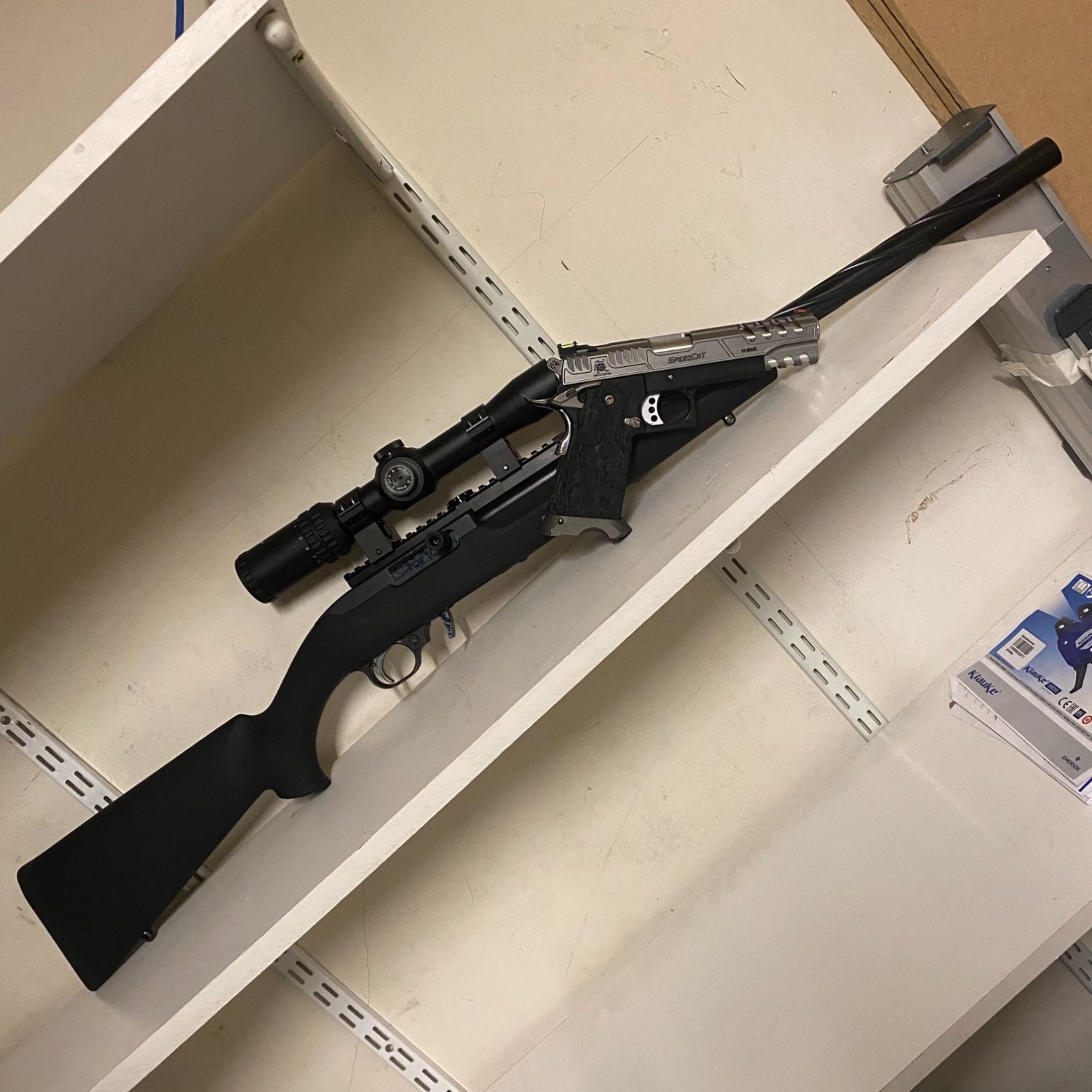

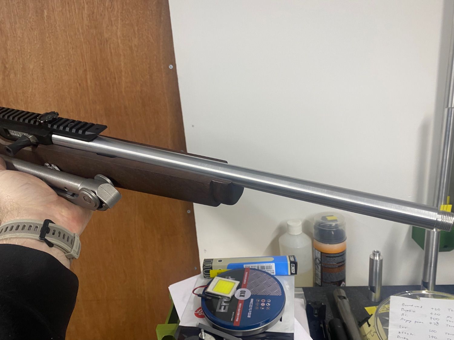

One custom outerbarrel has been completed. Very tasty update coming on Wednesday
Big thanks to the big man Project over at PPT - Project Precision Turning
Edited by Alimcd
It’s pretty subtle from this picture, but that’s a 400mm tapered barrel made to mirror the bog standard Ruger 10/22 factory barrel.

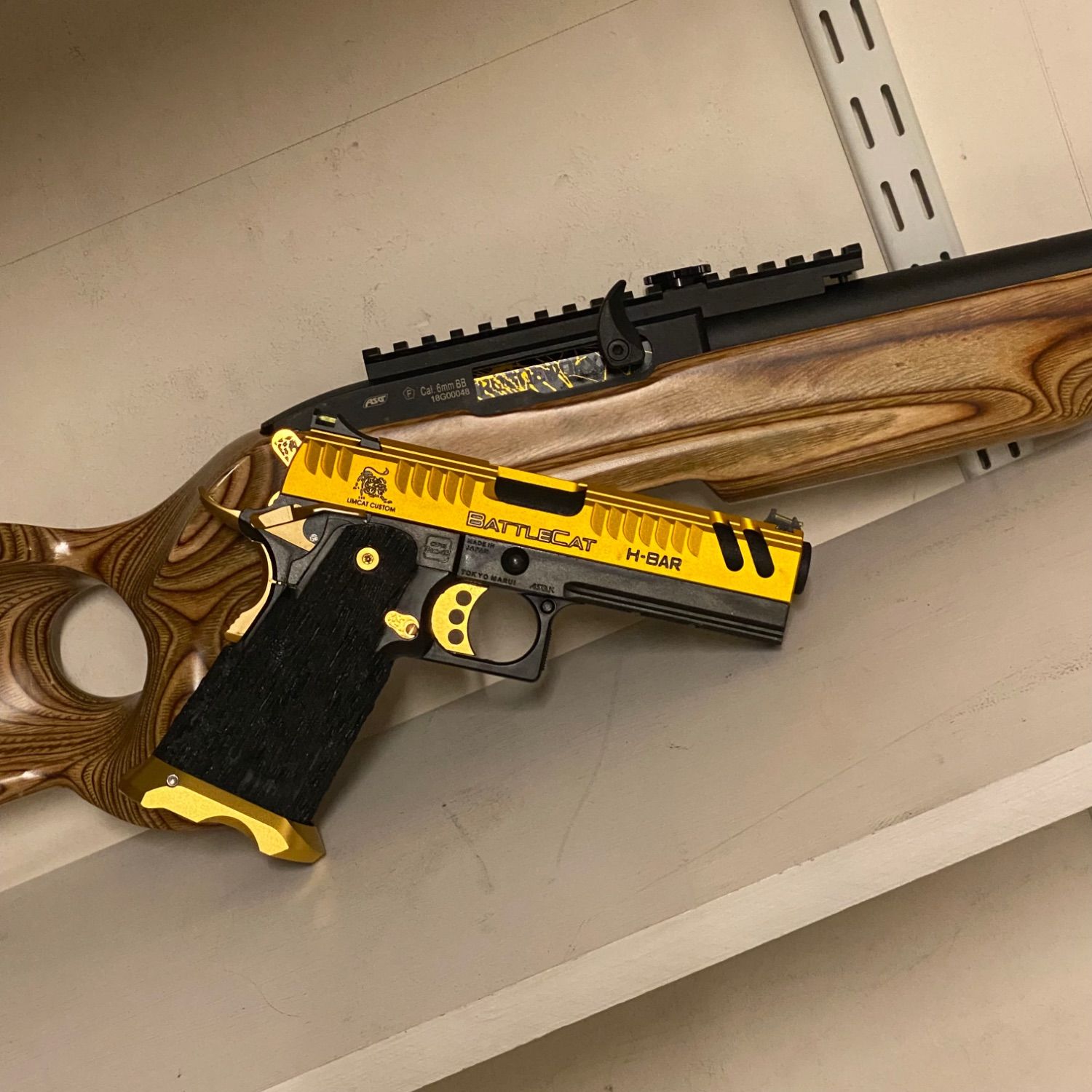

Nearly finished with this Samson B-TM build.
Jack at Airsoft Engraver is a pleasure to do business with

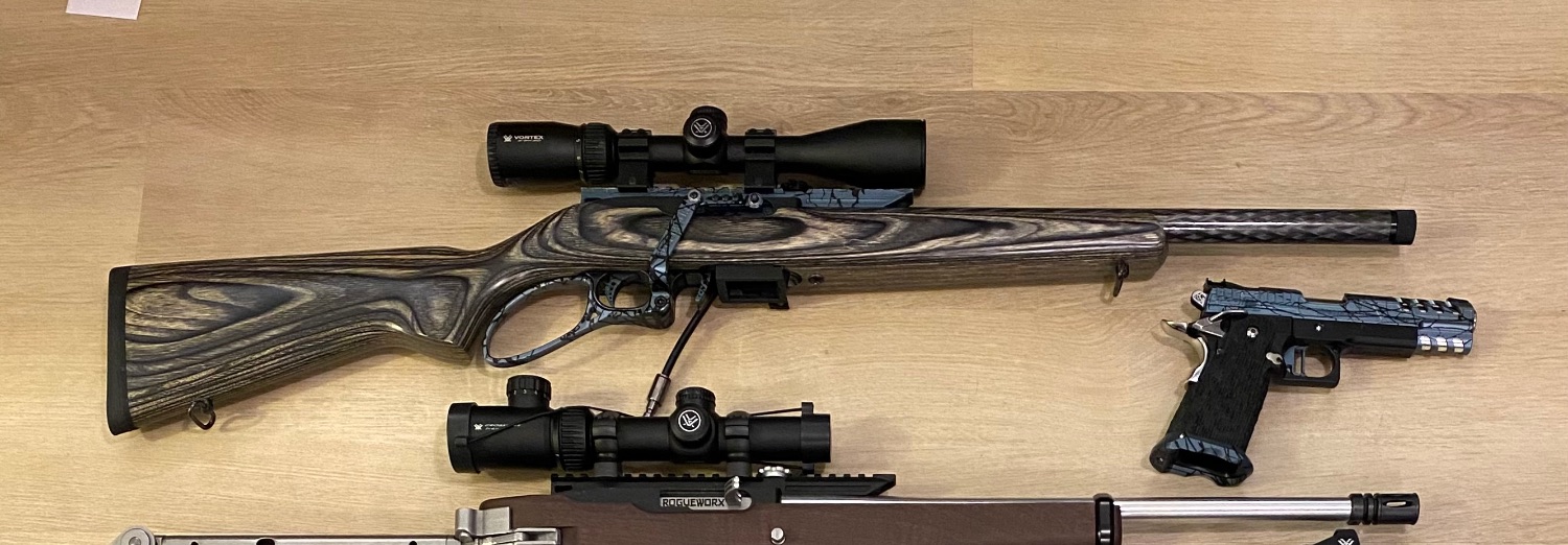

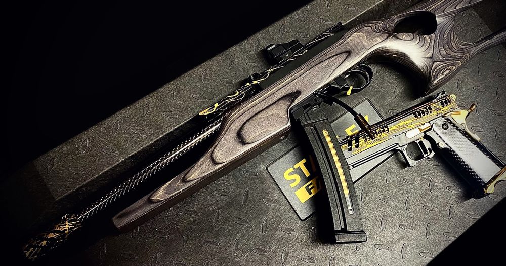

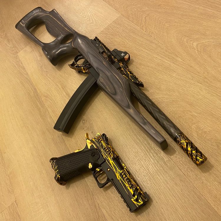

Wait until you see what’s coming next for mine. Got a couple of custom carbon fibre outer barrels for my short one and my underlever
Oh I'm a slut for carbon fibre! Exposed weave?
You know it. There’s an anodised endcap at either end and a 23mm dia carbon tube between them. I had the test run on my Underlever build but the finished articles are just about finished. The final versions will have matched splatter anodising to match the rest of each build

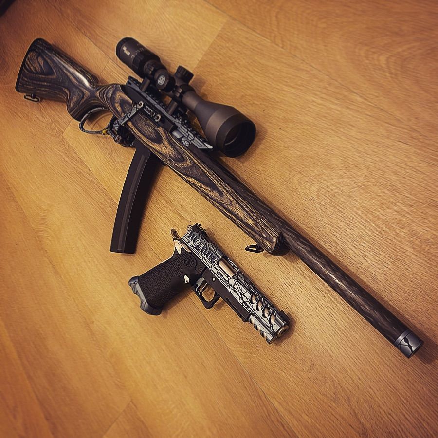

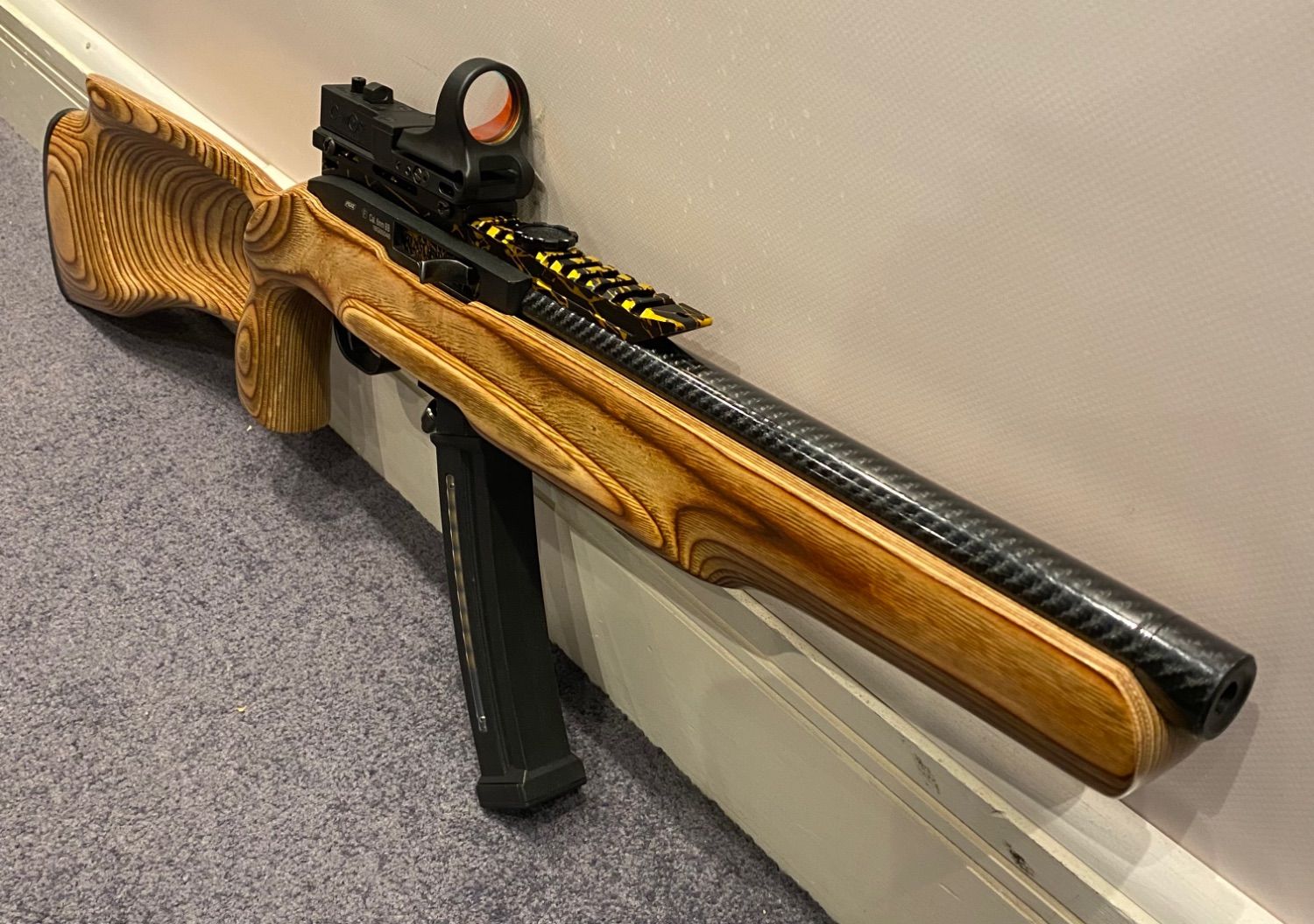

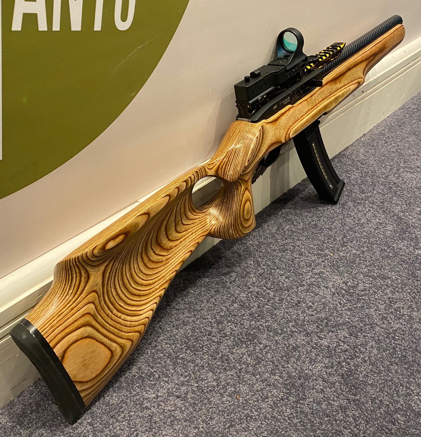

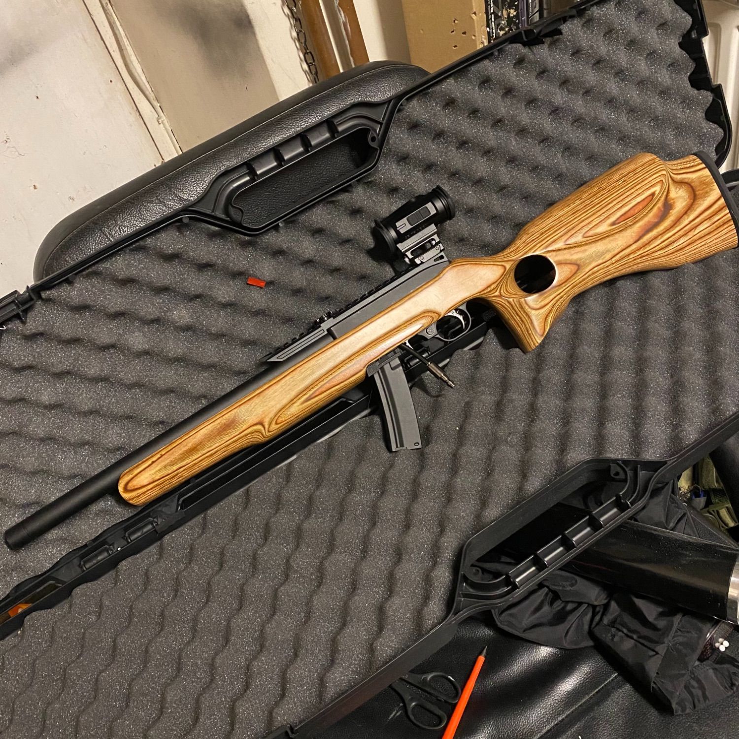

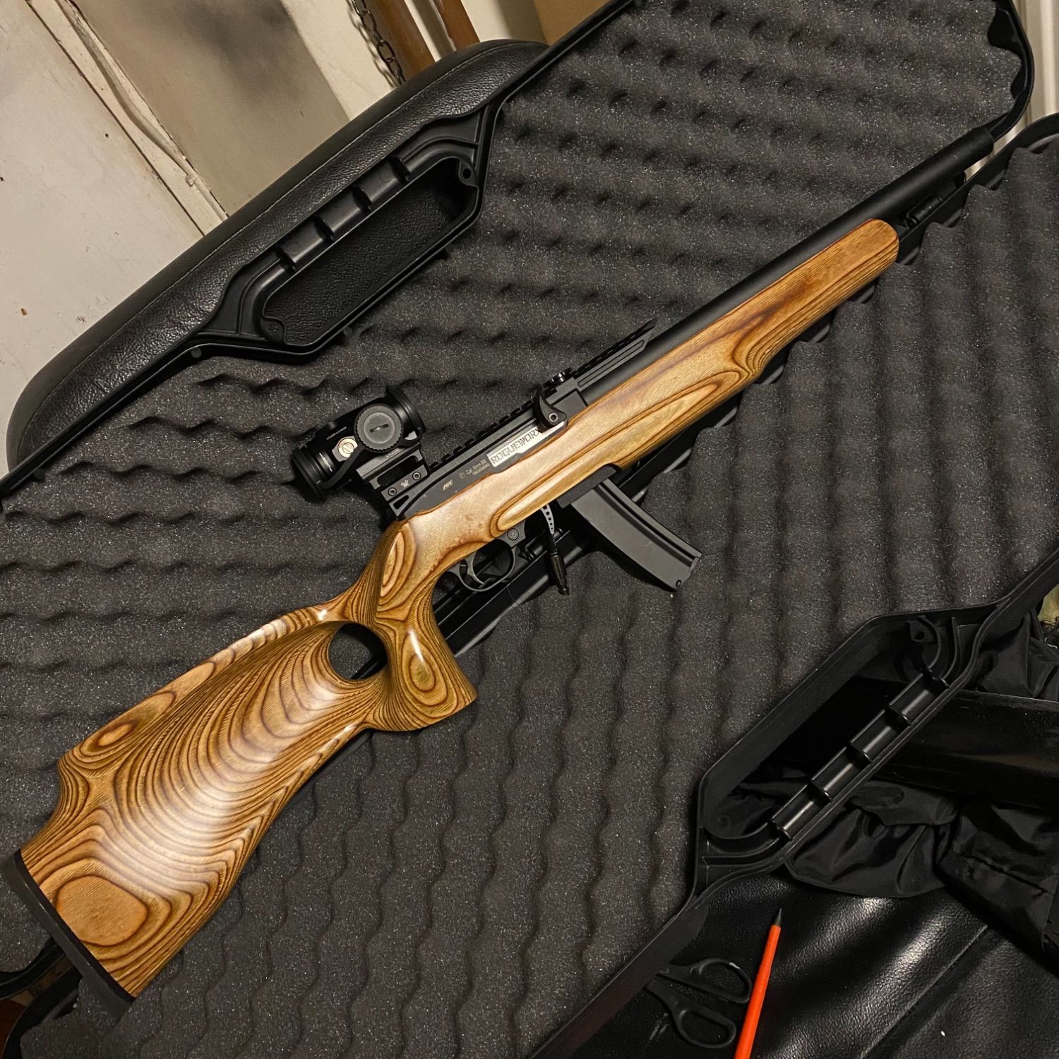

Collected the barrels during the week, finally home so I had time to install yesterday
C90F5EC7-0570-4F4B-B67C-B76DC7200109.jpeg899C17F7-BD3F-483E-8C2E-300BB18178E6.thumb.jpeg.c2d174c893bedc2190223adb34a47179.jpeg
That might be the end of my KC02 journey. They’re so flexible and the RW parts make them amongst the best - regardless of what role you want them to fill
