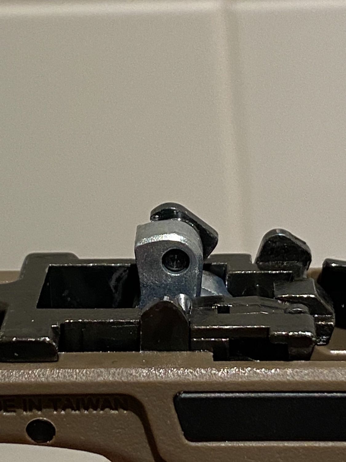

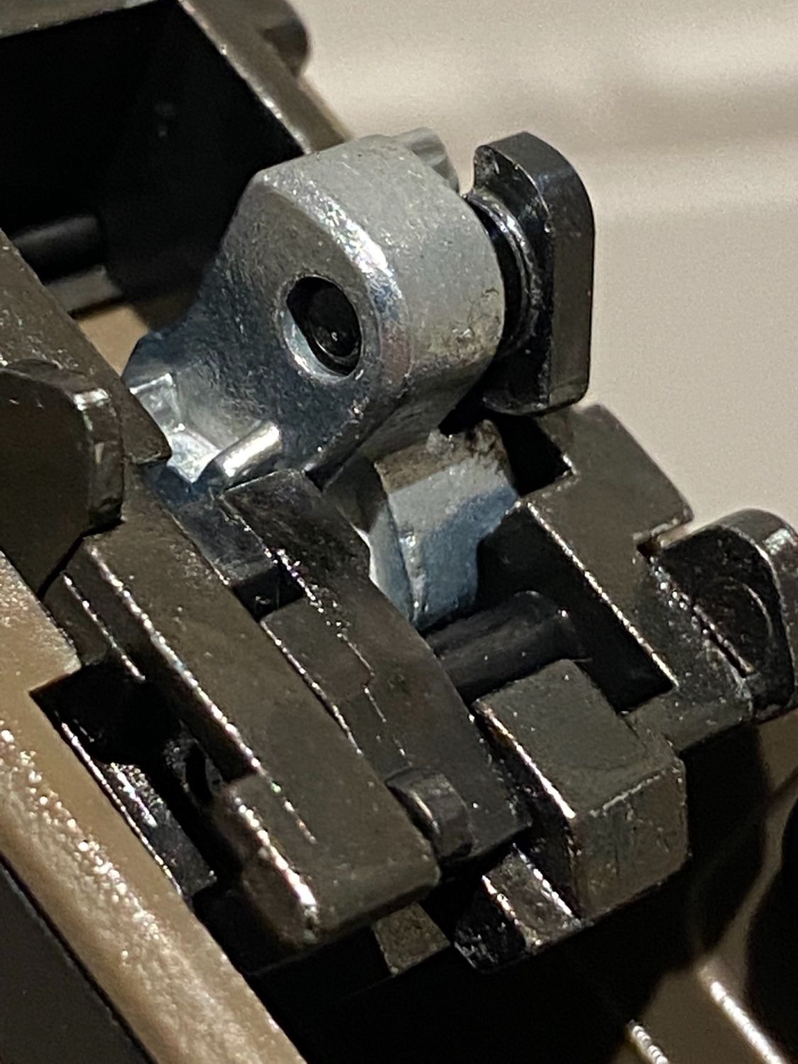

AlphaBear Posted July 27, 2021 Share Posted July 27, 2021 (edited) This is the hammer on mine. Not sure if this is stock or aftermarket? Edited July 27, 2021 by AlphaBear Link to comment Share on other sites More sharing options...
