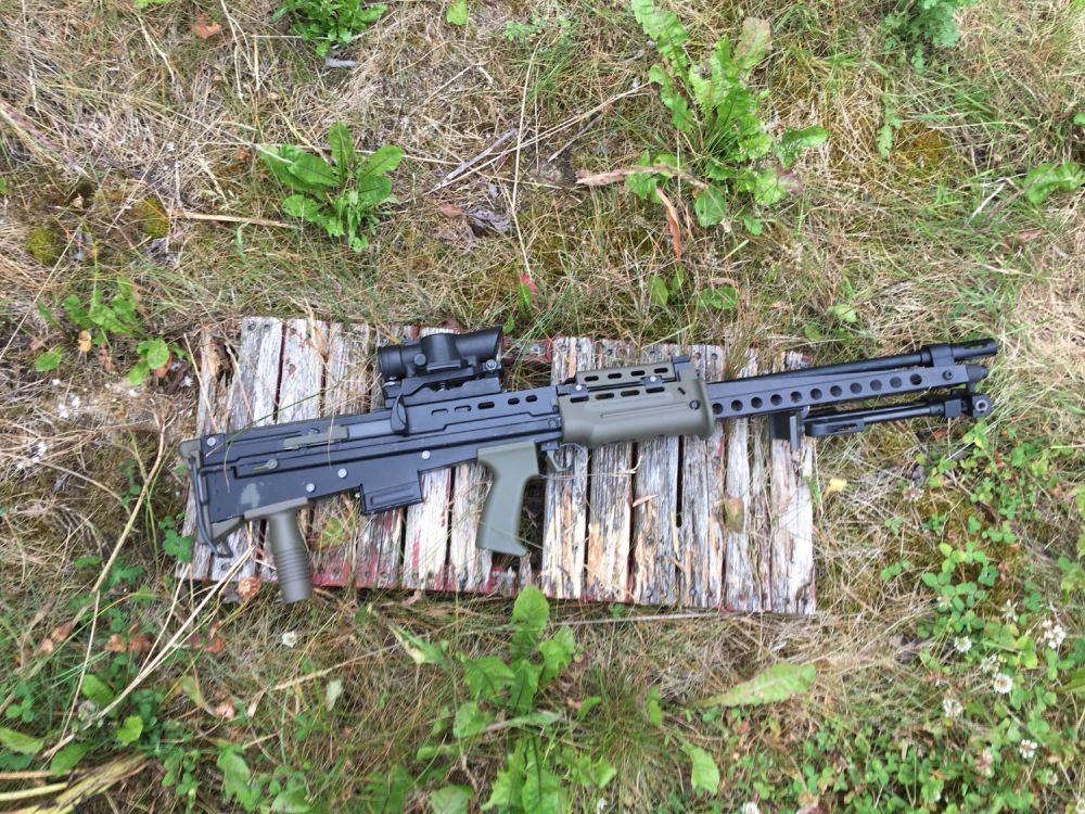

AK bullpup. This was made using a shitty SRC RPK picked up bone yard for £10. The forend was put together from an M4 and AK rail cut up and fixed with a piece of bent aluminium, the grip was carved from plywood and the butt was more bent aluminium. The trigger uses a BTC Chimera with a remote microswitch trigger.

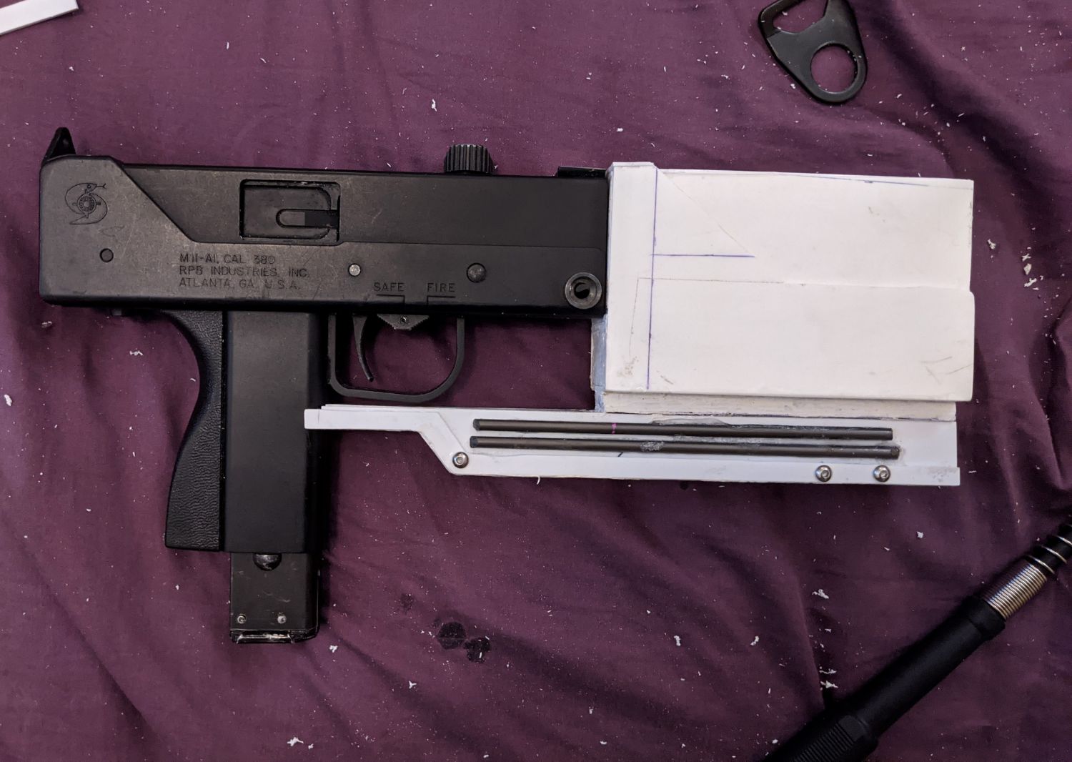

HK 21 PDW using a TM base with the Classic Army metal receiver. This is getting cut down to match RS inspiration and it's getting a 3D printed feed tray, forend and stock and a scratch built box mag.

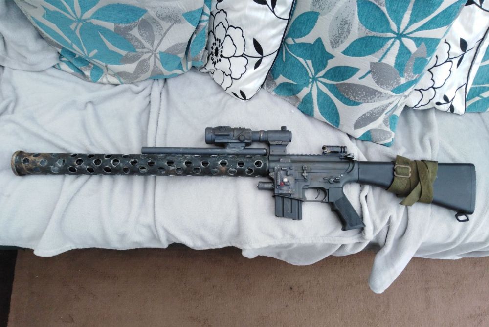

Yup, finally found a use for my AEP.  If you've already got something oversized and comically under-powered, why not turn it into a...

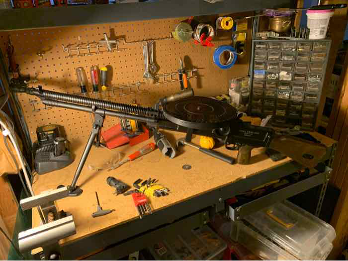

Talked about it enough for now on other threads, but the DP-28 is coming along. So far a new, stronger buttpad locking mount has been completed, the upper and lower mag adapters have been completed, the feed ramp has been completed, and the stopping block has been completed (maybe. Had some issues with BBs getting in the way of the bullet spokes in the mag, but theres bigger issues still to sort before I make improvements). However BBs are still slipping through somehow. I suppose next is to recreate my follower in CAD as opposed to using the current handmade one. Its the only place where I can see bbs slipping through into the back of them mag with the new follower. In terms of things I might still do, I would like to drill into the upper and mount a pic rail for optics. Unfortunately when loaded the pan mag blocks the irons. Now, as this was always kind of meant to be used in conjunction with a Maska-1 helmet, ADSing isnt really an option so its not a huge deal. But if I used it without the helmet it'd be nice to have optics. I could additionally/instead create a second set of vertical irons like the real DP-28 has, and do away with the canted irons of the ZB30. Also, I was originally planning to make a forward locking block for the pan mag to sit on. I dont need to do that as the mag adapter is plenty solid enough to hold even a full mag in place, but it could help a bit with stability. Ill have to field test it first, which cant happen until after the mag issues are sorted.

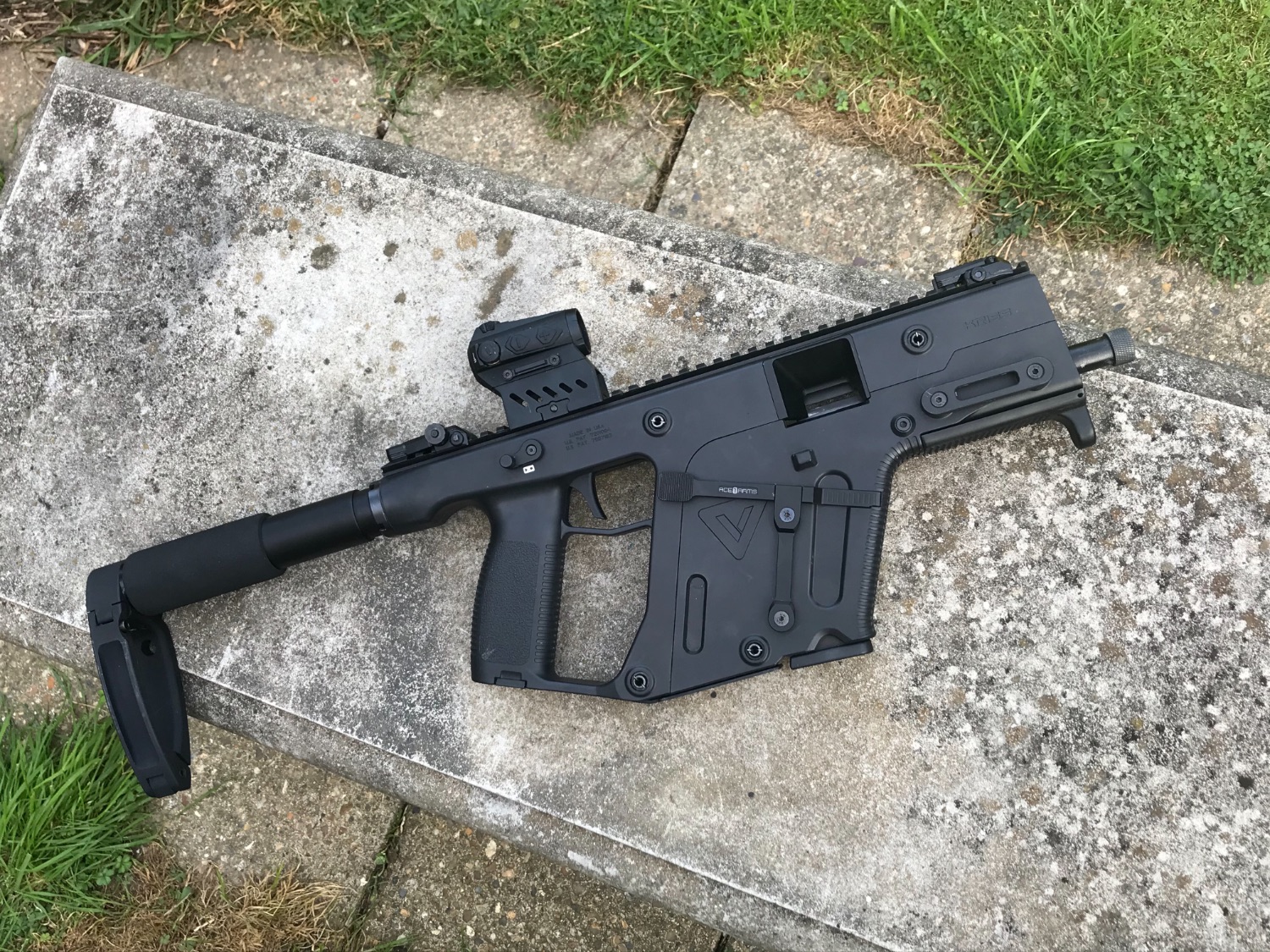

This has been knocking around in a few incarnations now, it’s more or less this configuration at the moment..
Externally, it’s genuine KRISS Vector .45 SDP gen2(2017) fixed stock upper and lower receivers, real steel pistol buffer tube, a genuine Gearhead Works Tail Hook, attached with a modified genuine Farrow Tech Vector adapter.
Lower is internally modified KWA Vector lower components, fitted into the KRISS lower receiver, which itself has been slightly modified to fit the A1A extended mag release.
Uppers have a genuine KRISS .45 semi-only fire control group, including genuine generation2 trigger, semi-sear, frame etc, substantially modified to work with the KWA lower internals.
It has genuineHB Industries safety selectors, genuine Midwest Industries M-Lok front rails and clone Magpul MBUS Pro iron sights at the moment.
Its been a real labour of love, easily my favourite toy gun. Sold it once, regretted it and bought it back about a year later.

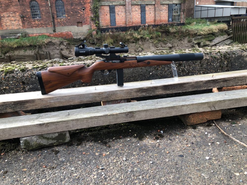

my current project. mainly built from plasticard, currently waiting on some parts and building a holster out of ABS.

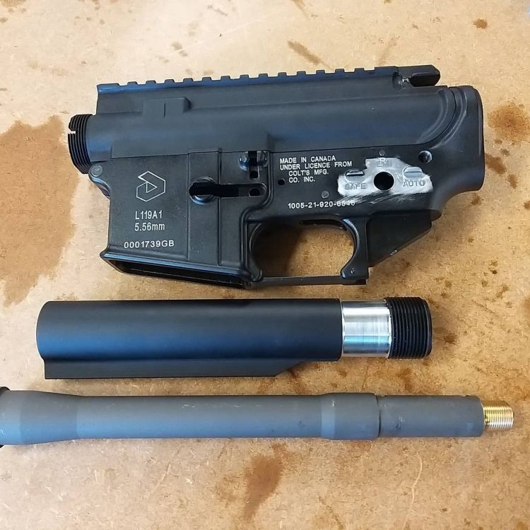

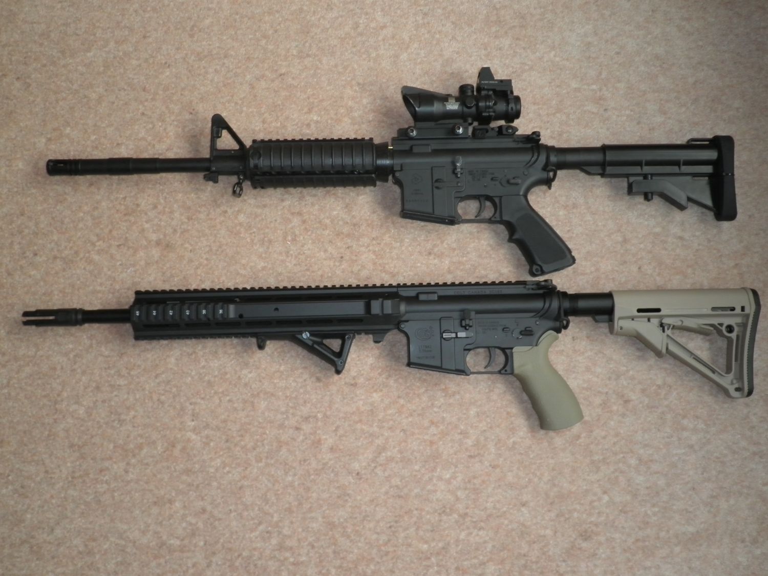

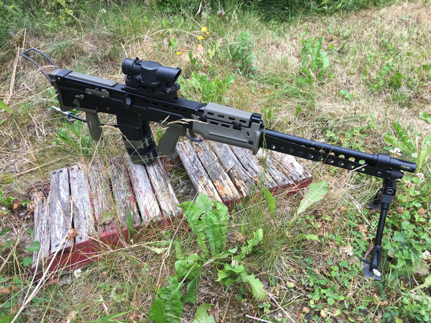

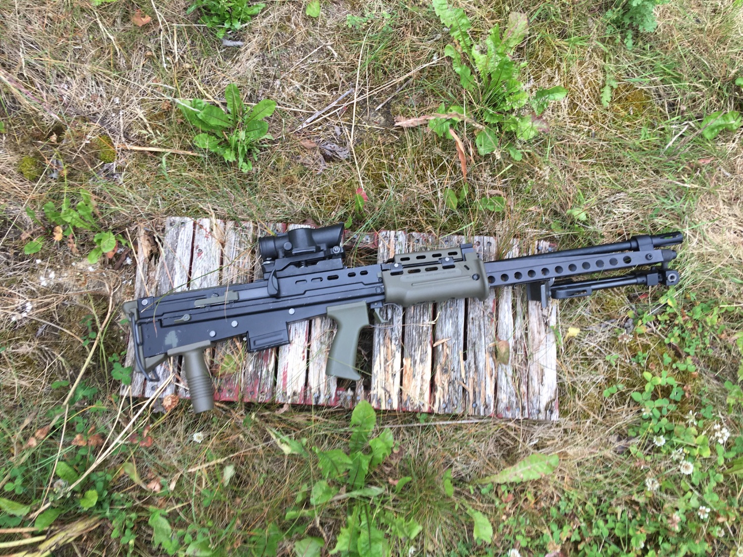

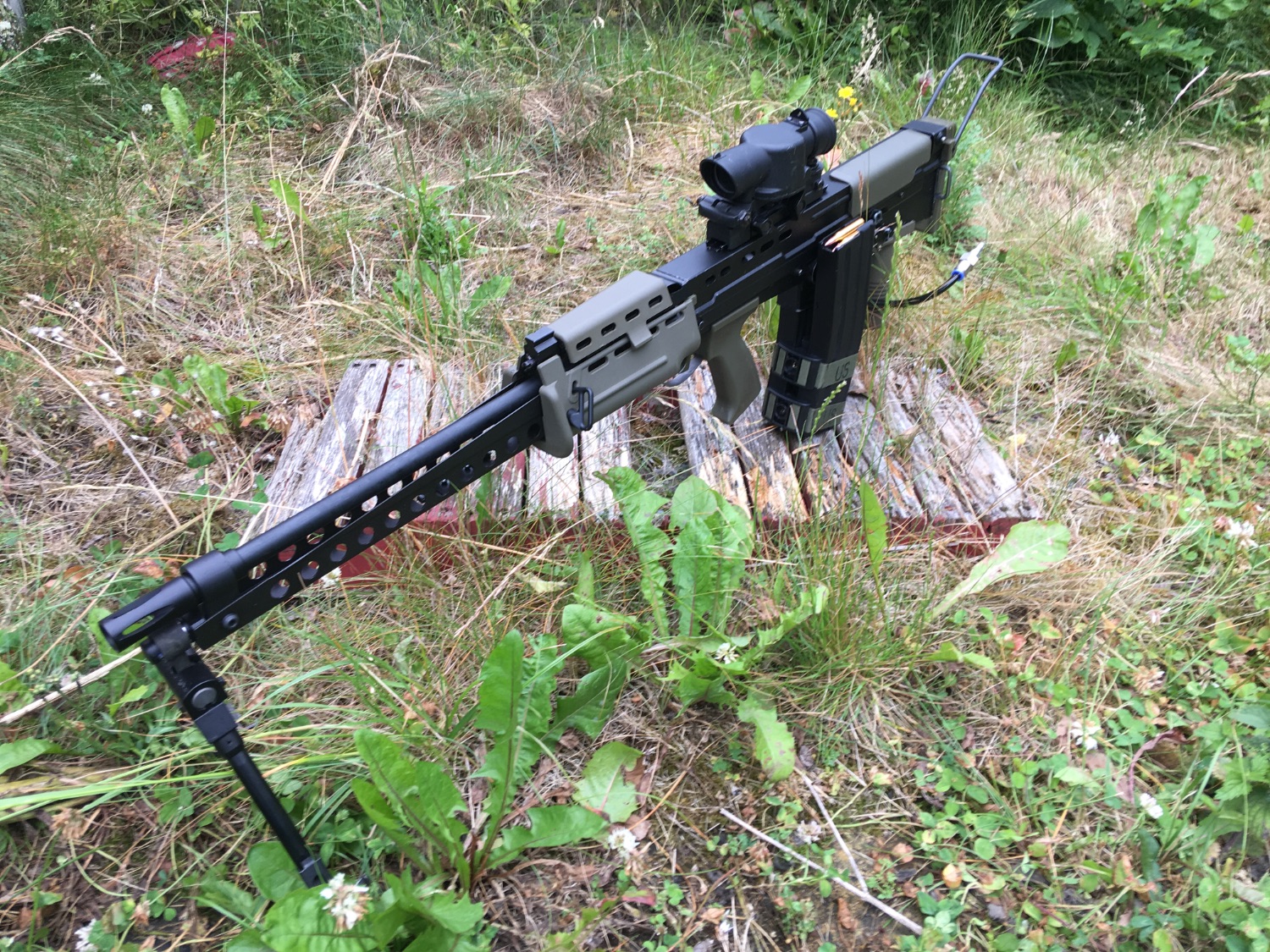

Ok, so they are 'basically' M4's but L119 A1 and A2 . Both built from scratch , no base gun, lots of engraving and machining and on the A2 building up the streangthening webs etc on the upper. Then there is the fun of finding correct parts !
Working on a short A1 GBBR at the moment. parts have just come back from the machune shop.

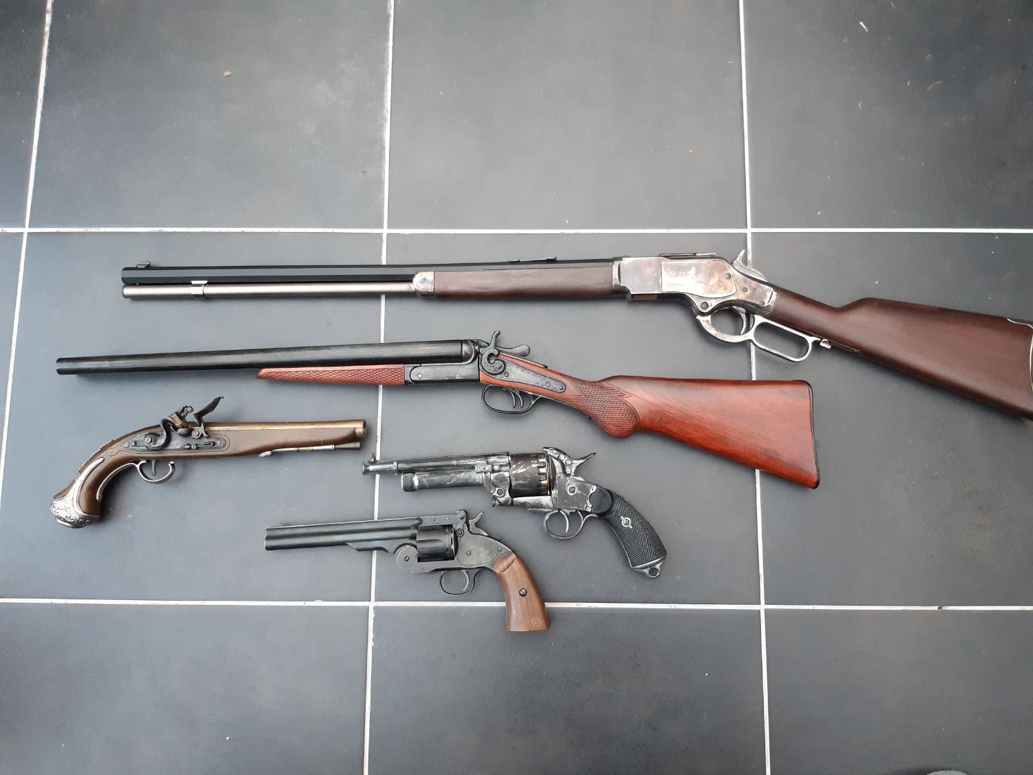

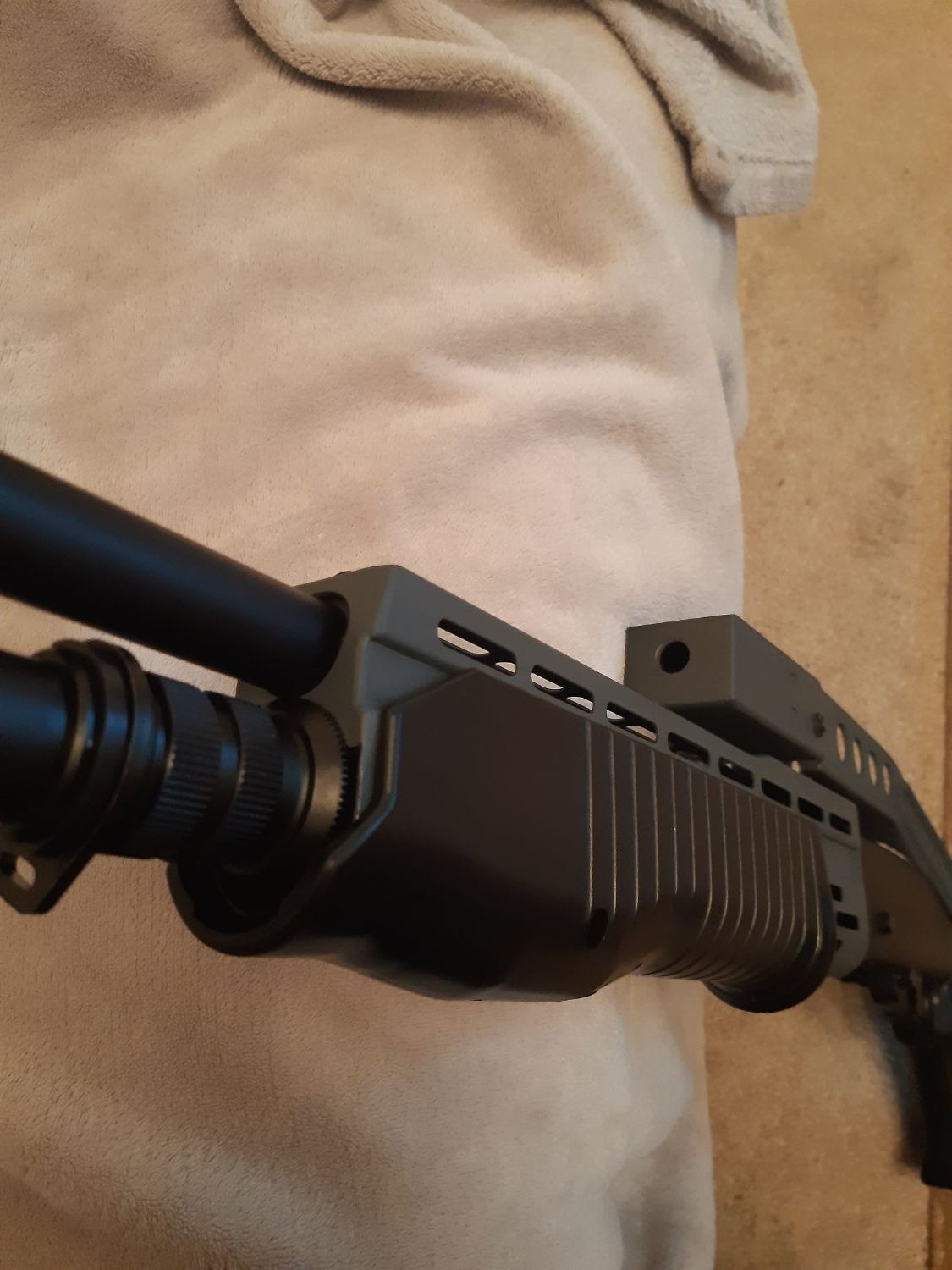

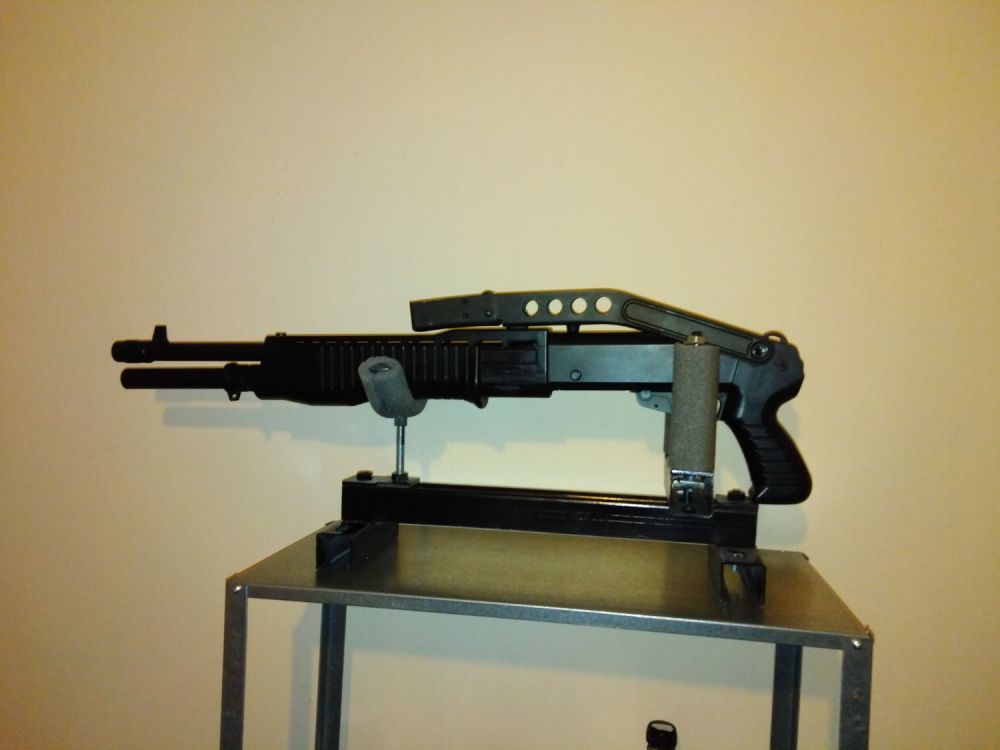

Tm spas 12 with steel heat shield taken from a dead sheriff, and stock.
Denix coach gun converted to aps shells.
(Also a denix LeMat revolver converted to airsoft but not I didn't make it)
Star wars inspired M4 build

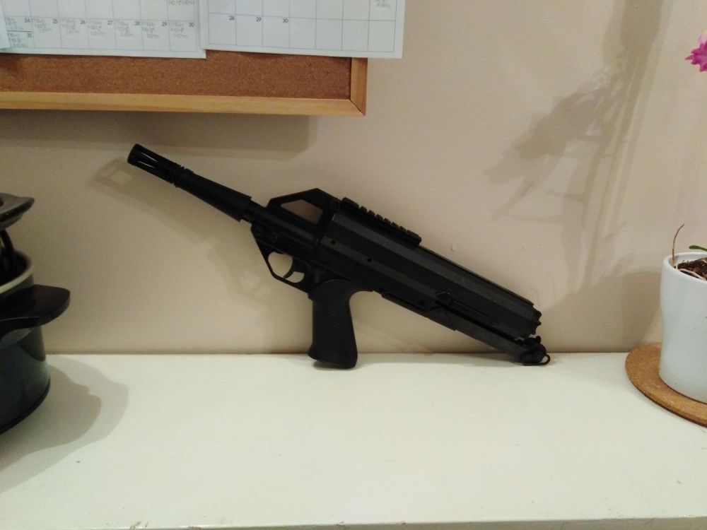

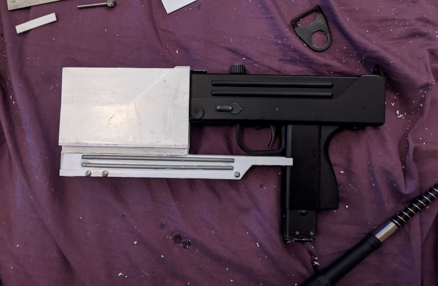

Experimented with a calico pistol. Got some hate for this on a classic airsoft page (All entirely reversible)
Finally a maruzen m1100 inside a tm spas body with a ktw stock

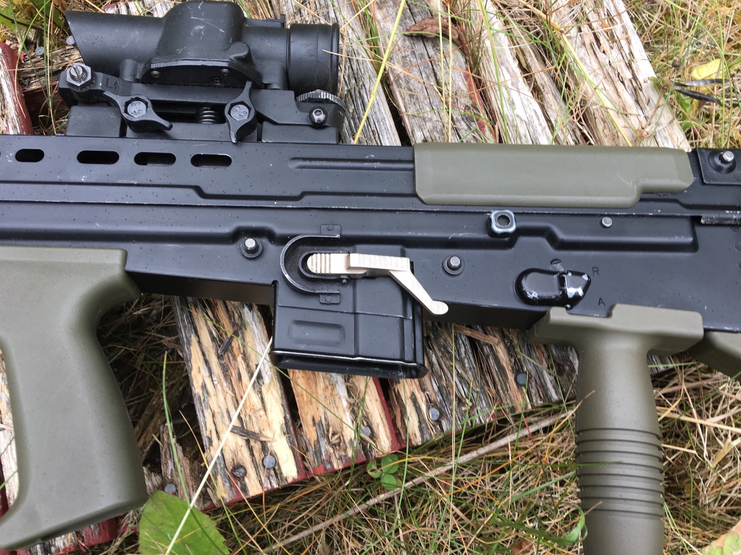

WE L86
started life as a we l85, modified to accept ics l86 rear grip and stock pad. Heavy modified isc l86 barrel, my own design fore support and hop interface bush and locking bush. Lots of other ics l86 bits. My own design ambidextrous mag release (3d printed in stainless steel. All ra-tech trigger internals (except the valve knocker). Reaper customs hpa 900rd electric fed mag.
