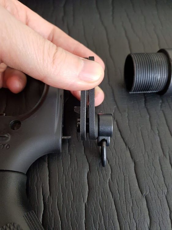

Anubis Posted September 22, 2021 Posted September 22, 2021 (edited) On 15/09/2021 at 06:52, TacticalPossum said: I installed the PTS QD plate yesterday. Perfect fit, no mods needed. Thanks for the replies guys. Yesterday mine arrived and I seem to have a little more trouble. Did you also get the version 2 variant? Did you leave the spacer plate in or switch it for the PTS Plate? Because with the spacer in the QD Swivels don't fit all the way into the opening because the spacer opening/QD Plate opening isn't deep enough. If I leave the spacer plate out it feels not very secure though because the PTS Plate doesn't have the little nose that fit into the groove in the receiver. So it is pretty much secured by the castle nut pressure only and can move laterally. In addition the buffer tube isn't quite rotationally secured because the plate is also slightly too big and can disconnect from the buffer tube groove. I don't feel comfortable to use it to be honest. Anybody has any experiences with other sling plates on the mws? I also found: https://shop.jkarmy.com/artisan-sling-mount-plate-for-marui-tm-mws-gbbr.html Edited September 22, 2021 by Anubis
