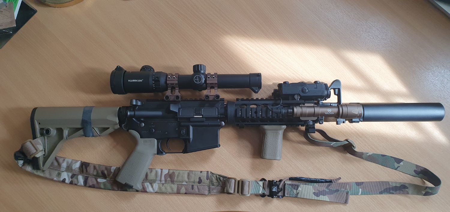

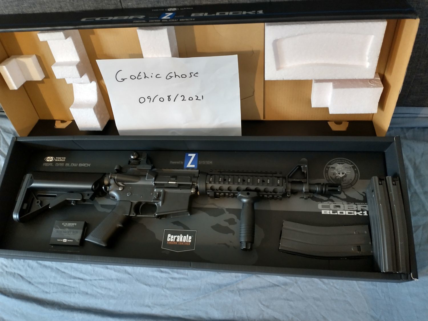

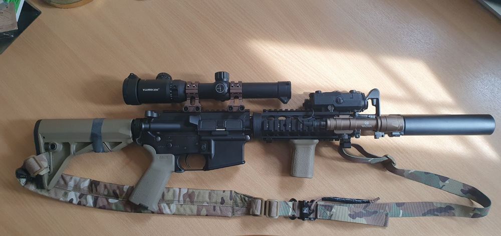

Panama Posted September 13, 2021 Share Posted September 13, 2021 Permission to come aboard folks? After spending the last couple of weeks reading all 350 odd pages of this thread, yes 350 odd, my browser crashed somewhere around the mid 100’s. So I thought well it won’t do any harm to read everything from the start again so I don’t miss anything 😉 I managed to pick up my MWS from @GothicGhost on here on the 10th August, along with a few other bits he had as well. You can probably excommunicate him from this thread now 🤣 This is a pic of it as he had put it back to stock and in the advert: I have since upgraded it and added @davegolf’s awesome SixG Super nub (https://sixgunsmithing.com/2018/03/11/sixg-super-nub-for-marui-gbbr/) and have his HSB (https://sixgunsmithing.com/2019/07/07/sixg-hsb-high-speed-buffer/) on order as well. I also swapped to the Modify Tan bucking and the inner barrel to the G&P Marui MWS V 330mm one that I picked up with it. With a few other external mods and another 3 mags, it now looks like this and I love it Thank you for everyone that has contributed to this amazing thread so far! AlphaBear and Akuma121 2 Link to comment Share on other sites More sharing options...
AlphaBear Posted September 13, 2021 Share Posted September 13, 2021 23 minutes ago, Panama said: Permission to come aboard folks? After spending the last couple of weeks reading all 350 odd pages of this thread, yes 350 odd, my browser crashed somewhere around the mid 100’s. So I thought well it won’t do any harm to read everything from the start again so I don’t miss anything 😉 I managed to pick up my MWS from @GothicGhost on here on the 10th August, along with a few other bits he had as well. You can probably excommunicate him from this thread now 🤣 This is a pic of it as he had put it back to stock and in the advert: I have since upgraded it and added @davegolf’s awesome SixG Super nub (https://sixgunsmithing.com/2018/03/11/sixg-super-nub-for-marui-gbbr/) and have his HSB (https://sixgunsmithing.com/2019/07/07/sixg-hsb-high-speed-buffer/) on order as well. I also swapped to the Modify Tan bucking and the inner barrel to the G&P Marui MWS V 330mm one that I picked up with it. With a few other external mods and another 3 mags, it now looks like this and I love it Thank you for everyone that has contributed to this amazing thread so far! Welcome to the MWS crazy... Firstly well done on reading all the posts.... there's a lot of information floating around on this thread. Yes it can be daunting but the end result will pay dividends... What FPS are you getting with the 330mm inner barrel. Surely that's gonna bump up the FPS by a fair amount compared to the stock 275mm barrel. Oh, your MWS looks epic! Nice choice of furniture Link to comment Share on other sites More sharing options...
Panama Posted September 13, 2021 Share Posted September 13, 2021 4 minutes ago, AlphaBear said: Welcome to the MWS crazy... Firstly well done on reading all the posts.... there's a lot of information floating around on this thread. Yes it can be daunting but the end result will pay dividends... What FPS are you getting with the 330mm inner barrel. Surely that's gonna bump up the FPS by a fair amount compared to the stock 275mm barrel. Oh, your MWS looks epic! Nice choice of furniture Thank you. Using 0.32g bb's it equates to about 330 fps with 0.2g bb's, so perfect. Link to comment Share on other sites More sharing options...

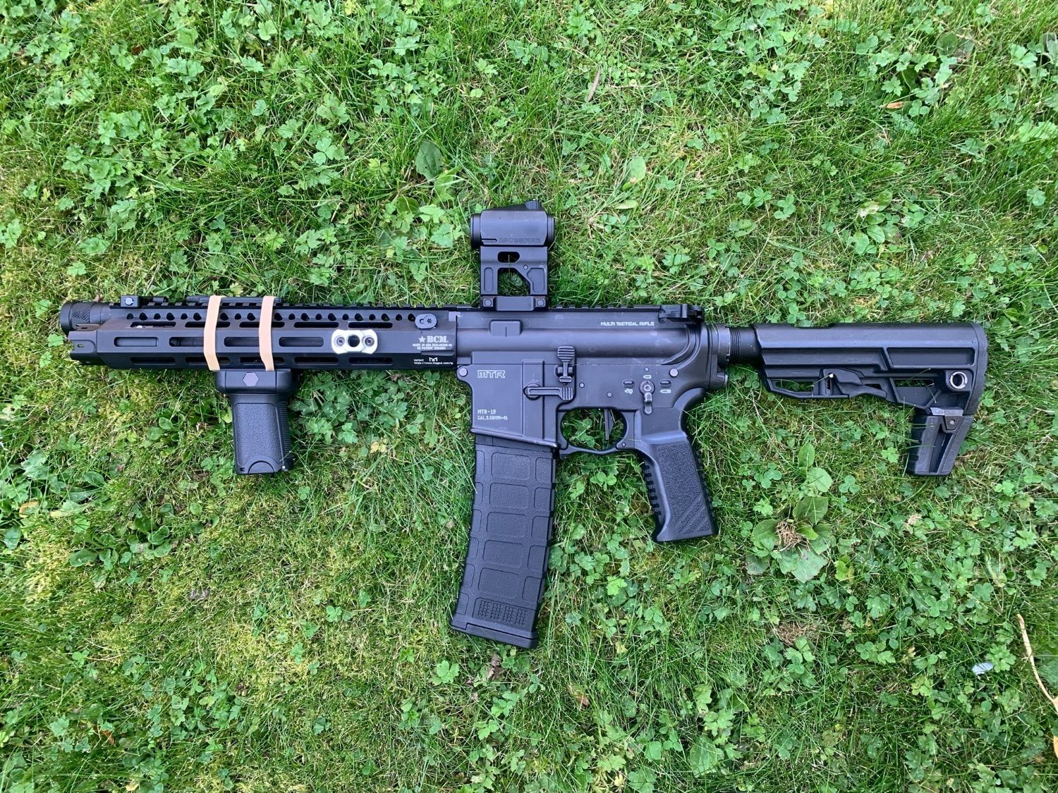

C-Diddy Posted September 13, 2021 Share Posted September 13, 2021 18 hours ago, ash12 said: Yes, sorry! But you were super helpful even with vague detail! I’m looking to stick with the current outer, and won’t change the inner. The 9.3 is out of stock in black, so I guess I’ll have to demonstrate patience!! I fitted the 9.3" HAO to my CQBR a couple of weeks ago. This is the gap between the rail and suppressor. Not ideal but liveable. Oh, and the rail is superbly made Link to comment Share on other sites More sharing options...
