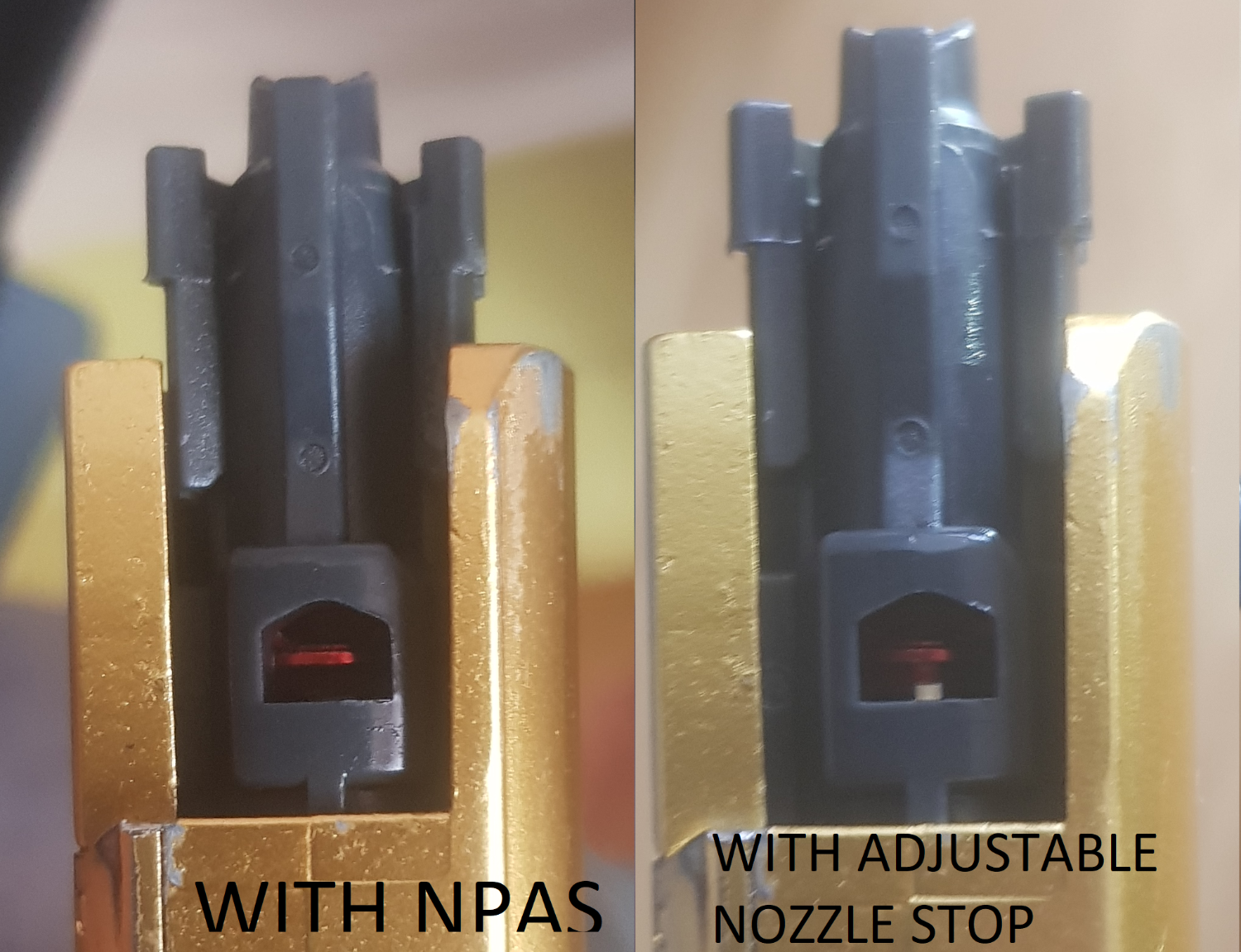

TadsJ2 Posted May 24, 2021 Share Posted May 24, 2021 (edited) On 23/05/2021 at 09:12, sabaka said: thanks for answer😉👍. how is your angry gun gen.2 nozzle set working? worth it to try? Expand Its working fine, u just need to loctite it a bit since its less tight then G&P, but since I will play on higher fps i went with G&P adjustable nozzle (NPAS) set, its has far better quality build so entire AG v2 will be a spare just in case. Tomorrow i will have some time to test whether G&P NPAS nozzle will work with adjustable nozzle stop - so if i dont like how G&P NPAS consistency will be later on i will be able to use it as enchanced nozzle for adjustable nozzle stop after i loctite the shit out of the screw inside Edited May 24, 2021 by TadsJ2 sabaka 1 Link to comment Share on other sites More sharing options...

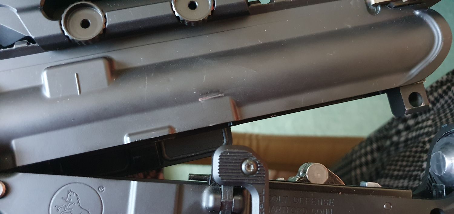

Recoil_ Posted May 25, 2021 Share Posted May 25, 2021 On 22/05/2021 at 17:54, GothicGhost said: I was thinking same thing this today lol but need to find something thin but durable. Expand Mine arrived today, a bit of heatshrink (can be shrunk or left as is). Put it over the rear part. Use the torx tool to punch a hole. Take the heatshrink off and enlarge the hole slightly so the screw fits nicely. Heatshrink back on and tighten down. No excessive pressure on the catch and it will not scratch the upper receiver. Not too obvious unless you look up close. GothicGhost 1 Link to comment Share on other sites More sharing options...
GothicGhost Posted May 25, 2021 Share Posted May 25, 2021 On 25/05/2021 at 16:00, Recoil_ said: Mine arrived today, a bit of heatshrink (can be shrunk or left as is). Put it over the rear part. Use the torx tool to punch a hole. Take the heatshrink off and enlarge the hole slightly so the screw fits nicely. Heatshrink back on and tighten down. No excessive pressure on the catch and it will not scratch the upper receiver. Not too obvious unless you look up close. Expand Very nice I will try that on mine tomorrow 😁 Link to comment Share on other sites More sharing options...

quango2k Posted May 26, 2021 Share Posted May 26, 2021 On 21/05/2021 at 12:44, GothicGhost said: Got the magpul bad lever and bolt locks back fine on stock bolt stop so far. A warning to others do ot use the bad lever as it marks the body of the gun, even after sanding the back lots it will still catch Big waste of £35 ffs A warning to others do ot use the bad lever as it marks the body of the gun, even after sanding the back lots it will still catch Big waste of £35 ffs Expand Its a tiny mark...you will get bigger ones so whats the big deal On 25/05/2021 at 16:00, Recoil_ said: Mine arrived today, a bit of heatshrink (can be shrunk or left as is). Put it over the rear part. Use the torx tool to punch a hole. Take the heatshrink off and enlarge the hole slightly so the screw fits nicely. Heatshrink back on and tighten down. No excessive pressure on the catch and it will not scratch the upper receiver. Not too obvious unless you look up close. Expand why didnt you shrink it too so its even less visible? I just put mine on, sure its marked but who gives a toss..its a gun that will get smacked about. You making a showroom piece or a tool for a job? Link to comment Share on other sites More sharing options...
quango2k Posted May 26, 2021 Share Posted May 26, 2021 Can only see it with the body open Link to comment Share on other sites More sharing options...
Recoil_ Posted May 26, 2021 Share Posted May 26, 2021 On 26/05/2021 at 07:37, quango2k said: Its a tiny mark...you will get bigger ones so whats the big deal why didnt you shrink it too so its even less visible? I just put mine on, sure its marked but who gives a toss..its a gun that will get smacked about. You making a showroom piece or a tool for a job? Expand I haven't shrinker it yet as I don't have a blowtorch to hand but it's also my weapon, doesn't affect anyone with it being heatshrinked. quango2k 1 Link to comment Share on other sites More sharing options...
