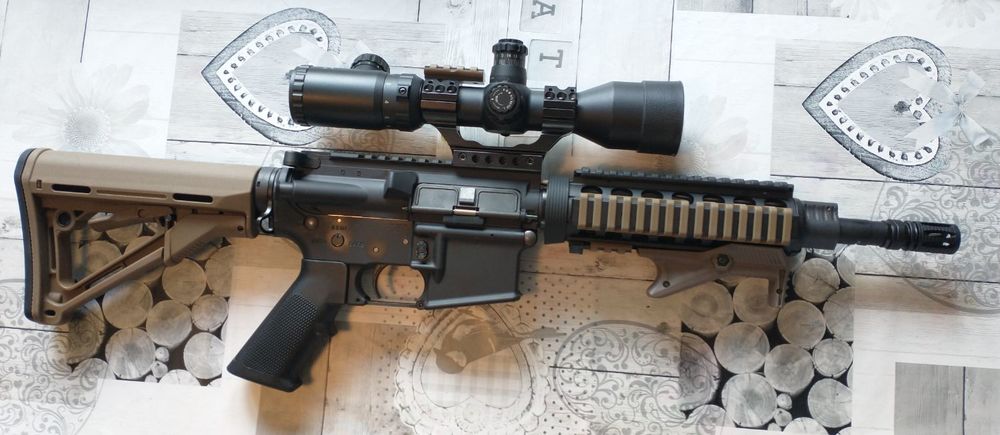

GothicGhost Posted May 7, 2021 Posted May 7, 2021 (edited) Bought a £5 low profile from Ali express and it fits perfectly ? Edited May 7, 2021 by GothicGhost
