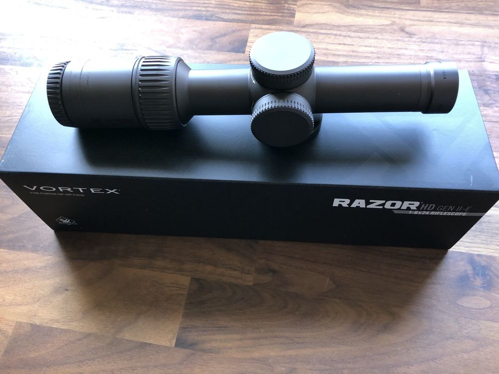

Popular Post LVOA-D Posted April 30, 2020 Popular Post Posted April 30, 2020 My new love has just arrived! Goes well with my Strike Industries build! Just awaiting the mount, Strike Industries buffer tube and takedown pins Tec-Spek, SSPKali, RobHedley and 2 others 2 3

Smiller Posted April 30, 2020 Posted April 30, 2020 3 hours ago, LVOA-D said: My new love has just arrived! Goes well with my Strike Industries build! Just awaiting the mount, Strike Industries buffer tube and takedown pins Money bags! That look the nuts!

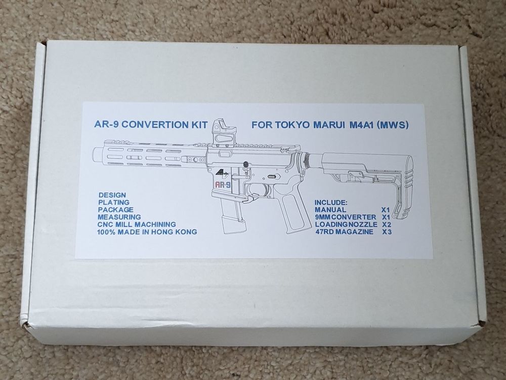

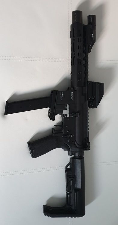

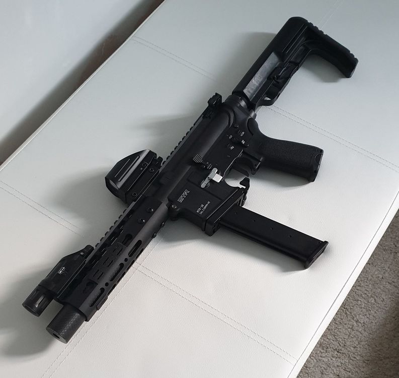

Hypnosis Posted April 30, 2020 Posted April 30, 2020 21 hours ago, adas1223 said: I have one. bare bones lower with grip and screw. also trigger guard. blemished, as it has a hairline crack near a pin which doesnt effect any function. Change of plan, I was being a doughnut but thanks for the reply mate. In other news my AR9 kit has finally turned up! Quick mock up before I start the modifications needed to get it running properly. Festerfly 1
