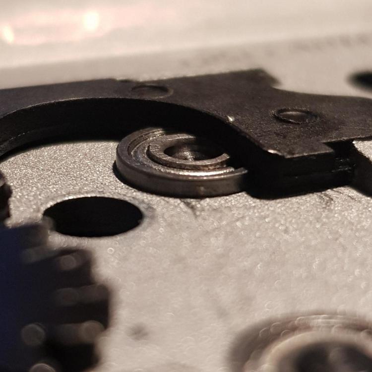

So, all rebuilt, which is great but I didn't need to purchase a complete gearbox spring set and gearbox clip, but I now have a different issue! I shimmed it but a couple of the bearings now protrude out of the gearbox. One of them is causing an issue that it sits underneath the safety selector switch and interferes with it. It protrudes by 1.12mm
20240419_061939.thumb.jpg.abeb8b14083c7156b8b05bc54153005c.jpg20240419_061948.thumb.jpg.736c5b4f0dcd4da3351a9603f7e4e76c.jpg
I've had a look but you don't seem to be able to get thinner bearings so what do you suggest? Admittedly, I haven't played with it properly and it might be fine but I'll have another look later on after some much needed sleep.

I'm thinking that is only possible if the bearing is physically reversed? It's a while since I changed any bearings in a gearbox, but from memory they are 'lipped' so can't push through the holes in the gearbox casing like that, unless you've inserted it from the wrong side of the shell (or the holes in the gearbox case are massively enlarged/rounded off from a previous seized bearing).
you're right, they are lipped so will only go in one way, it's an almost new rif so no massive wear and tear and they are a snug fit anyway. I've just seen that there are low profile bushings but, to my mind, that's a backwards step going from bearing to bushings? Unless I do just the one? I don' know.
Are all those bearings the same width? I use some 3x8x3 bearings and they do protrude and the one under the selector plate needed the plate relieving, but yours look wrong. One flush and one not is weird. i think you'll need to open it up again...

Take it apart and check to see if all the bearings you have are actually the same thickness.
That does look very wrong; the bearing should really not interfere that much with the selector plate.
Unless you are building a super high speed gun, good quality bushings are probably preferable to the cheap and nasty bearings usually used in airsoft guns.
Looks to me like you've fitted a 3mm wide bearing under the selector plate but a 2.5mm on the bevel gear.  Ideally you need 2.5mm bearings.  You can fit 3mm, in fact EZO (3x8x3) get their extra strength from being 0.5mm wide.  EZO do 2.5mm wide but the set I tested exploded.
Can you measure them?

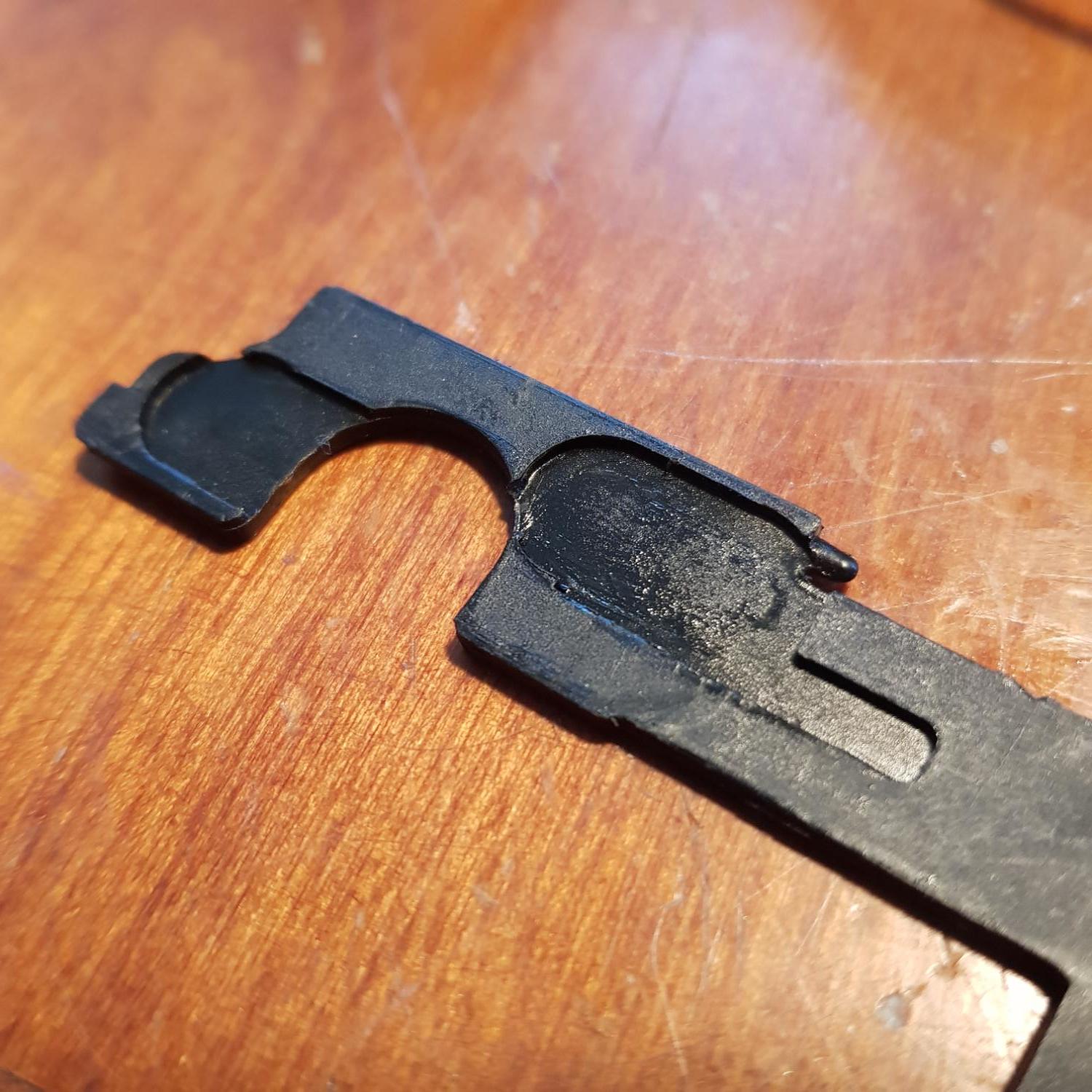

Ive just pulled the selector plate off and the underside is already recessed in the two areas that sit over the bearings.
I'm going to leave it for now and put it all back together properly over the weekend and see how it goes. ?
Weird
It looks to me it will still interfere because the groove on your selector plate doesn't look deeper than the 1.12 mm that you need, because the upper surface is supposed to be touching the gearbox surface when installed, so the grooves need to be deeper than your protruding bearing to go over it
But, you can just swap the bearings around, put the thicker one below and the thinner one above, problem solved
And just to check, you haven't inserted the bearings from the outside, right?

Nope, inserted the right way.
I did continue to play with it before i came to work and the selector does sit flat ish on the gearbox.
I've put it back in the reciever and, apart from forgetting to put the selector spring back in, it selects fine. I'll finish it off when i get up tomorrow and report back.
Right, I'm enjoying this home teching malarky but there is so much to learn. Like not all springs are equal. Like not equal in length!!! I suppose common sense should have told me that a longer spring, even though a lower rating, would make it more spicy than the standard m110 spring! Who knew that G&G use a shorter main spring? Well, I did actually when the seller told me! But did I realise the implications of that! No. Well I did but it was after I had bought the new spring and wanted to get it put together. Impatient? Me? Absofuckinglutely!
Anyway, got it all put together and it shoots lovely. The protruding bearing is not an issue at all.  My delivery of parts from @ak2m4 just came and although I am very happy with the service and cost, I didn't need it but will definitely being using him again. Thanks Pete.
