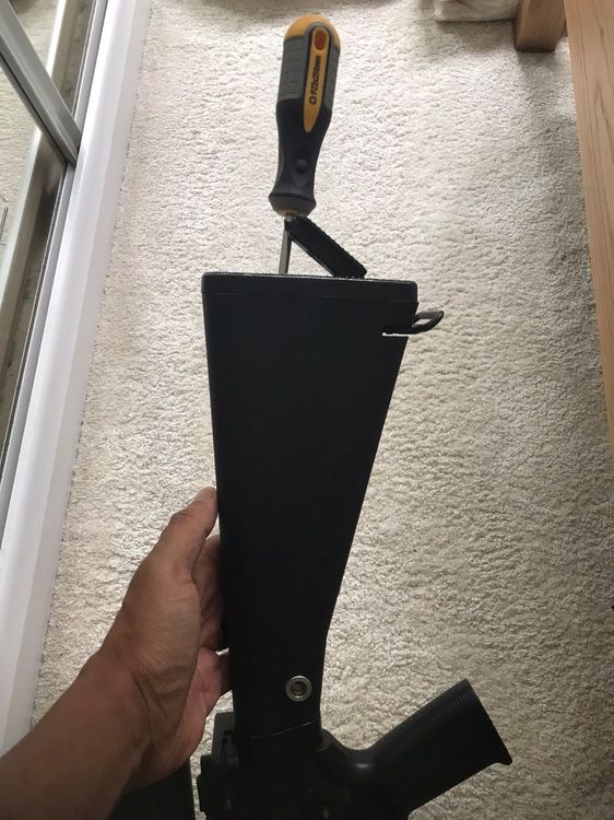

My main issue is I don't know how to get to the quick change spring on the full stock version. All the instructions I have show me how to do it for the retractable stock version, but not the full stock :(
I will want to make use of the quick change spring as I will want to test a variety of different springs and different BB weights to find the optimal setup. Might DMR it purely to get more consistency with heavier weight BBs, as I found that with the 0.84J stock spring it was very consistent with .3s, but not so much with .4s.

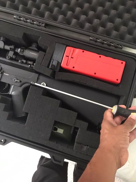

You will need a 250mm cross headed screw driver. Remove the rear stock plate.  Turn the gun downwards so you can see into the stock. There will be a black screw within the stock (worth replacing as it is a cheap soft metal - I have replaced mine with a steel screw), towards the rear of the receiver. Remove it and the stock will come off. After that you can undo the spring change block which contains a metal spring guide with bearings.
I can provide a video on this if needed.
Hope this helps.
Hope this helps.
I don't have a long enough screwdriver, though that's easily remedied. I had a feeling it would be something like this, so I'll give it a go at installing the sp100 I have. I think I also have an sp120 lying about somewhere so may try that too. Many thanks for letting me know, I'll have a look around and see if I have any screws that I could replace it with too, as I have a good collection. If not, I'll take the screw down to the local DIY shops and see if they can sort me out.
