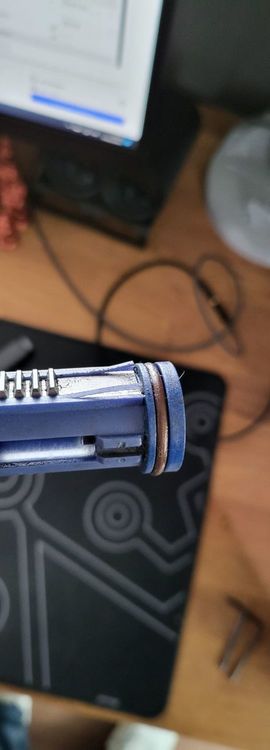

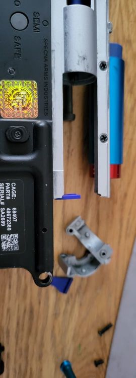

Yeah unfortunately, doesn't matter now though just took my gun in the garden to test the mag movement and this happened.
I think maybe the feeding issues have been a precursor to this.
About ready to give up
20220211_141605.thumb.jpg.0afd6d32cf2be781740016f75da9c960.jpg20220211_143053.thumb.jpg.bcd07db5ff05172a20a502347867f1f0.jpg
11 minutes ago, EDcase said:
Yeeeouch
Was it stock?
Seems like Specnas definitely aren't as good as they used to be
I had upgraded the gears to 13:1 and installed a perun v2 but that's all.
Didn't expect anything like this to happen

Orion gearbox is a bit wank. The One series is still good though

They can be a bit prone to it but you have massively increased the rate of fire. That'll do it.

Hmmm, that makes it more understandable.
Look for a pre-radiused gearbox

Orions are pre-radiused.  The problem is that they're made of Chinesium pot-metal.
Mine is currently surviving an M130-ish spring putting out 1.8J as a DMR but it was a very, very poor choice as a DMR base.  When, not if, it grenades, I'll be putting in a CYMA box from my cockroach backup-backup AEG.
Feeding issues are also rife with Specnas.  Luke at Negative has a solution that worked for him (see YouTube), I have one here in the tech sections that worked for me.
I couldn't recommend Specnas to anyone now.
