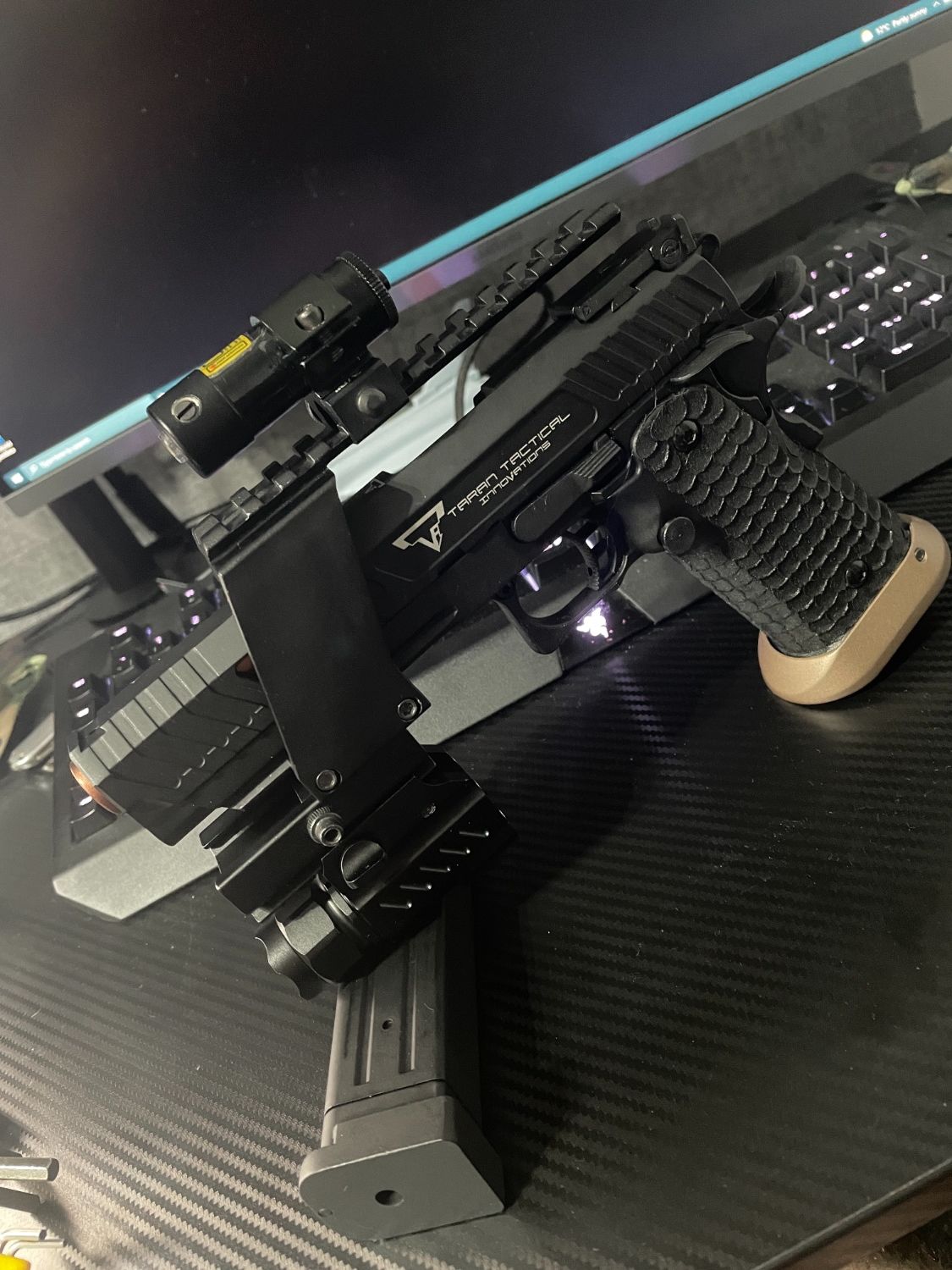

AdamH0808 Posted October 28, 2021 Author Posted October 28, 2021 7 minutes ago, DrAlexanderTobacco said: Not quite correct; sellers need a good reason to SELL you one. It's not an offense to possess one, or even purchase one. Either way - have fun! Post pics once you're done.
