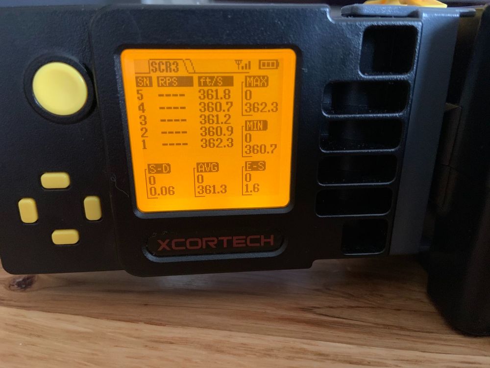

Ragingrental Posted July 3, 2021 Author Posted July 3, 2021 So I took a drill and my old barrel and sanded down the bucking lips. Worked great with a nice smooth finish. Then I cleaned the barrel and bucking and proceeded to install it all in the gun. Chronoing at around 360 fps with around 1 or 2 FPS deviation at most. So now I probably need to just short stroke a tooth to get the gun within legal limits and I'll most likely be set. Not trusting it enough to NOT bring my backup gun though. A definite success either way.
