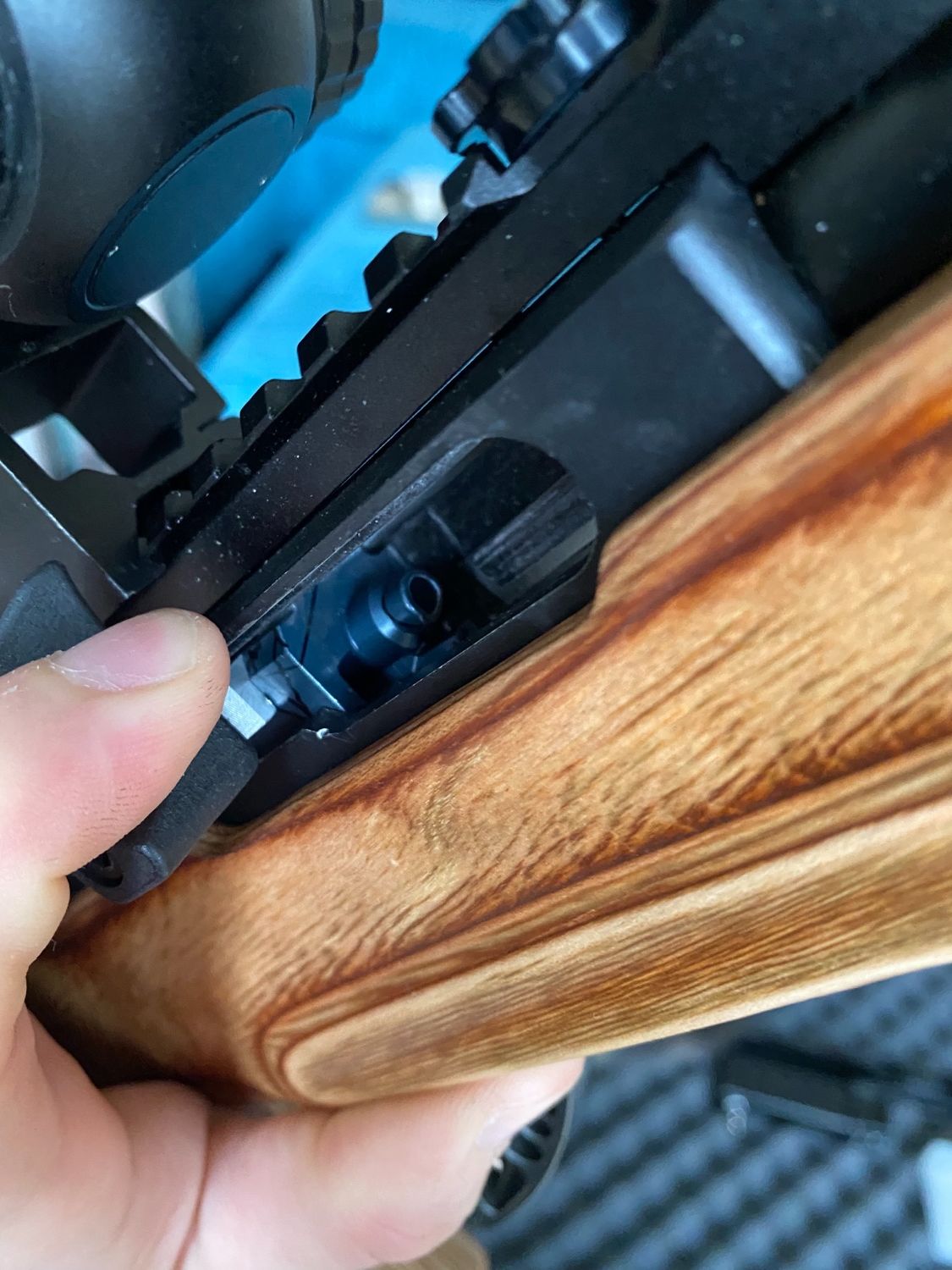

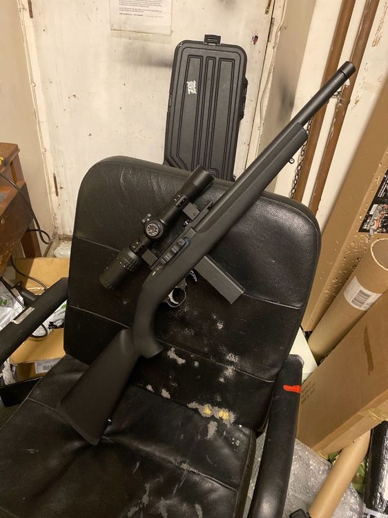

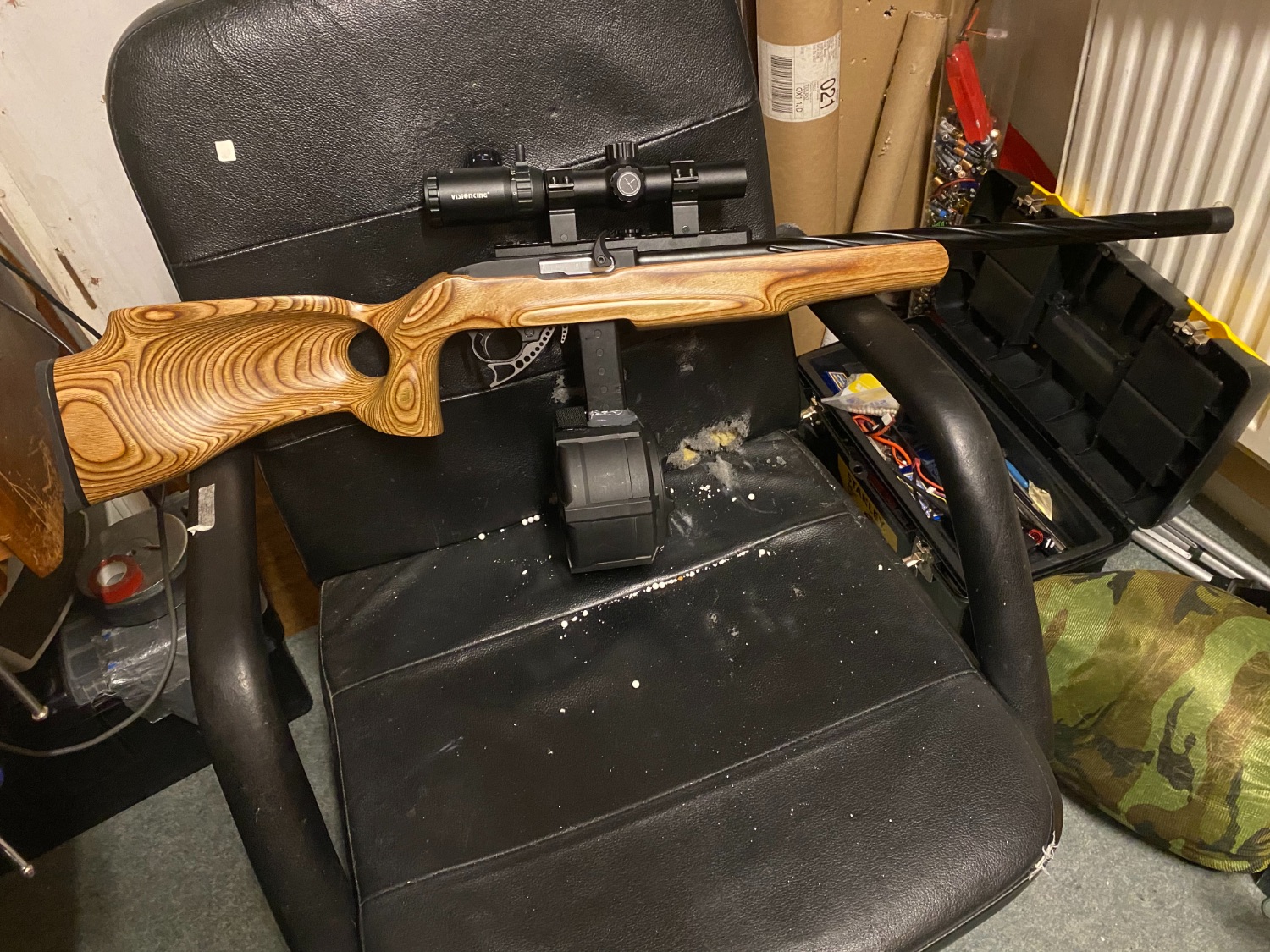

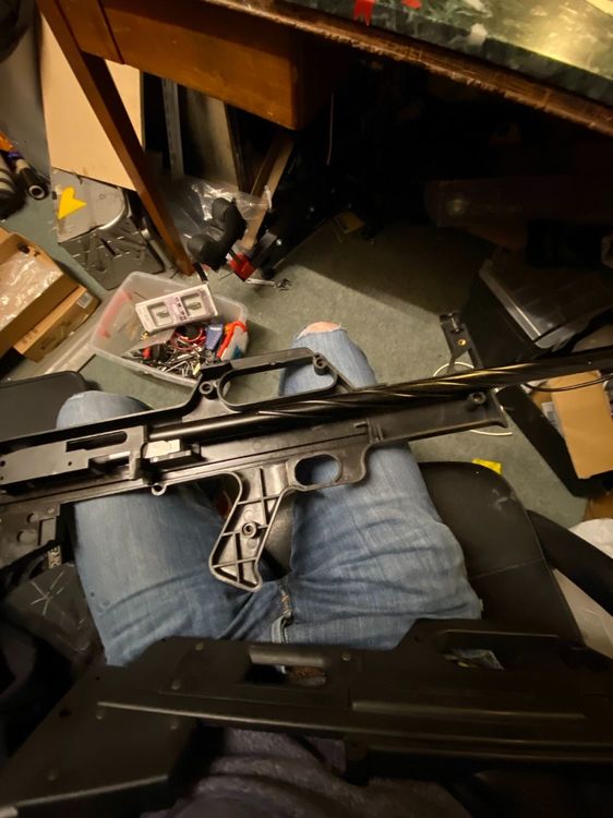

Firstly, getting a real 10/22 stock onto the KJ receiver? Very easy.
I had to remove c.1.5-2mm from either side of the outerbarrel mount, chamfer the bottom of the magwell and remove the rear tang from the receiver. On the Boyds stock, I had to widen the rebate for the trigger box by roughly 1mm either side.
Whilst it would have been quicker with a dremel, I wanted to be as precise as possible and went with a hand file. All in, it took around half an hour to get the receiver in the stock. It’s solid as a rock with no play!

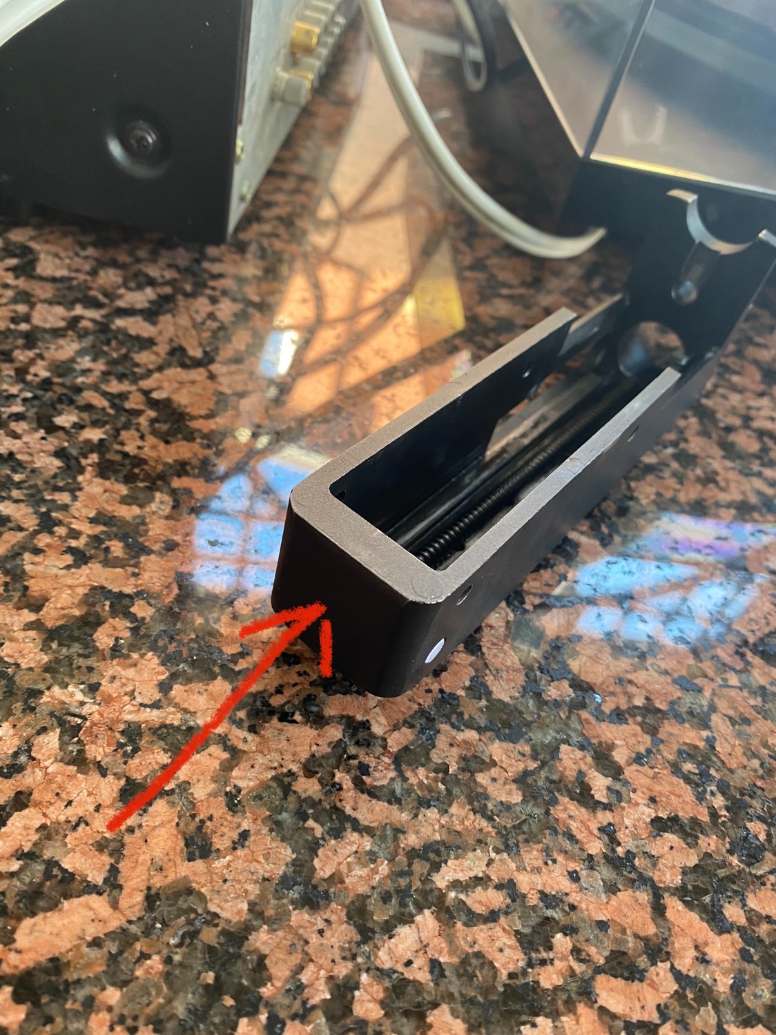

Finally, I couldn’t live with having two mags with rear HPA taps and one downwards facing so I forced my lazy arse to do a proper job on the gas mag!

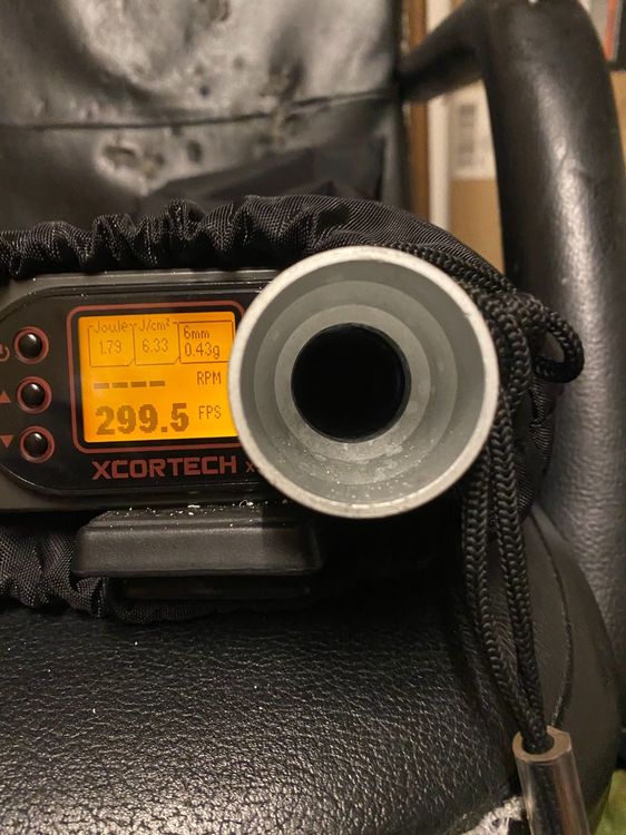

Barrel arrived! Testing it out, it seems like I’ve been very lucky. At my magic 95psi I’m achieving 375fps w/0.28 (don’t want to do lots of testing with 0.43, ouch!) with is pretty much bang on the money for my site limit of 450/0.2g.
Problem is, the consistency is not all that great. Whilst I was regularly getting 366-375, there was the odd reading in the 350’s. There’s a fair bit of play in the magazines, so I’m assuming that it’s the router to nozzle fit that’s causing the issue. I’m going to put a bit of electrical tape around the lip on the back of the mag and pad out the sides of the magwell.

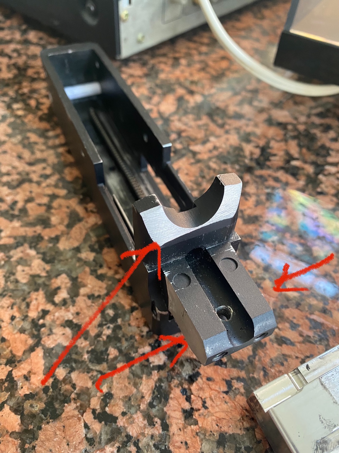

I worked out what was causing the odd really low output
The knocker lock was quite worn and wasn’t always fully retracting the knocker. 1 in 10 shots, it was partially retracting and likely reduced the force with which it hit the outlet valve. A few strokes with one of the wife’s old Emery boards and it’s back to doing what it’s meant to.
I’m actually surprised at how little material I had to remove to solve the issue

Managed to get her down to a +-5fps deviation now. Going to nip into work tomorrow to pick up my valve tool - just want to make sure the inconsistencies aren’t down to the KJ outlet valves

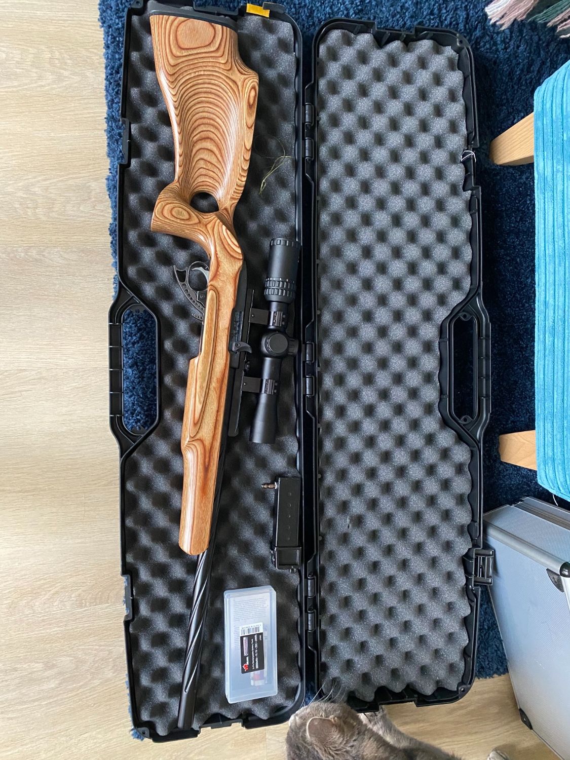

Re: Photo, the Cat destroyed a cardboard box. I’ve got wood floors going down on Tuesday. I’m not just a total slob!
cat's expression says it all.....
Did a little bit more testing in the garage. I think I’ve worked out the final piece of the puzzle!
The knocker lock was causing big round to round deviations, I’ve discovered today my homemade hop wheel tensioner was slipping thanks to the recoil and the power output was gradually creeping up as the hop lessened. I’ve filed the piece a bit sharper now and the hop wheel is staying put.
2 long mags, 374-378 with 0.28’s @95psi. I’ll have to wait to get it to Finmere to set the hop correctly for 0.43’s and then tune my psi accordingly for the site limit

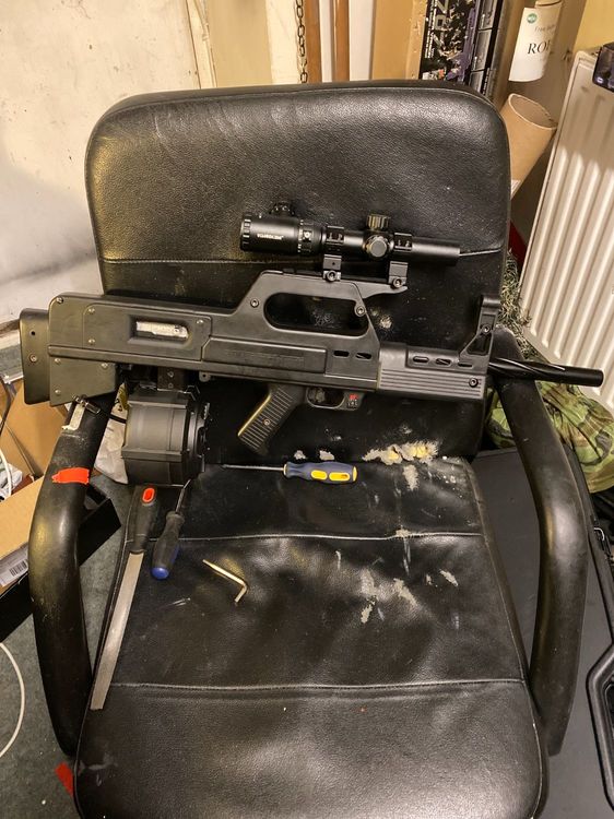

Had my first game with the KC02 on Sunday, learned a few things about the build.
1.) My hop wheel tensioner was rubbish. I’ve made a new one from a biro nib and it’s giving a far more positive click for each adjustment.
2.) The KJ plastic rail is rubbish and at one point I had to push my scope back to zero! I’ve got a metal RA tech one arriving soon but I had to buy an entire new outer barrel to get it! £140 oof
3.) When the hop wheel was in the right position, this thing sends BB’s a long way.
4.) 90rds is not enough to get through a 2 hour game. I need to find a KC02>MP5 HPA adaptor

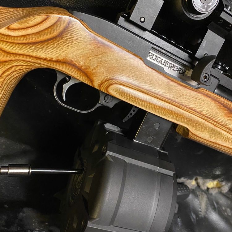

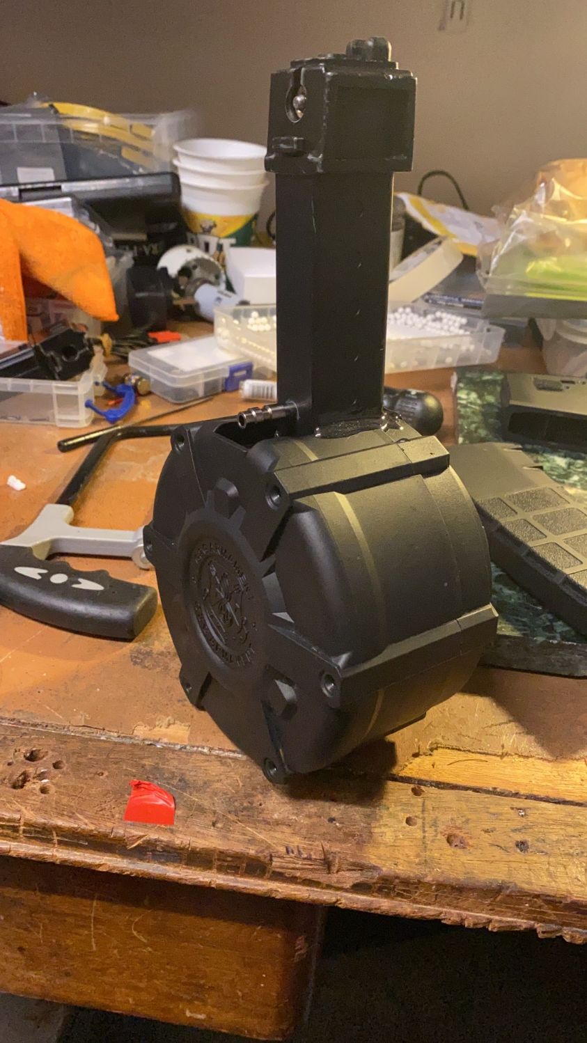

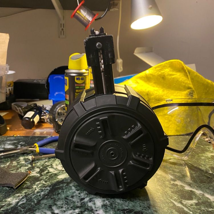

Bored of waiting for a TanukiWorks HPA adaptor restock and unwilling to pay for extra magazines I got creative.
Turns out the width of the standard KC02 mags and the collar of the top of the G&G M4 drums is almost identical. With not much more than fitting the Bowden spring into the KC02 mag and epoxying the mag into the drum - the KC02 HPA drum mag was born!
I ran a test of a few hundred rounds and it feeds perfectly and is as consistent as one would expect with HPA. I was worried about the sheer weight of the thing in the mag well but it seems to be a non-issue

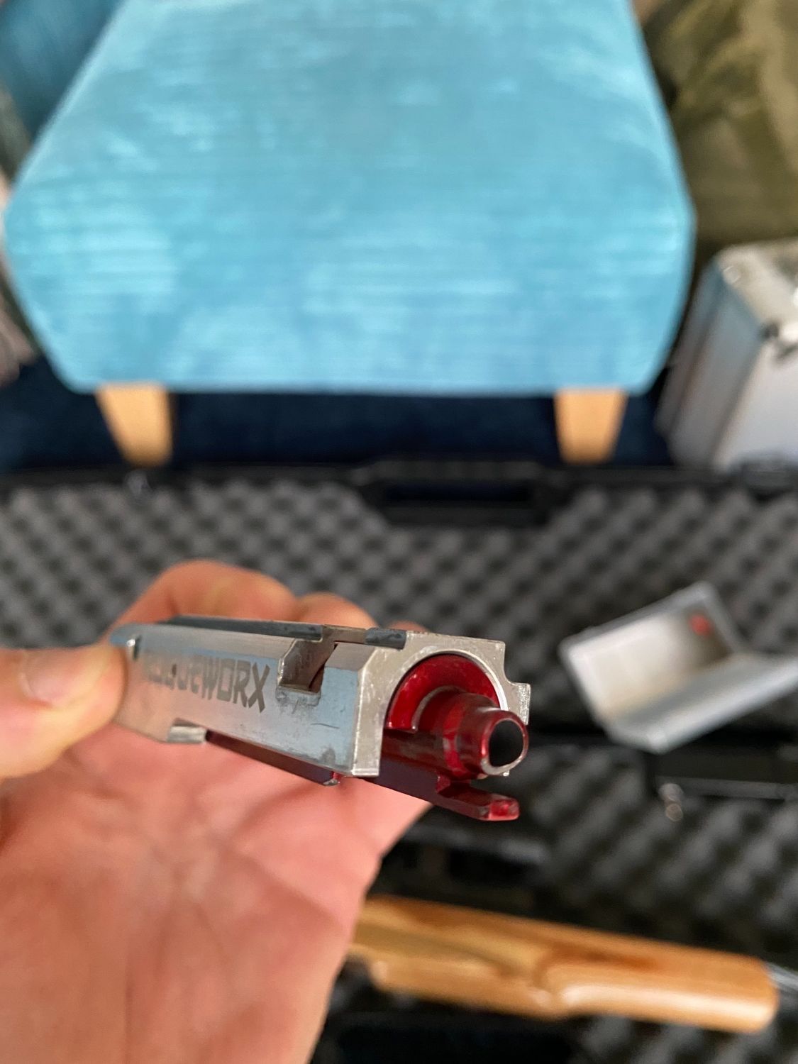

I picked up something that has made my KC02 either a semi auto DMR at 1.8J or a single action sniper at 2.32J.
Its called the Rogueworx SSB, and as you can see from the pictures, it differs significantly from the standard reciprocating bolt by being one solid piece. The loading nozzle is integrated into the bolt and there are no moving parts. The output power of the SSB is adjusted by a grub screw that obstructs the hole on the front of the nozzle (Apparently, fully open with a decent length barrel and C02 it’ll give about 5J). Once adjusted, I’m dialled in to be comfortably under my site limit WITH 0.43’s. I didn’t realise quite how much this joule creeps until I stopped being a cheapskate and stopped chronoing with 0.28/0.36’s and started using my actual ammo.
Consistency is +-1fps with my HPA rig.
Changing the bolts takes all of 2 minutes; all you need to do is remove the action from your chosen stock, separate the trigger box from the upper, pull back the charging handle and remove the bolt.
Did I mention it’s basically silent? The action of the Rogueworx Judgement hammer is significantly quieter than the incumbent stealth king MK23. Racking the charging handle is as loud as you want to make it

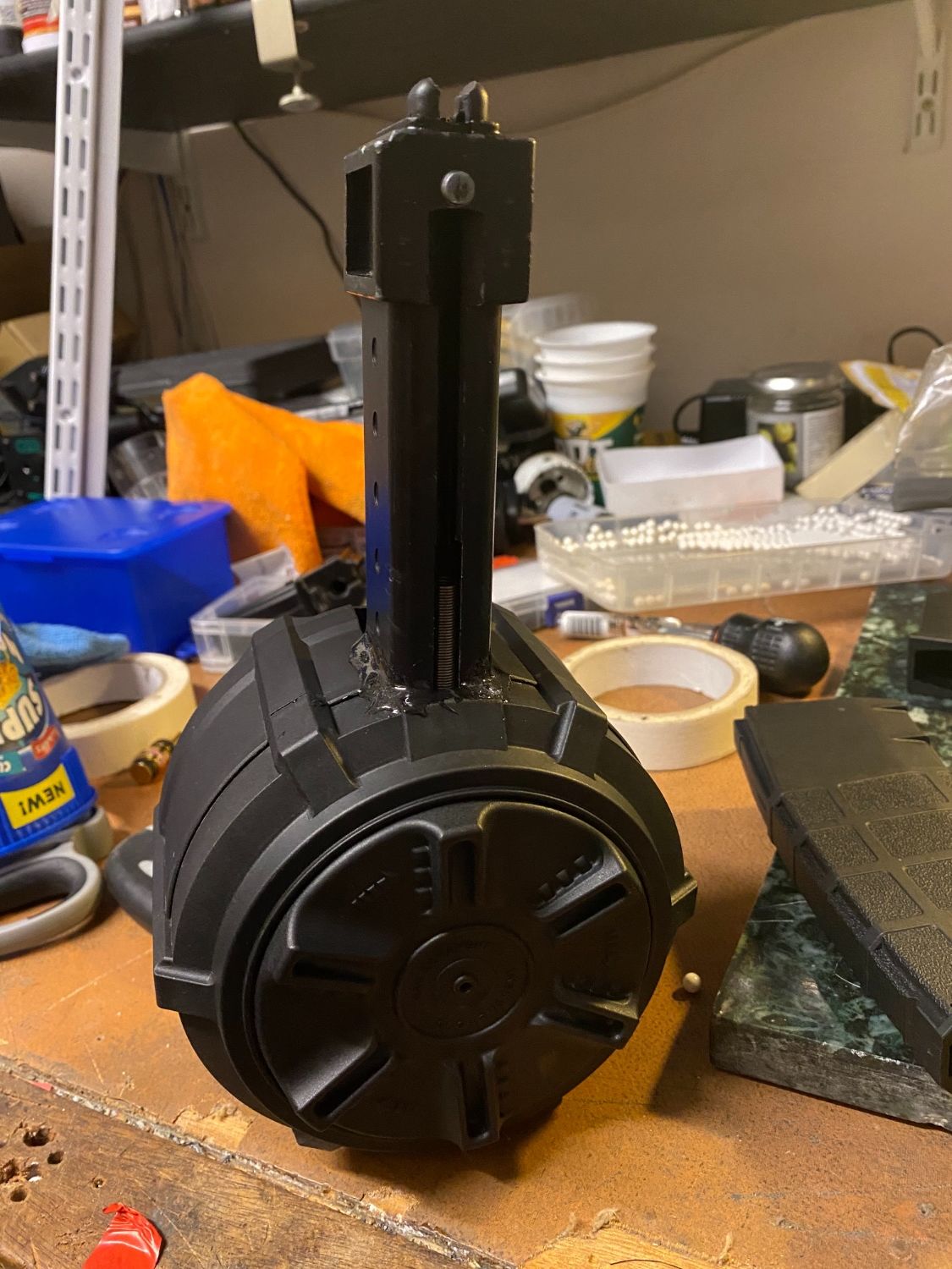

The harshest criticism can be the most useful! After it was pointed out that my gun and my drum mag were not technically in the same postcode I decided to go all McGuyver.
Some hack sawing and sealing later and it doesn’t swing around like a 2500rd pendulum under my gun anymore
Its beautiful, great build.
I appreciate but dont like the drum mag though but thats just my opinion.
Honestly, I hate drum mags. There’s an HPA adaptor for the KC02 called a Tanuki that I’ve been trying to get hold of for months, the V4 will hopefully be out soon and it’ll let me use my MP5 midcaps with this build
I get it, I usually use hi caps or drum mags where possible as I cant be arsed to carry loads of mags, it just looks wrong in a dmr, I use smgs so kinda get away with it.
Appreciate the effort and engineering though, decent thread.
And that stock... beautiful

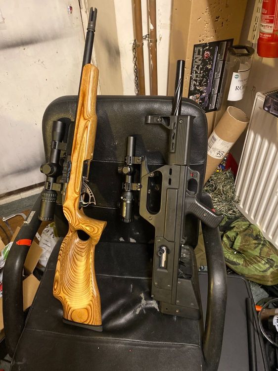

It’s got a sibling now thanks to @Cromulon1994
The Muzzelite is bang on 1.8j@100psi and semi auto locked, the Boyd has the Bolt action bolt in and is tuned to 2.32j@100psi
Had to get creative with the Muzzelite, it’s a real stock for a normal 10/22, and the trigger reset distance is quite different. I took a couple of mm of material off the front of the trigger to give it a smidge more travel and now the sear can reset each time.
Looking forwards to hearing the whispers in the queue for chrono trying to figure out what this is!

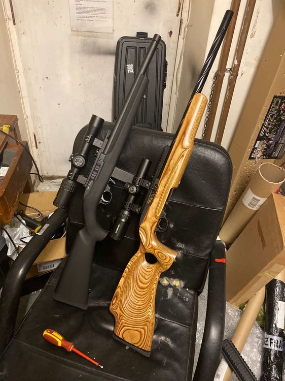

The looming deadline for the Rogueworx underlever kit has made me do something financially irresponsible. Underlever kit now on order, The Muzzelite stock is for now in my spares box and this Hogue Overmold has arrived ready for my underlever
I’m going to be keeping an eye on the classifieds for the next boneyard KC02 so I’ve got a receiver and trigger box to stick in the Muzzelite. It’s too unique and too ugly to not take to the field. Got a mate working on a solution to make the trigger less, well, bullpuppy too

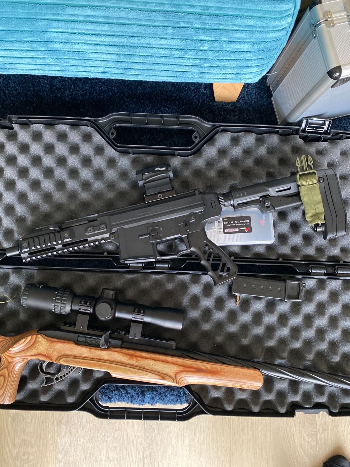

I did a thing, a financially irresponsible thing.
a mate is turning me a custom tapered barrel and the DMR action is going to be housed in this…
