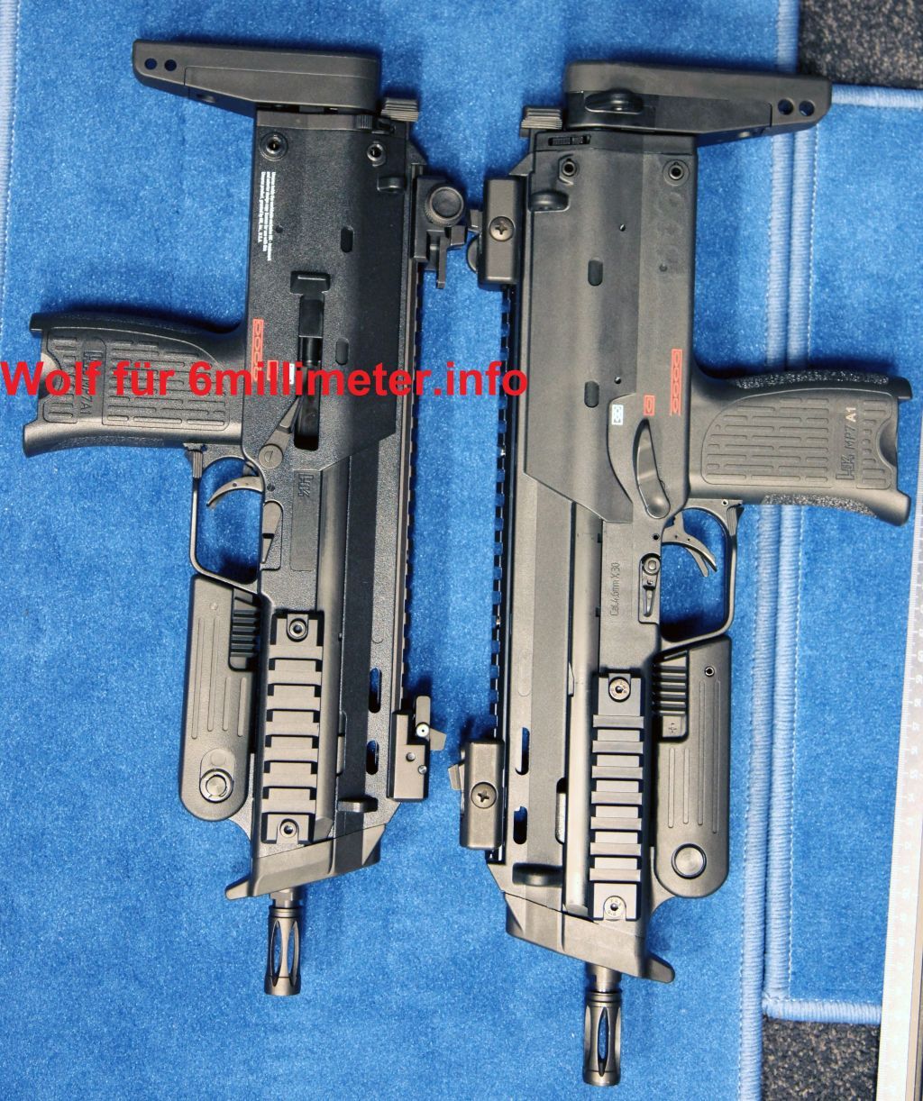

I have the Tm and it’s my fave gun. Brings a smile to my face each time. I don’t care it’s not 1:1 and once your holding it it’s not an issue, doesn’t feel small to me.
I couldn’t recommend it enough
This isn’t the first thread on this, and I’ll try not to repeat everything I already said.
The Marui is clearly a better shooter out of the box and has correct trademarks, but it is more expensive, has less parts support and is too small (this bothers some people more than others).
The WE is cheaper and the correct size, there is an option to add trades at extra cost. It has decent aftermarket support. However it needs some work to shoot as well as the Marui. As a minimum the hop arm needs some filing and a new hop rubber is a good idea.
Personally I have the WE and have been very happy with it once I did a few modifications.
If you want 1:1 get the WE Small Rice.  Ultimately the TM is a better gun so check one out and have a play before you write it off.  You might just be OK with it.

People don't like it's incorrect scale.  It does seem like much more of a toy when compared to a WE/VFC.

Its hardly THAT much smaller and at least you wont spend most of your time trying to get it to work
