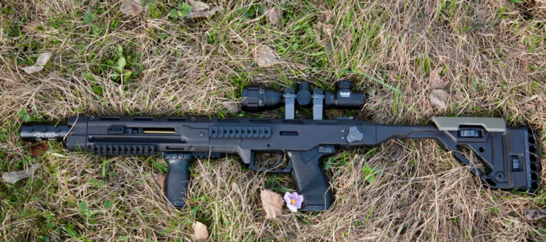

I have ran my mk as a DMP for a long time. Similar length barrel running 400fps under 2j iirc. It shoots a little further but the main benefit is hitting harder at range. I often carry in combination with pistols only but sometimes with a small aeg. It's light and manureable only disadvantages is less stability . Some places/scenario's are not ok with it but I ask before. I think it's not an issue as long as people respect the rules and know what they have. From a Marshall pov a mk23 DMP and any gun thats been bought up to dmr are just as hard to differentiate. The onus as it's always been lay heavily on the players.IMG_20201026_122945_873.jpg.606c2d046722fda8830dc02093106894.jpg
I like the idea of the carbine kits myself as suddenly you have a modular platform (well almost unless you have a spare barrel and hop unit which you can swap between standard and mental length).  The 3d printer has allowed people to become creative and suddenly everyone is a prop designer in their own bedroom. Anyway, back to the point in hand.... if the alleged RIF is shooting over 350fps then it should be classed as a DMR / DMP and should be subject to a Airsoft sites  DMR / DMP  policy/rules.. of course it can't look like a pistol and this is where the crux of the argument is.

This is my answer to the argument ?IMG_7380.thumb.JPG.854096c715b930f6f47739f900a4981c.JPG
