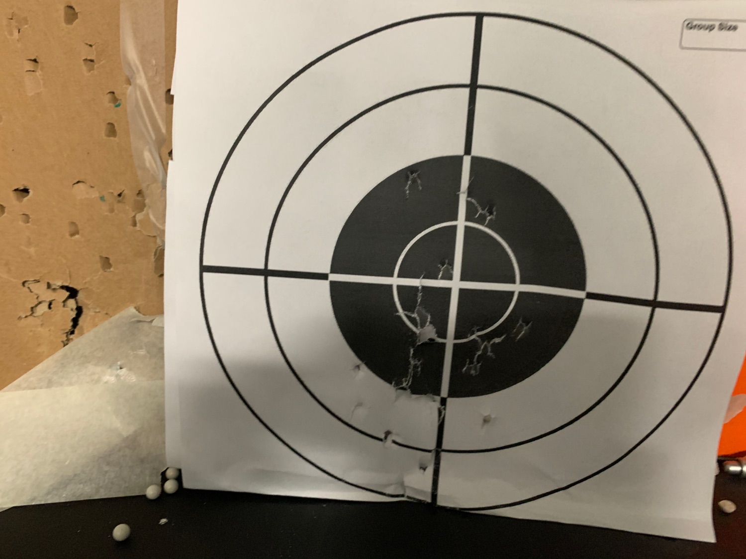

am quite new in airsoft, was wondering about one question.
As my first replica bought FNX-45 from Cybergun, but it seems there is a strange thing.
Below you will find to images of targets A4 sheets, both times it was full mag- about 20 rounds, with min or max hop up.
In both cases it was with green gas of 150 psi, 0.25 g BBs and indoor, with about 5-6 m from the target.
So i do not really understand why am quite of the target but with very narrow distribution of few cm, so does not seems like coincidence.
Was wondering how i could offset it ?
Thanks in advance
There is something wrong with the hop unit.  The difference between min and max should be MUCH more.
You'll have to take it apart to see.  Its not very difficult and good to know.  Fix could be as simple as re-seating things or hop rubber may need replacing which is cheap.
Look on YT for vids on FNX 45 disassembly etc
This is the difference between accuracy and precision
Normally we use the terms interchangably but this perfectly demonstrates it.
Precision (which is what a lot of times is meant when talking about "accuracy" in airsoft) is the size of your groupings.
Accuracy is how close that grouping is to the aim point in this case the bullseye.
This is why gun sights need to be "zeroed" so that for a particular person the shot lands where they think its going to land. Kudos on actually noticing it so quickly, as this problem is often the cause of a lot of "take yer ****ing hits" style arguments when folk dont realise the gun doesnt just magically shoot on target out of the box.
Most rifle iron sights, scopes and red dots have this functionality built in, however often pistols dont.
At best you might be able to tap the front sight left/right (some pistols theyre fixed even if they should be movable) to adjust there.
Vertical dispersion on a real handgun is kind of "fuck it, close enough" but in airsoft you can use the hop unit, which is what you were trying to do. As @EDcase says normally you'd expect motion but tbh at 5-6m its probably not enough time for the hop to really be taking effect (normally it only kicks in further downrange)
However the simplest fix which works on any gun is just to apply "kentucky windage", ie just aim up and right a bit to account for the shots going low left.
The groupings look OK.
It does seem to be shooting low.
But the hop definitely isn't working properly.

Nothing wrong with that gun.
Short range far too little to show any affect from hop up,  needs 20m plus to even start to see differences, unless you almost block the path by over hoping
Grouping normal, the slight flyers will be down to BB inconsistency  (bet their Blasters!)
Low left is due to jerking the trigger and  perfectly normal  for  most people. Can be trained out

Sharing this as hopefully help someone with same issue - below you will find result of two shootings with same gun, same gas but different BBs. Top picture 0.25 BB Bulets, buttom is 0.20 BB from Swiss arms. Distance is about 5 m for both.
so that is the reason :)
i don’t think it is different weight (as it is 5 m to targets and using 125 psi gas), but surface - bb bullets surface feels like “oiled” while Swiss arms a bit more rough .
with Swiss Arms very consistent shooting

I take it you regassed mag between firings
I wonder if there is a correlation between the polished bbs and the “rougher” bbs in accuracy
Keeping in mind Golf balls are dimpled to increase to effect of spin and purchase in the air etc (grip so to say)

i did do the math on the drag crisis for an airsoft bb and no dice.
i'd hoped that the transition point would line up somewhere between 280 and 320 fps which might put some actual physics behind marui's fairy dust but alas twas not to be.
what's going on is more likely grip levels in the hop, consistency of diameter shot-shot, consistency of mass shot-shot, not having imbalanced centre of mass etc that are the hallmarks of a higher quality ammo.

No, one same charge - one gas charge is enough for about 3 refill of BBs
I think to be a good test you should do both tests with freshly gassed mags. ?

Have the same feeling
nevertheless- learned what was obvious I guess :) - don’t buy unknown producer ammo. Those bb bullets were not really cheap by the way- similar to Swiss arms

Thats probably cos Blasters are very inconsistant with loads of random voids inside them. Try some Geoffs, valkyries, or G&G and I bet you see improvement
