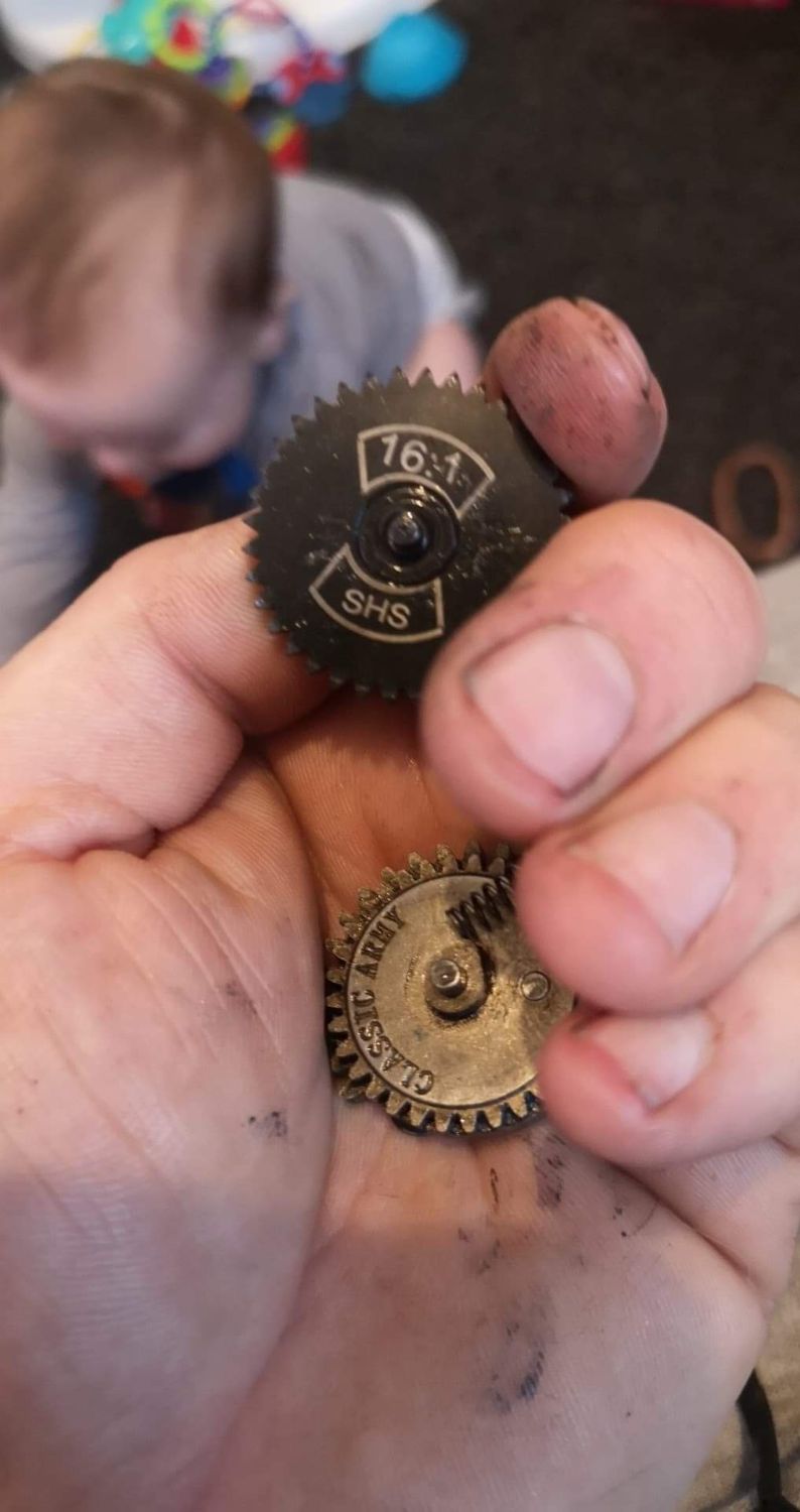

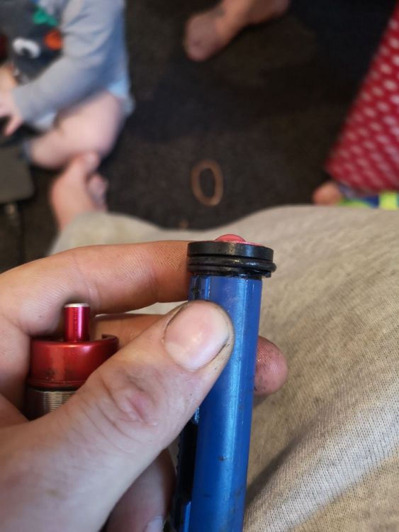

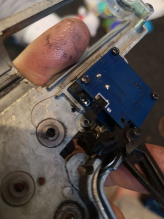

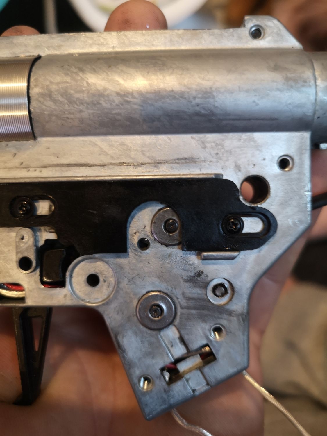

Welshd1k Posted December 1, 2020 Author Posted December 1, 2020 Just a update PayPal refunded me 60 and I kept the gun stripped it down the internals where a joke Stick gears mixed with Shs gears A washer glued under the trigger to make it a shirt stroke Piston had 0 air seal in the cinder moving it fast or slow and had a chunk missing out of the top Bushes battered Now back together with a cyma v2 box with the m160 motor and firing sweet VID_20201201_150419.mp4 VID_20201201_150322.mp4

Supporters Adolf Hamster Posted December 1, 2020 Supporters Posted December 1, 2020 There is a reason to mis-match gears, but i have a distinct feeling this guy wasnt going through several different combinations to acheive minimal backlash and smooth meshing. Also a washer? Whats wrong with tapping the shell for a grub screw? That piston head i suspect is the culprit for the air seal, looks like yhe one i had where the inner surface was rough and it wouldnt form a seal with the o-ring.
Supporters Sitting Duck Posted December 2, 2020 Supporters Posted December 2, 2020 Is that an Ares gearbox with the EFCS ECU bollox ??? I thought the box was an APS or did the bloke fit an Ares magnetic thingy in there or is the box an ares v2 - I dunno, a right pile of confusion going on as to wtf it all is if so the sector has a magnet to detect its position & stuff so you had to (of a sort), keep the Ares sector which the 18:1 & 16:1 sectors are same thus the bloke plopped in a SHS 16:1 spur and "likely" kept the CA sector with the magnet in one of the holes The washer behind piston was to likely correct AoE a bit more as the silent/mushroom piston head & matching cyclinder (if used) would make it difficult to adjust with sorbo/normal rubber pad the silent head has a little tiny squish to it anyway - so adds so impact resistance so bloke probably thought - fuck it just add a slight spacer between piston & PH to correct AoE - though tbh them piston heads are quite chunky on their own and I found they seem to PARTIALLY correct AoE anyway I don't use them as I feel the vents in PH don't allow the o-ring to push out like other PH's but others use them, they don't muffle quite that much, they offer a tiny bit of impact cushion (but not a massive amount) Looks to be a SHS piston & I do not like those pistons... way too little actual rails for my liking - I like nigh on full solid rails (especially in "windowed" boxes, just my own personal OCD I guess) but too little actual rail on those SHS pistons for my liking even the swiss cheesed pistons... I only like to use them is say a G&G non-windowed box where box has uninterupted rails so to speak but that SHS piston... nah not got one, nor do I intend to get one for lack of rails (soz but absolutely shit way to lighten a piston imho) Another thing with SHS pistons... They BIND - quite often in numerous boxes Except for G&G's, most boxes will need a little sanding to stop SHS pistons binding especially at full retraction on the last couple of teeth I found So just something to be aware of SHS pistons bind in APS... As I said, some money had been spent on this gun at some point but think it was assembled by an inexperienced tech or a few bad techs have had a go at it A good result you getting refunded some money to help fix the issues some of things I can understand as to perhaps this/that was performed but above all else palming off a botched gun onto somebody I can not get my head around good result all round, should finally get the gun you wanted/deserved at last
