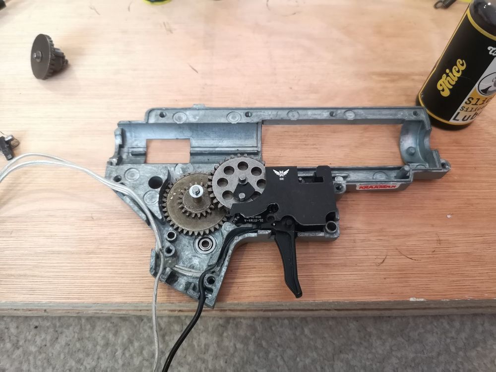

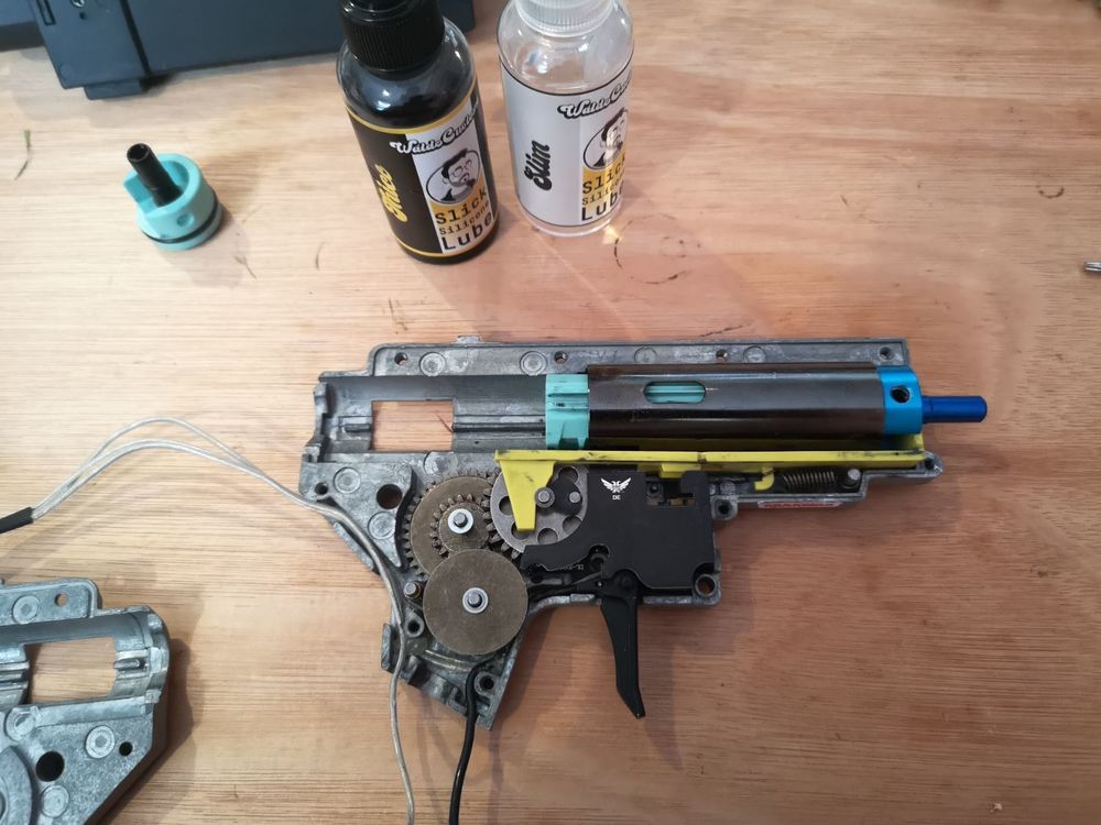

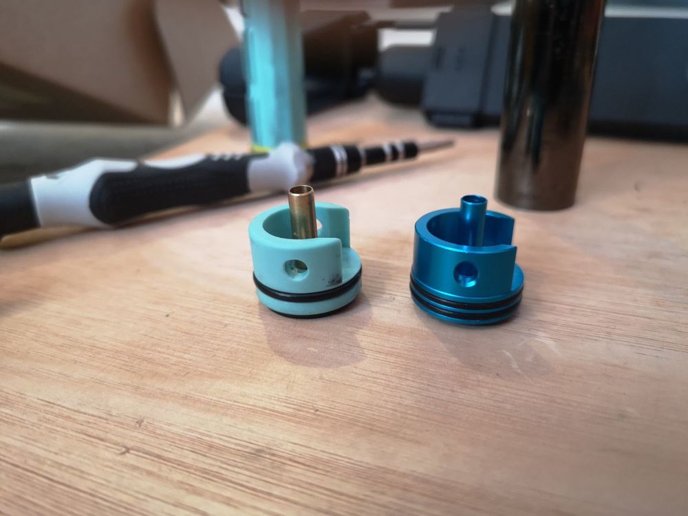

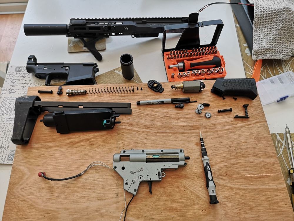

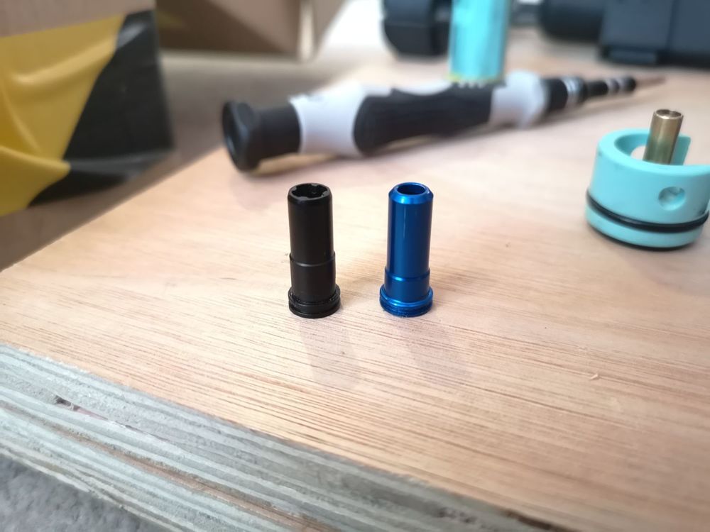

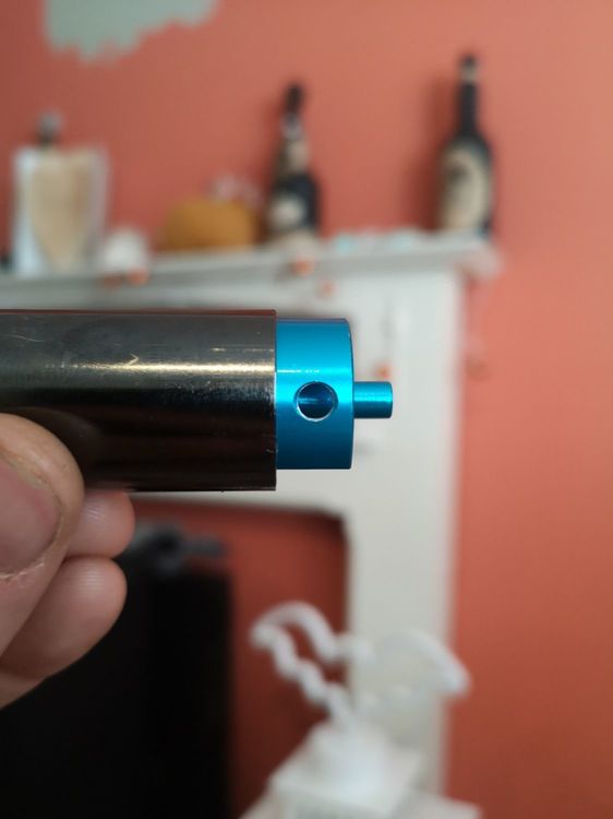

Stevobeavo Posted October 23, 2022 Posted October 23, 2022 had a morning session last sunday and noticed at chrono my 904G was down to 0.95J from a constant 1.07J in all previous games (on stock spring still) and also after about 2 years of owning my 904G I thought it's best that I actually do some maintenance on the gun. Stripped the gun down Although there was barely any grease left in the gearbox there wasn't much wear on the gears Checking the air seal, without the nozzle on it as pretty good but with the nozzle on it was actually pretty poor, nozzle has no o ring. So I've found my old specna arms cylinder head and nozzle with o-ring swapped them over and now I have a really good seal. Had to drill out the cylinder head holes by 0.5mm for it to fit on the lugs in the box. All lubed up with Waldo custom grease and reassembled. Ill be chronoing it in a few days to see what's it's shooting. But im certain it will be more due to the new nozzle sealing properly. John_W and Rogerborg 1 1
ak2m4 Posted October 24, 2022 Posted October 24, 2022 13 hours ago, Stevobeavo said: All lubed up with Waldo custom grease and reassembled. Ill be chronoing it in a few days to see what's it's shooting. But im certain it will be more due to the new nozzle sealing properly. Be interesting to see what you get, I've done several nozzle tests recently, with o-rings against those without, good seal nozzle at retracted and extended point vs one with no seal and the fps was always the same. A lot of other variables of course and no 2 setups are ever the same. Let us know how you get on. Rogerborg 1
Fatboy40 Posted October 24, 2022 Posted October 24, 2022 @Stevobeavo About 6 months or so into owning my DE M904E I just wanted to start tinkering with it, nothing big at that point (it's radically different from stock now) but at least fully disassembling it and rebuilding it. I got an extra 5 to 8 FPS on 0.20g just from carefully cleaning an re-greasing it with Super Lube. The biggest gains I got though were from... # Replacing the Spring: The three DE M900's I have were all UK spec for power from the retailer, but the spring in each one was totally different from the others in strength, length and two were progressive and one was linear. Using well made springs gave substantial power gains, with no loss over time, and consistency when swapping them around. # Maxx Model M4A-PRO and Nozzle: In my DMR, a DE M908A at 420 FPS on 0.20g, I recently installed a Maxx Model M4A-PRO and their 21.25mm Nozzle, and had a big FPS gain (I noted what it was but can't find it, something like 10 to 14 FPS). Was it the hop unit, was it the nozzle, both together?
Stevobeavo Posted October 24, 2022 Posted October 24, 2022 6 hours ago, ak2m4 said: Be interesting to see what you get, I've done several nozzle tests recently, with o-rings against those without, good seal nozzle at retracted and extended point vs one with no seal and the fps was always the same. A lot of other variables of course and no 2 setups are ever the same. Let us know how you get on. That's interesting, everywhere you read says to replace with one with a o-ring. I'm only just getting into teching, that's why I got one of your ZCI gearboxes last month to play with in my dead specna arms. Once I test I'll put the readings up for you. 2 hours ago, Fatboy40 said: @StevobeavoReplacing the Spring: The three DE M900's I have were all UK spec for power from the retailer, but the spring in each one was totally different from the others in strength, length and two were progressive and one was linear. Using well made springs gave substantial power gains, with no loss over time, and consistency when swapping them around. # Maxx Model M4A-PRO and Nozzle: In my DMR, a DE M908A at 420 FPS on 0.20g, I recently installed a Maxx Model M4A-PRO and their 21.25mm Nozzle, and had a big FPS gain (I noted what it was but can't find it, something like 10 to 14 FPS). Was it the hop unit, was it the nozzle, both together? I definitely need to get a few decent springs for my DE guns, just never got round to it yet. How did you turn yours into a DMR, cover the full auto optical sensor or stop the selector plate moving that far?
Fatboy40 Posted October 24, 2022 Posted October 24, 2022 1 hour ago, Stevobeavo said: How did you turn yours into a DMR, cover the full auto optical sensor or stop the selector plate moving that far? Stopped the selector plate moving that far with a nut and bolt through the receiver (also no site has ever questioned how I'm locked to semi only, just chrono'd me at the weight I'm using and trusted me (I shoot 0.40g and have never cheated chrono in any way)). 7 hours ago, ak2m4 said: Be interesting to see what you get, I've done several nozzle tests recently, with o-rings against those without, good seal nozzle at retracted and extended point vs one with no seal and the fps was always the same. A lot of other variables of course and no 2 setups are ever the same. Let us know how you get on. @ak2m4 In the past I did try an o-ring nozzle in one of my DE M900's, with absolutely no difference at all (I think it was one of your XT nozzles). However the Maxx Model M4A-PRO + their own 21.25 nozzle with o-ring did give me extra FPS, so I'm wondering if the nozzle is just mating up perfectly with the bucking in the hop unit and improving the air seal? Rogerborg 1
Stevobeavo Posted October 29, 2022 Posted October 29, 2022 Finally got round to testing the gun out. The guns now shooting 1.09J so a slight increase over what it was new and I've gained 0.14J from my last game day, so I'm happy with that. RostokMcSpoons and Rogerborg 2

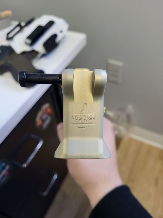

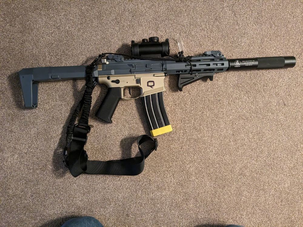

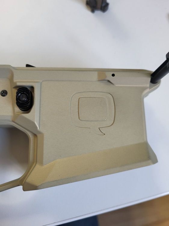

Egon_247 Posted November 16, 2022 Posted November 16, 2022 So.... I may have been bitten by the honey badger... I love mine so much that I've downloaded the handbook from Q in the US to get the colours right when I paint/cerakote it... ? Then, being the daft bugger I am, I emailed Q to ask if u could copy the Q and the "live free or die" logos. Kevin from Q (the owner!) emailed me back with hi res pictures of it and told me if I was ever in the neighbourhood to come over and have a blast with the real 300 blackout... What a gent!! RostokMcSpoons, John_W, ak2m4 and 1 other 2 2
RostokMcSpoons Posted November 16, 2022 Posted November 16, 2022 1 hour ago, Egon_247 said: Kevin from Q (the owner!) emailed me back with hi res pictures of it and told me if I was ever in the neighbourhood to come over and have a blast with the real 300 blackout... What a gent!! Admit it, you've started looking up the price of airline tickets, haven't you? (I would!) Egon_247 1
