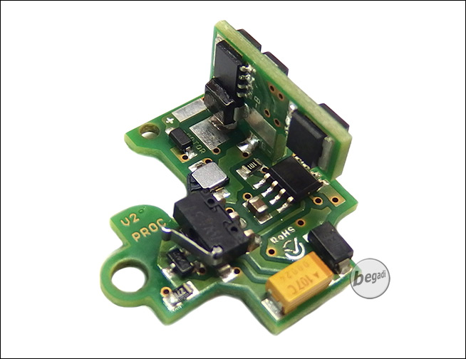

Iceni Posted October 31, 2019 Posted October 31, 2019 Found an image of the unit. Looks to be a dual fet on the upright board with a voltage clamp circuit. Back board just shows the capacitor and a nice beefy microswitch. With what looks to be a little more voltage regulation at the bottom. The capacitor is probably to ensure enough voltage is passed to the fet for a feathered trigger pull just to keep the switch effectively open for the correct amount of time to start the cycle. I assume there are 2 more microswitches on the board, one on the back for selector sensing, and one to sense the cycle. This would normally be done on the COL and the switch might be on the back of the mainboard, or it might sense from the tappet plate having a switch at the top of the upright board. There looks to be no programming at all. And the dual fet layout is very similar to a typical dumb fet like the Xcortech XET304u. As such no AB. Just as a quick comparison this is the Jefftron programmable trigger unit. The lack of the big capacitor means the chips are capable of counting, so a trigger blip starts a count on a chip and keeps running for a single cycle. That means it can do multiples of bursts and single-shot perfectly for every gun speed, it should be able to pre-cock as well. The design is digital rather than the analogue capacitor driven Cyma unit.

Iceni Posted October 31, 2019 Posted October 31, 2019 The question you should be asking is how easy is it to make the Cyma ETU semi only? With standard contacts it's easy, it's the selector plate and the removal of the nub that holds the COL, The procedure on a regular trigger assembly can be done with basic tools and without needing to remove anything. With an ETU it might be harder. It depends on how the ETU is getting the semi/auto signal. It should be switching a microswitch on the back of the gearbox. Normally at the back of the safety locking lug/Contactor lug. Depending on the design it might be a very simple material removal or it might be more involved depending on how that switch is placed and activated. I would always modify the selector plate rather than the selector assembly. Plates are cheap. Looking at both guns the S&T/A&K and the Cyma it's a pretty close call between them. The more basic gun has the advantage to the tweaker who is going to rebuild the gearbox to their own spec. The Cyma has already done a lot of the legwork and at with a price difference of only £45, you do seem to be getting a lot for the money. Barrel, Gears, Mosfet, microswitch trigger, HT motor. As an out of the box gun, I think it's pretty much on point. For me, I think I would still go with the cheaper model, but that is because I know I would not be happy with the potential for non-standard gearbox shells, and an unknown MOSFET. I could think of nothing worse than attempting to replace that ETU and not been able to get the right part, and then finding out the shells are not going to accommodate another brand replacement unit. I would also want to re-shim and check all the seals from new. I would hope Cyma are on point here, but nothing is guaranteed in airsoft! Cyma is also one of the worst companies to deal with for parts. They don't have an online presence at all, So unless a wholesaler is selling the ETU and an importer/retailer actually picks them up then you might find the ETU never becomes available as a replacement.
ak2m4 Posted October 31, 2019 Posted October 31, 2019 1 hour ago, Iceni said: For me, I think I would still go with the cheaper model, but that is because I know I would not be happy with the potential for non-standard gearbox shells, and an unknown MOSFET. I could think of nothing worse than attempting to replace that ETU and not been able to get the right part, and then finding out the shells are not going to accommodate another brand replacement unit. I would also want to re-shim and check all the seals from new. I would hope Cyma are on point here, but nothing is guaranteed in airsoft! Shell trigger compartment is standard apparently, guy on Facebook fitted a Perun.
Iceni Posted October 31, 2019 Posted October 31, 2019 34 minutes ago, ak2m4 said: Shell trigger compartment is standard apparently, guy on Facebook fitted a Perun. Knowing that I'd have no problem picking up the Cyma then. It removes all of the future problems even if the Cyma ETU isn't available as a replacement.
