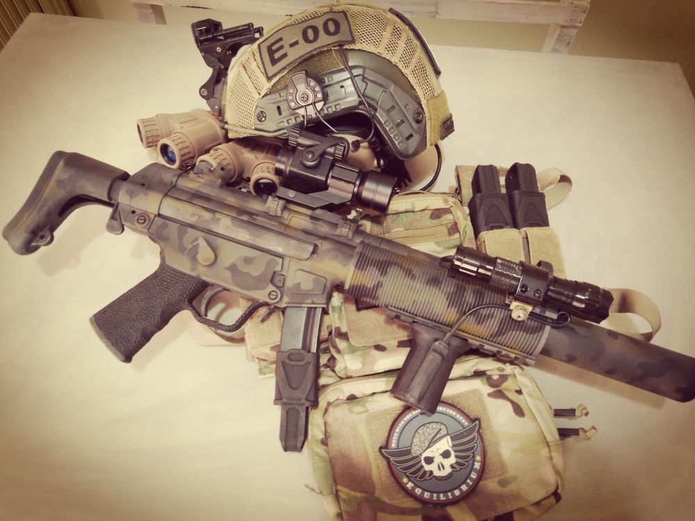

HellmarineGR Posted April 20, 2021 Posted April 20, 2021 P90Greetings from Greece! Mp5 s hop up unit is shit.. I also have a jg sd6 and i m done the TDC mod and also rhop flat hop. I can hit targets 50cmX50cm at 65-70m with 0,3 bbs on a m110 spring and stock barrel.i can stand against higher value replicas easily... Ask me if you want to know what I'm done
