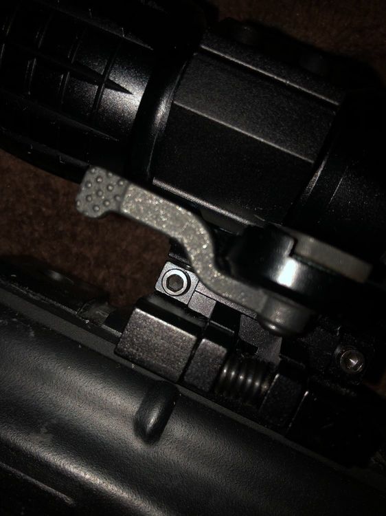

Hey so I bought a 3x Flip down magnifier scope they look so cool
But I need help!!!!!
As you can see in the picture off the birds eye view it's off to the left of the holographic sight and the other picture the red crosshair is top left but on the halo graphic sight it's in the middle ??
Anyone able to give a fellow airsoft noob a hand ???

Magnifier OK. Mount not ok. That is problem. Need new mount.
You're right, but the cost of a decent mount is probably more than it's worth spending on that optic. However, I have this mount on my magnifier (which is also Vector Optics) and it returns pretty well https://www.ebay.co.uk/p/Vector-Optics-30mm-Magnifier-Scope-90-Degree-Quick-Flip-to-Side-Mount-FTS-36mm/1434599697?iid=132573473674&chn=ps&adgroupid=52130512215&rlsatarget=pla-451946728260&abcId=1133906&adtype=pla&merchantid=7148814&poi=&googleloc=9045745&device=c&campaignid=1058844235&crdt=0

See now, what you need to do there is take the 3x magnifier off, put it in a draw, go play airsoft and sell the magnifier in 6 months. This will save you the hassle of lugging it around all day just to discover that it's 3 parts of fuck all use.
Alternatively, the should be elevation and windage adjusters on the magnifier or possibly on the mount base that will help you re-centre the reticule. Unfortunately, there is EVERY likelihood that when you first flip the magnifier to one side and back again it'll be off centre again because NONE of the cheap magnifiers are actually any good (please see my previous comment above).

the offset is due to needing to "zero" the magnifier itself to your red dot (it's not proper zeroing, just moving the red dot image into the centre of the image), the actual zeroing is done by the red dot, and should be done to as far as you are planning to shoot at.
the main problem you'll find with the cheaper mounts is if you flip it over and back it'll not stay centered and there's no way around this than to put down the moolah for a decent mount.
personally i use a UTG mount which is nice and solid, but you'll need a magnifier with the ability to adjust internally (my nuprol one does)
