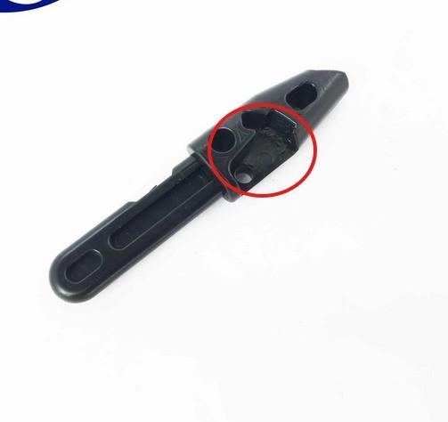

DoJaL Posted April 26 Posted April 26 Hi, Hopefully someone can help me. I bought a used TM mws and the first 2 mags it worked fine, but after that it started spitting gas and the bolt would not fully travel back. It seems that the nozzle arm doesn’t pick up the next bb. The next bb sits a bit forward between the feed lips. I tried it with other mags and a other bolt but still the same problem. I also tried to bend the nozzle arm back but it didn’t work. I tried some velcro in the back and front of the magwell, to fit the mag better but it also did not work. I’m using stock nozzle and oem TM mags. IMG_8131.mov
Decp369 Posted April 27 Posted April 27 13 hours ago, DoJaL said: Hi, Hopefully someone can help me. I bought a used TM mws and the first 2 mags it worked fine, but after that it started spitting gas and the bolt would not fully travel back. It seems that the nozzle arm doesn’t pick up the next bb. The next bb sits a bit forward between the feed lips. I tried it with other mags and a other bolt but still the same problem. I also tried to bend the nozzle arm back but it didn’t work. I tried some velcro in the back and front of the magwell, to fit the mag better but it also did not work. I’m using stock nozzle and oem TM mags. IMG_8131.mov do you have any pics of the nozzle ? Might need a nozzle replacement
DoJaL Posted April 27 Posted April 27 This was it before making it straight again. I ordered a new one (guns modify), which is on the way but I don’t expect it to solve it completely, since I had the same issue with a complete other bolt.

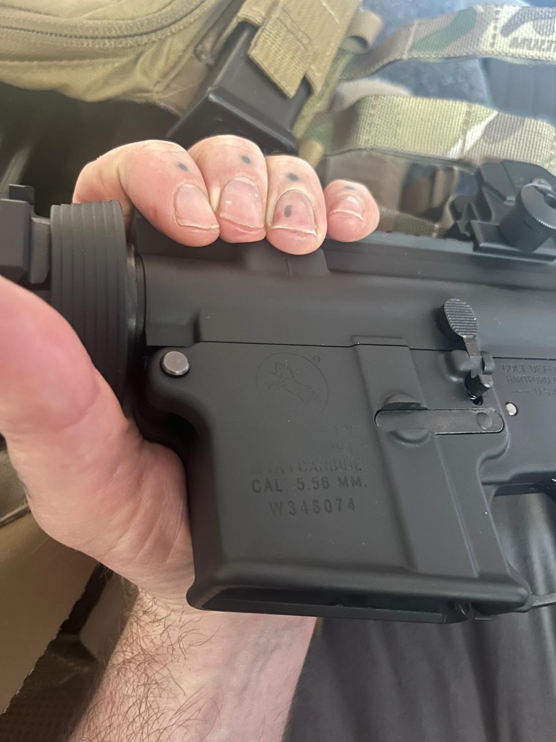

TheMeekon Posted May 16 Posted May 16 Finally got round to setting this up after finishing work for the week and noticed the trademarks are more less missing on the lower. Looks like it’s not been stamped properly. Anyone else seen this issue? Going to have to give firesupport a ring tomorrow.

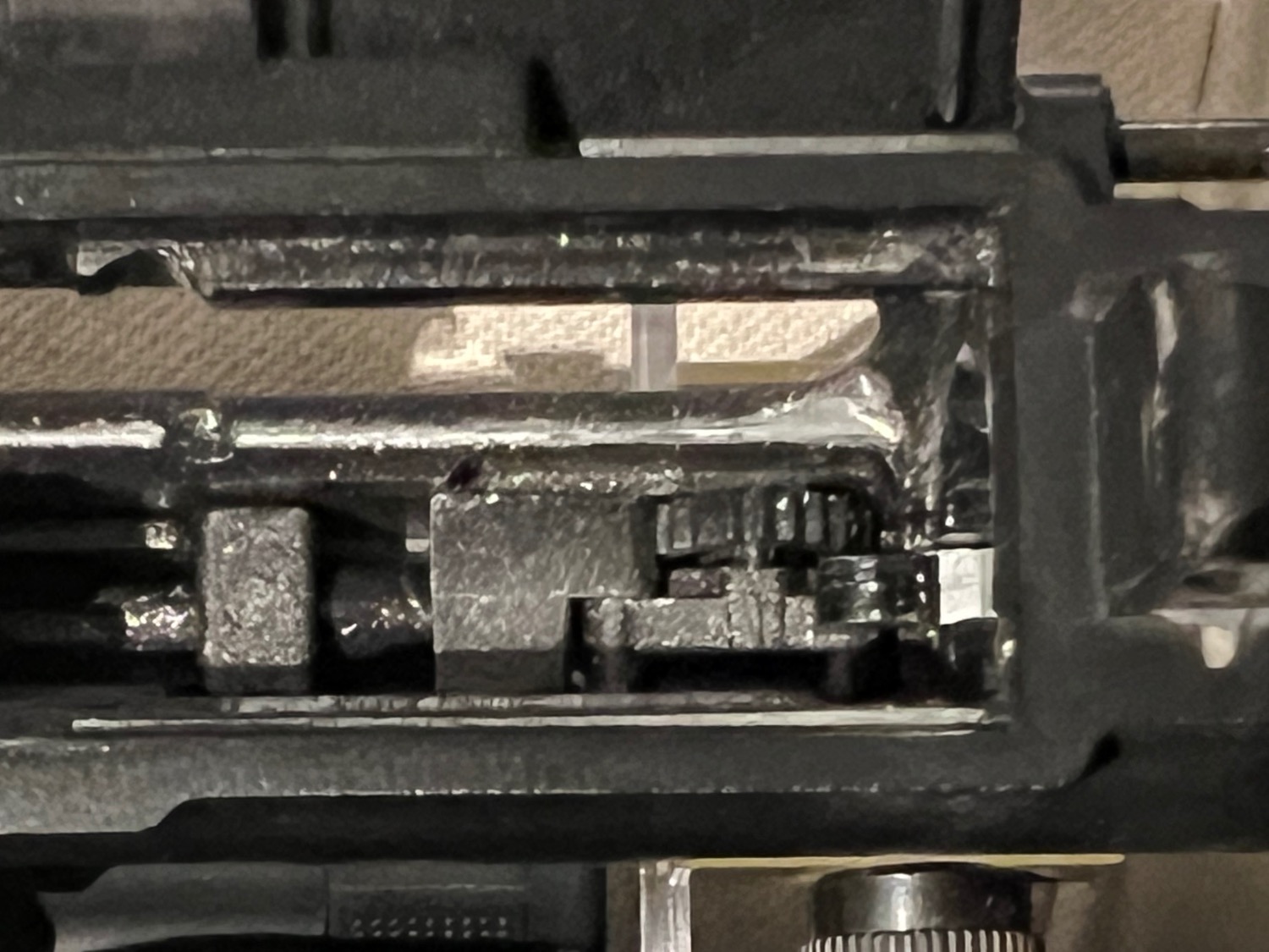

Tactical Shadow ES Posted June 1 Posted June 1 Hi there, Im new to this forum… ? I was hoping you can give me some advice on something. Can anyone recommend a good upper receiver for my MWS? I had to change my bolt to an Orga steel bolt because I dropped my original one and the Orga one was the only one I could get. Now the upper is getting more and more damaged as you can see in the photo. It still functions perfectly though. I however modified almost everything so I’m not sure if it’s just that I’m using a steel bolt and should get an upper made from a stronger metal than the original one, or if it’s one of the other modifications I made like the buffer, buffer tube, buffer spring, Zet plate etc…? Does anyone using a steel bolt have the same issue? Thanks in advance for any advice.

SSPKali Posted June 3 Posted June 3 On 01/06/2025 at 03:00, Tactical Shadow ES said: Hi there, Im new to this forum… ? I was hoping you can give me some advice on something. Can anyone recommend a good upper receiver for my MWS? I had to change my bolt to an Orga steel bolt because I dropped my original one and the Orga one was the only one I could get. Now the upper is getting more and more damaged as you can see in the photo. It still functions perfectly though. I however modified almost everything so I’m not sure if it’s just that I’m using a steel bolt and should get an upper made from a stronger metal than the original one, or if it’s one of the other modifications I made like the buffer, buffer tube, buffer spring, Zet plate etc…? Does anyone using a steel bolt have the same issue? Thanks in advance for any advice. I think the issue here is the bolt is obviously out of spec (or not designed to work with the regular TM receiver…which sounds like a get-out clause!) I would look where the bolt is catching and file off the bolt part, no point trying to alter the receiver or spend ££££ on an aftermarket one only to find out the same thing happens! Worth cleaning out all the chips and dust, won’t do any favours if that gets in the workings
