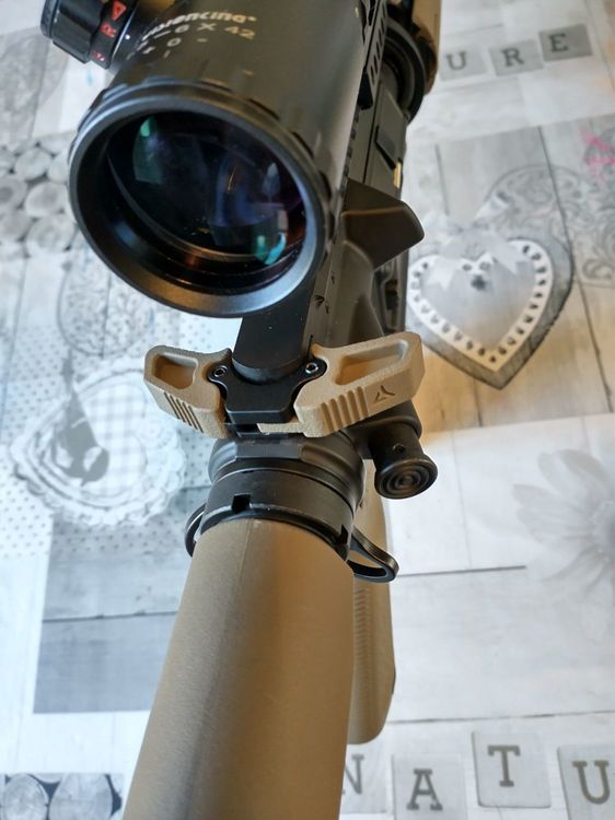

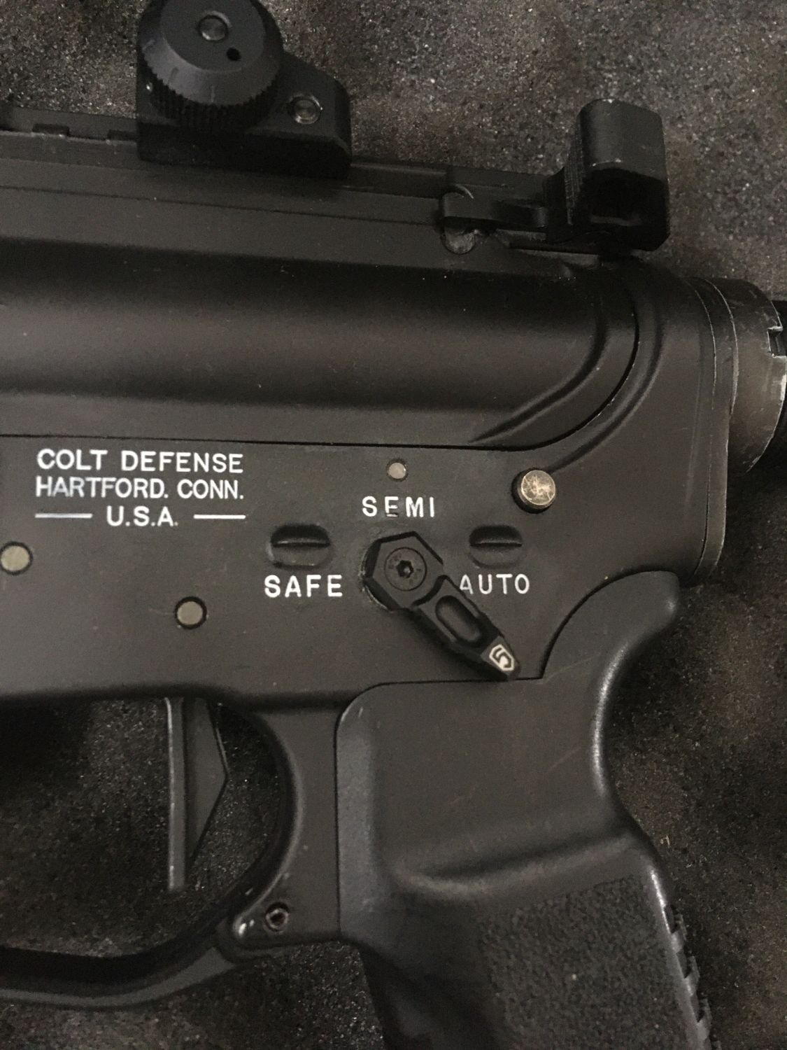

Hypokondrikern Posted May 11, 2021 Posted May 11, 2021 (edited) Small review on the Revanchist 45 degree selector. # Easy to install. # Fit and finish is great but not superb. There is maybe one mm of mushy play in each setting (safe and semi) but both settings have a steady and affirmative “click”. # A bonus for me is that you don’t need to run it ambi. Simply leave out the right side selector and the selector cylinder will end flush with the receiver. (You could even alter the positions of the long and short selector tabs respectively. In case you rather want the long tab on the right side of the receiver) All in all very happy with this purchase. Now moving on to install the bolt stop lever from the same brand. Strong aluminum and super light weight. I hope it will hold up to my aluminum BCG and allow for the use of a B.A.D lever. Edited May 11, 2021 by Hypokondrikern Clarity SSPKali and Wild Weasel 1 1

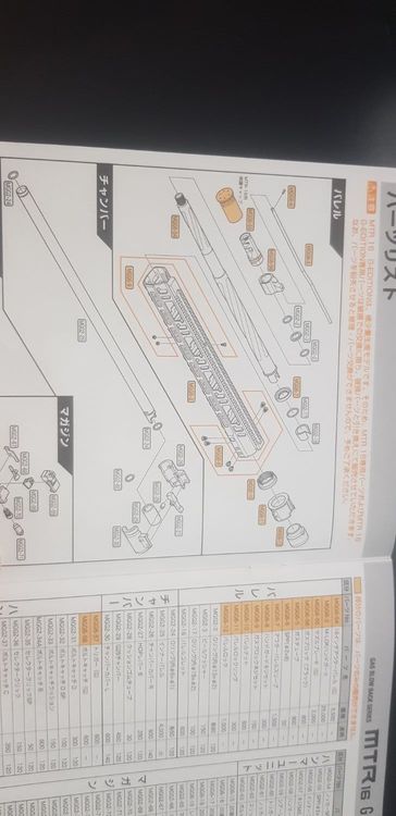

TadsJ2 Posted May 11, 2021 Posted May 11, 2021 (edited) Hey guys, So i finally managed to take out the castle/barrel nut off, I am at this part right now where i dunno what to do next and dont want to harm my MTR. Should i just try to yank out the outer/innerbarrel right now (its really stiff) or should I do sth before this? Edited May 11, 2021 by TadsJ2
AlphaBear Posted May 11, 2021 Posted May 11, 2021 9 minutes ago, TadsJ2 said: Hey guys, So i finally managed to take out the castle/barrel nut off, I am at this part right now where i dunno what to do next and dont want to harm my MTR. Should i just try to yank out the outer/innerbarrel right now (its really stiff) or should I do sth before this? That MTR barrel looks like a giant drill bit...!! If the receiver end is the same as a regular MWS then a wee knock with a rubber mallet should do it... I'd check the manual first though just to make sure there's nothing extra in the MTR receiver/barrel assembly over a MWS just in case there's a grub screw lurking..
TadsJ2 Posted May 11, 2021 Posted May 11, 2021 (edited) Well thats the problem, i dont see any screw in the diagram but cant really figure out whether outer and inner barrels are held in by that MGG6-12 or not... And how should i take it out, whether it is necessary to take it out Talking about this part which is still left on my upper receiver nope, this shit has to be taken out as well... Edited May 11, 2021 by TadsJ2
TadsJ2 Posted May 11, 2021 Posted May 11, 2021 (edited) Okay it gave in after excess heat and bashing on top of it, i even managed not to damage the last nut! now goes the upgrades EDIT: FOR ANYONE WHO HAS MTR16, the last nut should be unscrewed in the same direction as the first one! Edited May 11, 2021 by TadsJ2
AlphaBear Posted May 11, 2021 Posted May 11, 2021 16 minutes ago, TadsJ2 said: Okay it gave in after excess heat and bashing on top of it, i even managed not to damage the last nut! now goes the upgrades EDIT: FOR ANYONE WHO HAS MTR16, the last nut should be unscrewed in the same direction as the first one! There you go. If all else fails give it a good bash lol. Truth be told some of the MWS’s are like that too. You just got to give them a wee bash to dislodge any suction or whatever is holding the collar in place with the receiver.

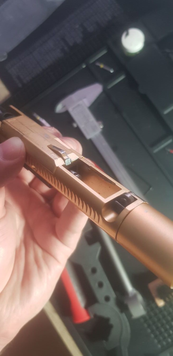

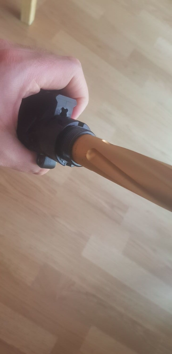

TadsJ2 Posted May 11, 2021 Posted May 11, 2021 (edited) Yea, another head scratcher for you guys, so i changed the inner barrel to 410mm ML crazy jet and ML decepticon 70degree 2021 bucking alongside ML omega nub It shoots with angry gun v2 npas at 410 FPS, all seemed fine until... i found out that my bolt lock stopped functioning! it doesnt lock the bolt on empty mag anymore, why is that? The only thing i changed from previous setup that worked just fin is the inner barrel and bucking! Is my gun shooting on 410 fps is causing that ? Before i did this upgrade (this morning) bolt lock was still functioning! Lowered the NPAS to minimum and the bolt lock sometimes works (on dry fire) and sometimes it doesnt, what could be the problem here? Edited May 11, 2021 by TadsJ2
TadsJ2 Posted May 11, 2021 Posted May 11, 2021 (edited) Could this be a cause of it? That wear on the bolt? asking about this part specifically EDIT: I've found out that i bented one of my mag's, fixed the bent and it started bolt locking, but still bolt lock is not 100% anymore, all my other mags arent bented near the bolt lock latch on the mag, is there any fixes i can try? Edited May 11, 2021 by TadsJ2
