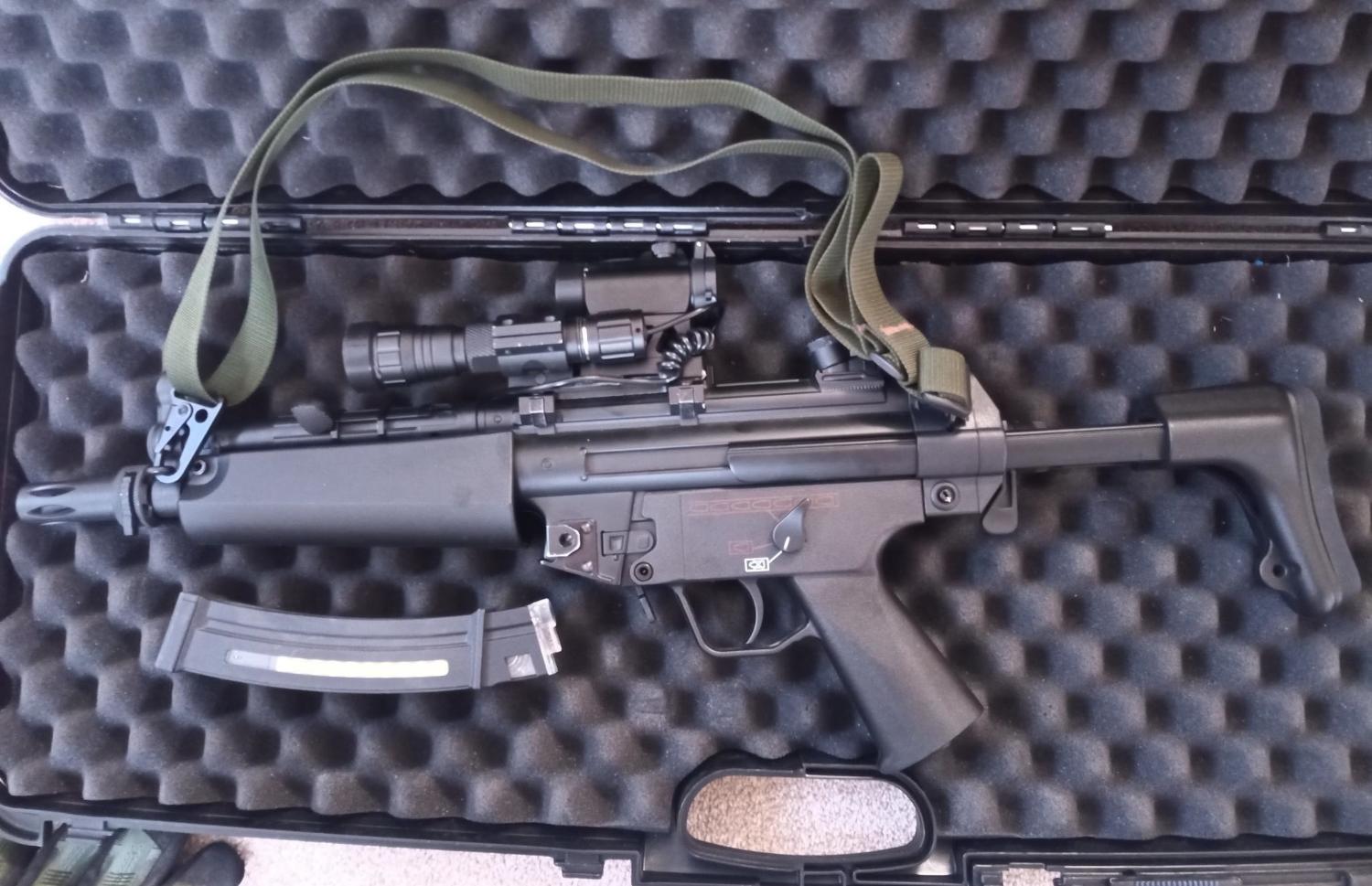

You've gone and inspired me to dig mine out ready for some CQB action tonight at Invicta Black Site! I have been thinking of swapping the motor our for a high torque, but after a few dry shots earlier on a 7.4, to be honest I'm happy with its snappiness.
Always a pain to rig a light and pressure pad onto it with a classic hand guard though. Good job that cocking handle isn't needed ;)

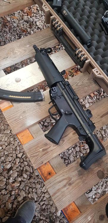

That's why I've gone with an SEF lower on all mine. The right side of the ambi selector always digs into my trigger finger.
15 hours ago, Sewdhull said:
Where did you find the SEF receiver?  I can't recall seeing one and I mooched around MP5s for ages before buying one.
My MP5s are Classic Army for the exact reason that I wanted SEF lowers. There's a few available as parts, I think ICS still do one.
