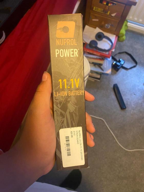

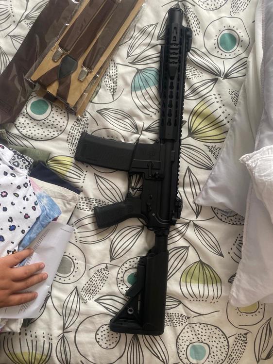

Hello all, fairly new to airsoft and i was wondering, i recently picked up a Specna Arms sa-e07 Edge 2.0 but i have come to a dilema, i bought a nuprol 11.1v 2000mah li-ion battery but no clue if it’s compatible with it? Help please i dont want a destroyed gun on my first game with it. Thanks all.

As with a lot of things, the answer to your question is pretty much "it depends."  Not all MOSFETs can handle 11.1V properly, and it could result in over-cycling if you're leaving everything else stock.
It's also worth noting that if you bought it new, a number of retailers say that -- unless they've specified it's ok to use -- putting 11.1V LiPos in a RIF they've said can only handle 7.4V, will void the warranty.
Yeah agree with @L3wisD. It will be ok and give you a better rof( rate of fire).

Should be fine. If you experience double-shooting on semi-auto, the active braking feature on your mosfet can deal with that.
Aside, have Nuprol just taped three 18650 li-ion cells together there? 🤔
