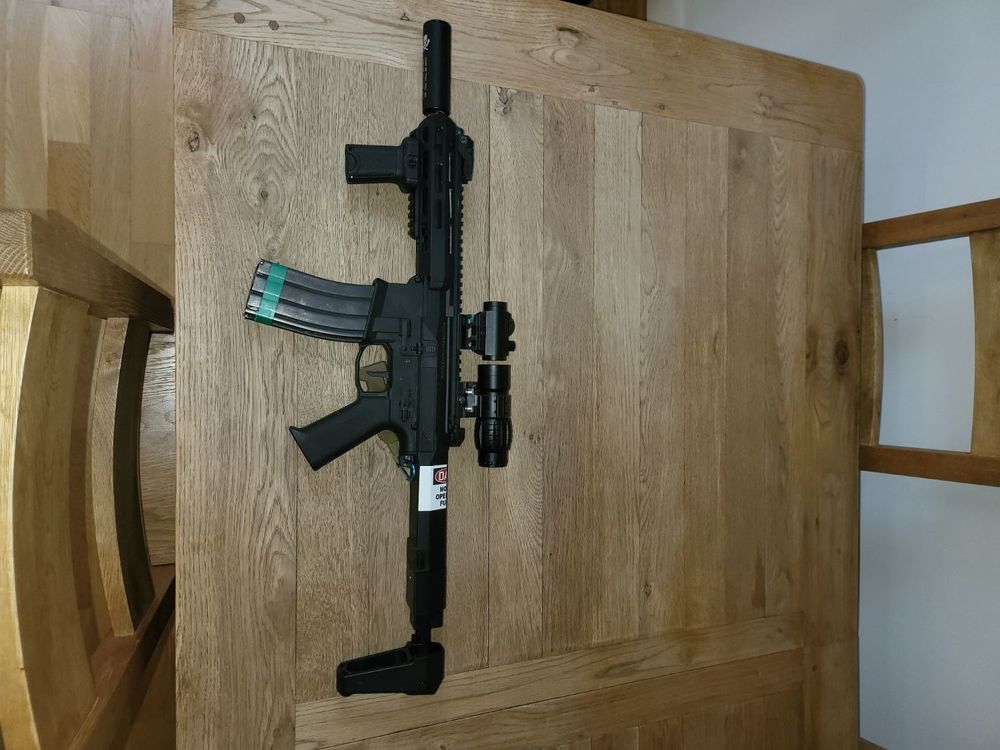

Here's a couple of recent pics of me with my beloved 906C ...
image.png.0364c3dec0d5115279596f6a169995de.png image.png.36490cd480b881a63018e734ed9eeb7c.png
Changed the stock, as mentioned previously, and added various red dot and LPVO sights, a stubby foregrip, and a suppressor for Tacti-Coolness.
I use Lonex flash mags because I hate winding high caps, but they sometimes unwind slightly on insertion.  Still worth it though.
I have a Titan 11.1v 3000mAH in the stock.  I have a heavy trigger finger so that lasts me most of a day.  (There's a separate discussion about that elsewhere... My gun might need a tweak or a re-lube as it shouldn't be that hard on the battery)
I changed the hop rubber and nub for a Maple Leaf Macaron 50deg plus Omega nub.  That's a fairly standard way to improve any AEGs accuracy, I found it didn't seem to make any difference from the out of the box accuracy tbh, but I'm delighted with the long range performance of the gun to this day ?
Typically I run 0.28g BB's, but I've run a full bottle of 0.32s through it with good results on a windy day.  So that hop system is working pretty well for me.  Others may recommend changing in a ZCI unit, but I'd see how you go first.
The one thing you'll need to change fairly early on is the spring.  The standard one seems to lose its mojo quite quickly.  Easily done thanks to the quick change system, and an M105 spring costs only £10-15
Job done!
Edited by RostokMcSpoons

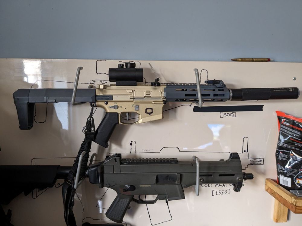

For reference, here is my 904 with it's current attachments.  Different stock to yours, so batteries will be different.
