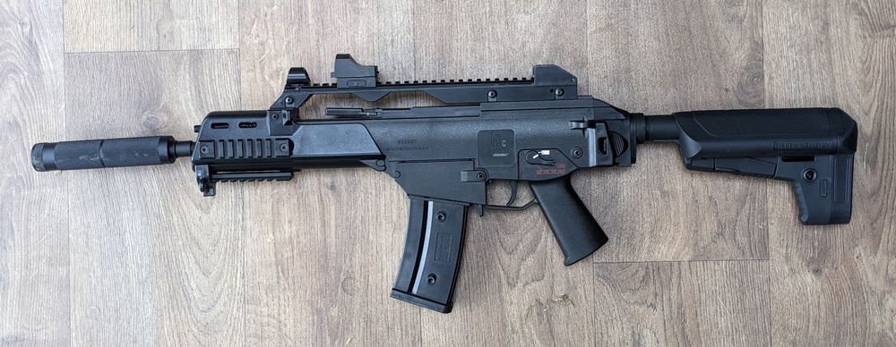

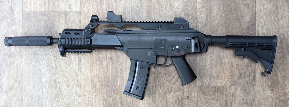

Not fully finished by any means, but the stock adaptor turned up on tuesday, so I borrowed my sons suppressor and tried out a couple of M4 stocks I had laying around. Its currently front wired, the hand guard is pretty easy to remove, and has space for a two or three cell Lipo brick. Do I leave it like that, or do I rewire to the rear and set it up to take more common AEG Lipos in a crane stock?
advantage of wiring it to the rear are it would move the center of gravity backwards, making the gun nicer to shoulder on an all day game, and it would take commonly available batteries. Advantages of leaving as is are that you can use a lower profile M4 Stock which will fold up nicer, you won't see any wires when the stock is folded, and you can quickly and easily put the original skeleton Stock on if you prefer that look.
Thoughts?
I know the barrel looks bent in the photos. As far as I can tell it isn't.  the whole suppressor and barrel assembly is straight and correctly aligned with the inner barrel, but the whole thing might be angled downwards a fraction when fitted in the gun. more investigation may be necessary, possibly some shims.
FWIW, I can't run a suppressor silencer[*] on my G36 because it does skew too much and mashes up the BBs.  I don't think you're imagining that.

Ha! To be honest, I don't mind if you call them silencers or suppressors. I'm not *that* much of a pedant. I seem to have fixed my particular issue. I applied gentle corrective pressure in an upward direction, just to see if anything happened.  there was a *pop* and the barrel was aligned with the same horizontal as the top rail. I think the outer barrel just wasn't quite aligned with the guides it slides on to. My plan is to fit a longer barrel and then cover it up with a mock supprilancer. I am hoping that a brass barrel going all the way down the middle of the outer barrel and the silessor will give it enough rigidity to keep things in place.
Hence Forth, I shall refer to the barrel attachment in question as tubeymakebanggopop.
I'm airing on the side of leaving it front wired because I prefer the look of the lower profile M4 stock.
