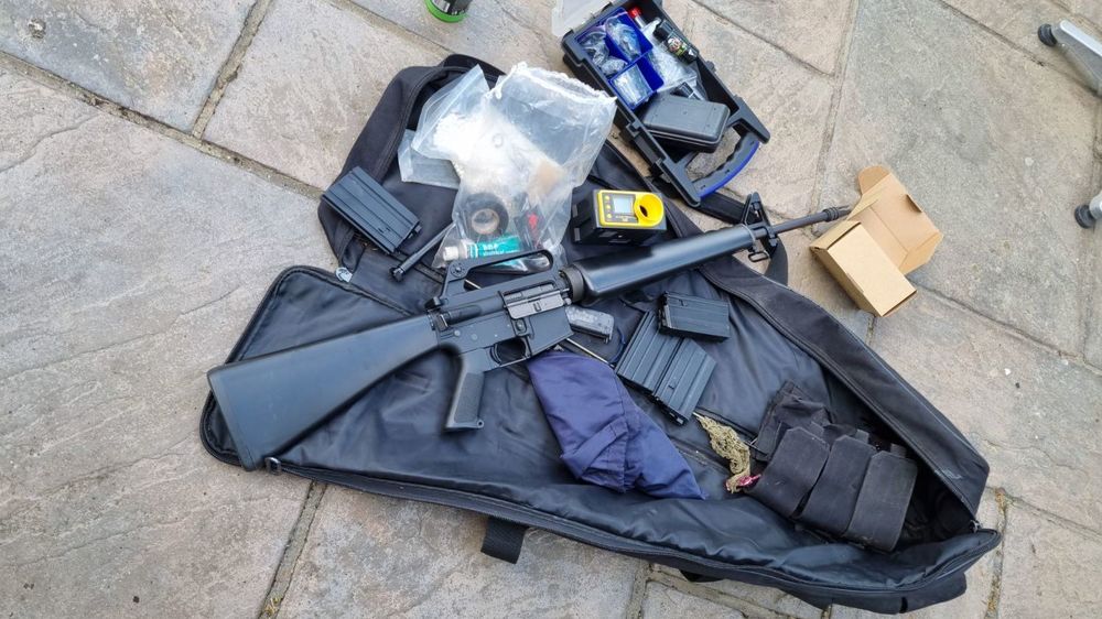

Hi. I don't know what the VN"s are worth now but it's a definite keeper regardless of the offers.
