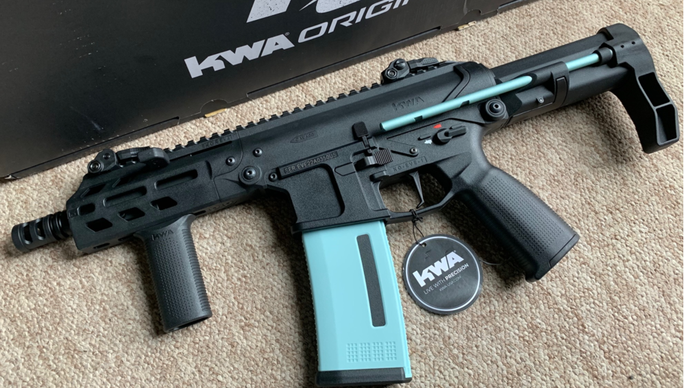

Speedbird_666 Posted May 25, 2022 Posted May 25, 2022 TLDR? Great on the outside, a bit crap on the inside. Here's a quick 2 hours of ownership first impression...... Right - to start. Packaging was fine - typical KWA fare from what I've seen of other guns in their Ronin lineup. A bag of accessories was also included which includes QD sling mounts, M-Lok rail sections, T-Handle Allen keys, and a KWA branded Speedloader. Nice touch. Being the ICE limited edition version, it also comes with a Ice-blue 120rd mid cap in the box. The gun is fitted with a really quite excellent M-Lok vertical grip along PTS Backup sights out of the box. Externally, it's the best plastic I've seen on pretty much any airsoft gun. Think PTS EPS stock plastic quality, but the whole gun is made of it. It really is very nice to pickup up and hold. That is, from the pistol grip forwards. Where it falls down is the stock. Again, it's very high quality, but much like any other PDW-style stock it is limited in terms of storage capacity (which can be mitigated to a degree with an extension) and adjustability. It only has three positions, fully closed (thus useless), fully open (which is a bit wobbly), and somewhere in between which is still a touch too short for many. If I keep this gun (more on that later), It'll get a buffer tube and a PTS EPS Stock - much like KWA's still unreleased EVE-9. The gun is well balanced otherwise, and the pistol grip (basically a PTS EPG) is an excellent fit for my hands. The gun is largely ambidextrous, with fire controls, bolt and mag release on both sides. Problem is, the bolt release stopped working after the third time engaging it (and I was being gentle), so the bolt will not lock back. Disappointing to fail almost instantly. The charging handle, being up front does get in the way when holding the gun if you like to wrap your hand around the rail, but it can be easily switched to the other side to move it out of the way - so no biggie. But what's it like to shoot? I don't know really. I tested it briefly on a 7.4v LiPo, but the motor lacks torque and I could lock the box up quite easily. Performance was a laboured 14-15rps, trigger response not great at all. The gun sounded laboured generally and the gearbox loud (which I've heard is a trait of the v2.5 GB thus 'normal'). Ok, well, KWA themselves say it's good on 11.1v LiPos, so I switched to a 20c 1300maH 11.1v. It blew the fuse within 30 shots. *Sigh*. The trigger response was nice enough and I'm guessing a ROF of around 19-20RPS in the 10 seconds it functioned for. Soooo.......I'm on the fence with this one. I could fix the niggles easily, swap out the motor and stock, probably sort the bolt release too - and the rest of the gun feels amazing in the hands otherwise. But I can also send it back to the vendor before any more gremlins pop up. Hmmm.....watch this space. ak2m4, Skullchewer, Rogerborg and 1 other 1 1 2

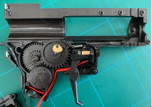

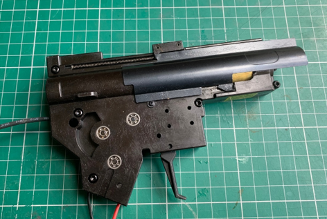

Popular Post Speedbird_666 Posted June 6, 2022 Author Popular Post Posted June 6, 2022 A quick look at the internals... Well..... the switch isn't going to last long on 11.1v - there is clear indicators of burning/arching/pitting on the trigger shuttle already after ~30mins of use. Problem is - the switch is proprietary. It'll probably be easier to source a Gate Titan than try to find a replacement KWA switch here in blighty. Great. The switch is not a complete write-off yet,so I'm going to try clean it up and fit a simple Mosfet for now. KWA should of shipped the gun with one fitted - they are not exactly expensive these days. The rest of the gearbox is fine. Gears seem tough, the shimming is a touch tight, but with the shell being so thick and less openings in it to test each gear individually, it'll be tricky to re-shim so I'll leave it as-is for now. The shell really is a chunky beast. I have no concerns about it's long term durability. There is a proprietary tappet and nozzle which is a characteristic of all KWA 2.5 guns. The Piston and Piston head are best described as mediocre so I've ordered replacements from @ak2m4 . There is so much potential for this gun - it is a few component choices short of truly excellent but ultimately penny-pinching by the manufacturer has let it down. As-is, would I recommend it? Well, if you are confident at teching your own guns, then yes, I think I do. But for a beginner player? - Good god no. And that's a real shame. Cocha, Tactical Pith Helmet, Herrgh and 2 others 5

Speedbird_666 Posted June 10, 2022 Author Posted June 10, 2022 (edited) The gun has now been fully re-wired with Alphawire and a Mosfet added - found a simple (but slightly chunky) Acetech AceMOS plus unit lurking in my electronics box that I forgot I bought 3-4 years ago. Shimming has been tweaked on the Sector and Spur gear, and sounds a bit better than before. Left the bevel as-is. The stock motor is shit - hands down the weakest link on the gun. I am able to lock the gun up on an 11.1v and it gets really frikkin hot after a few seconds of firing. So it's got speed, but not decent torque and definitely no efficiency. Put an SHS 16TPA Hi-torque motor in - major over-spin/double shooting on an 11.1v. Switched to a 7.4v LiPo and it seems happy enough - trigger response roughly equal to the stock motor but without any lockups, around 16-17 RPS full auto and running pretty cool temperature-wise. So now it's very usable as-is, but I want an even snappier trigger response, so the next step is a 22TPA motor on an 11.1v. Hoping to keep it around 17-18 RPS, but with the extra torque for semi-auto. Edited June 10, 2022 by Speedbird_666 Tactical Pith Helmet, ak2m4 and John_W 3

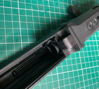

Speedbird_666 Posted March 2, 2023 Author Posted March 2, 2023 23 hours ago, BROWNING91 said: Have you tried fitting a buffer tube? stocks look bit ugly imo Yes I have - some (older style) buffer tubes fit - the receiver extension is quite long so many newer style ones won't work because the screw plate is too far forward inside the buffer tube (to maximise battery space) so you can't tighten it up. The PDW stock is actually pretty good with an extension. I disliked it at first but have grown to like it quite a bit, very easy/quick battery change. I'm not planning to change it now.

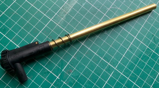

Speedbird_666 Posted April 11, 2023 Author Posted April 11, 2023 Fuck you KWA. Turns out that KWA Pistons are oversized compared to normal AEG pistons by a couple of MM. Luke/Negative Airsoft mentioned this in the video I posted above but I figured it would be OK. I was wrong. So if you replace the stock piston with common (and reasobly priced!) XT/SHS fare - don't expect it to last very long. My XT piston died on Sunday with a lovely crunch as it somehow skipped over the sector gear. Investigating the fitment of the piston on the GB rails reveal that it's entirely possible that the piston can rotate several MM on it's axis AND up and down laterally. Three or four teeth are damaged - it doesn't look too bad in the photo but you can feel it when you run a nail over them - and the piston has dozens of stress fractures where the rack flexed over the sector gear. If you subscribe to Luke on Patreon - you will see that he now has several videos (not on YouTube) about KWA guns. Seems like there's also a tappet timing issue with some guns if you use 11.1v LiPos - causing huge power drops once things (like the tappet spring and plate) start to wear. Slowing the gun down with a 7.4v LiPo will see the power return - but that's a shit solution to a design flaw. Negative Airsoft is now adding a brass spacer to pre-load the tappet spring, removing the delayer chip, and cutting the tappet plate (DSG style) to speed up the forward nozzle movement. I will probably take the same route pre-emptively. Luckily he mentions a fix for the Piston in the shape of the Madbull PX02 - which is a near match for the stock piston in size. Problem is - they cost nearly £30 and are hard to get hold of...? So coming full circle - do I recommend this, or any other KWA gun? No. No I do not. Steer well clear. Or be prepared to spend a shit ton of money: £244 - Base gun £32 - replacement Motor (SHS) £110 - Gate Titan (yeah - I would say it's a pretty essential purchase for this gun because the stock switch/COL is terrible and impossible to get spares. No, Gate Asters or Peruns do not work without some sketchy modifications - the GB was built specifically around the Gate Titan) £7 Piston Head (XT) £30 Madbull Piston Total Cost (so far) - £423 *sigh* Cocha, ak2m4 and Rogerborg 3
