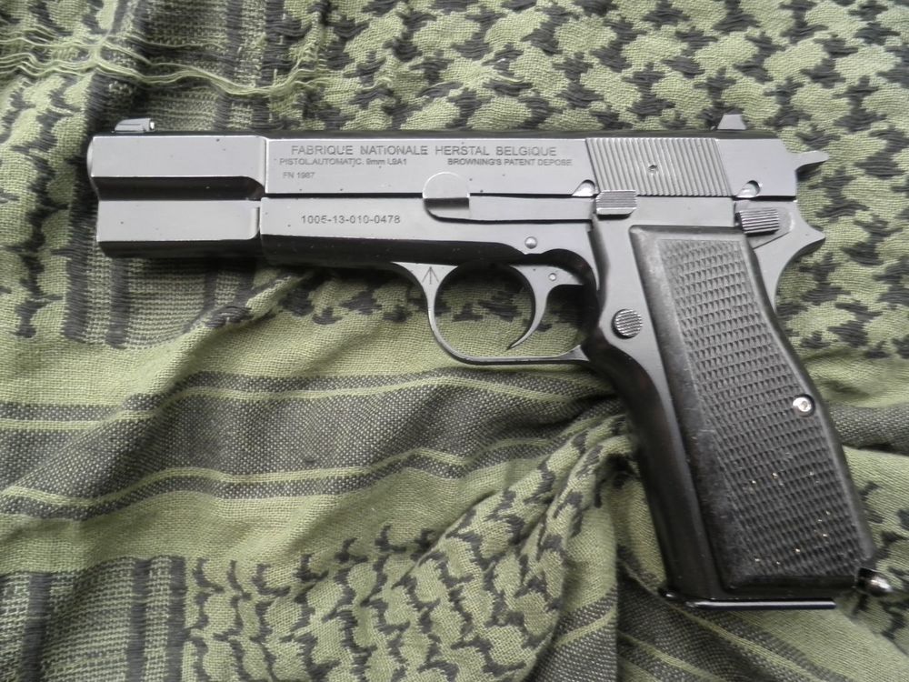

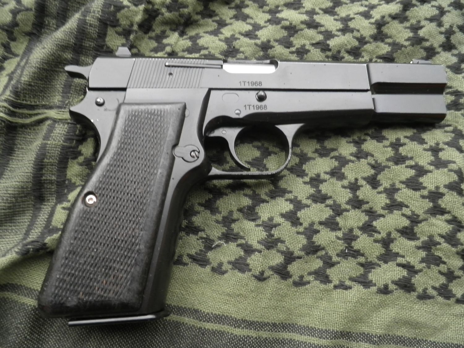

I had them added. Jim at LC's engineering did them for me on mine and a mate's one.  they were the first ones he did so he spent wuite a bit of time getting fonts etc as close as he could to the referance pictures I sent him. Have to say I am very pleased with the result. I've added real steel grips and the small single safety for a more specific look.

Afraid not, I just sent Jim a load of pictures and left it to him. I do know he spent quite some time matching them as closely as he could.

Yes it is, along with real grips

From memory £60 which I felt was reasonable for the amount and quality of work.
