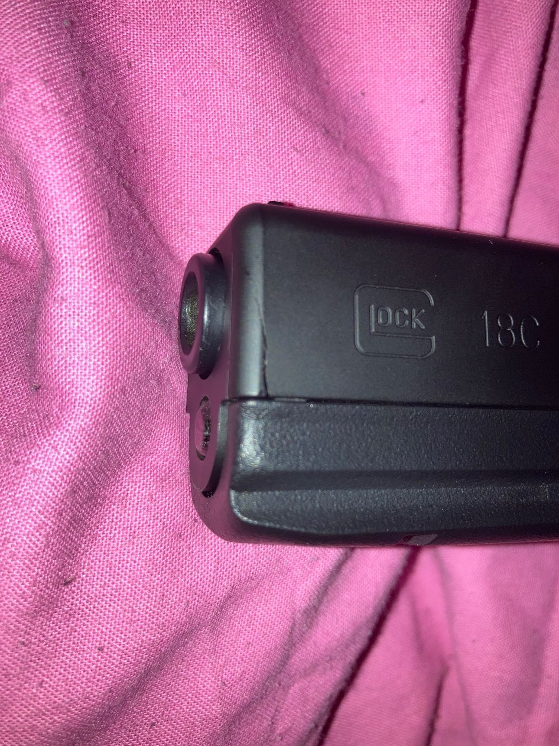

Hey guys, i really need help, i bought a TM G18c GBB and i havent used it that much and the top slide started to crack om the edge, i looked everywhere for a better slide maybe metal or even a replacement one, and i cant seem to find any, can anyone help me?

Where is it cracked? Do you have a photo? I'm guessing either yours might have had a small manufacturing defect which caused it to crack or its suffered an impact whilst you've been playing (I how of a few broken rifs from the player running up against barricades or falling).

Mine has only been home use, and its cracked towards the front part of the gun, ive only used normal we gas, its barely been used, here and there i take it out to play about and thats it

yeah that's a typical crack of a slide cycling too hard. the gun is not designed to use Green gas the effect will be worse in doors due to a higher ambient temperature increase the gas power especially if you are dry firing.

or put another plastic slide on and use lower powered gas

Wow that sucks. I'd say a manufacturing defect,  I've put tens of thousands of rounds through mine and have no cracks.

nah it using over pressured gas. People keep saying TM will handle green gas fine, they don't if you haven' broken a TM  using over pressured gas you are just lucky.

I’ve owned dozens of different TM pistols, used hard in Practical Pistol competitions, lots of very rapid fire.
Only two have ever failed on green gas. The original G19 pulls the slide off the hammer rails, and the G18 on full auto smashes the front of the slide off.

Yeah, granted full auto probably reduces the lifespan of a G18, but I maintain that TM pistols are absolutely fine with green gas and OP's pistol was either a defective piece or has been damaged.

Survivers bias. My team mate loves 5-7s but for some reason he only uses propylene.  He gets a year and a half ish before he kills the gun he's on his seventh gun. He accepts this to get the advantage he belives higher powered gas gives him.
Most of the time TM can handle higher power gas but they are not designed to and you a wearing the gun out prematurely. people in the UK get a pass due to lower ambient temperatures compared to Japan but I have seen plenty of people looking for their pistol slide because it was much warmer than expected.

OK, let me ameliorate my position; TM's are generally fine with green gas, and whilst they will not last forever, higher power gasses will degrade their lifespan. In all my years, I've not had first hand experience of slides flying off, though I've heard of it happening. And it sounds like this is something you've come across. I see this being a rare occurrence.
I roughly counted how many rounds I fired yesterday, it was over 500 and that was fairly average for me.
I think my point is that I think the fear that if you put green gas in your TM the slide will end up in orbit is overblown.
I still think OP's pistol was defective or damaged.
