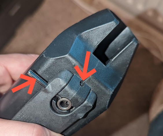

RostokMcSpoons Posted January 25, 2022 Posted January 25, 2022 (edited) Chaps, I've just received a PTS EPS stock, but it won't slide straight on to the DE's stock tube as the locating bolt doesn't retract fully out of the way, and the DE tube has a solid end (the cutout groove in the rib doesn't run all the way to the end) It looks like I'll have to disassemble the operating lever and the bolt, and re-assemble it on the gun. I can see two drift pins (arrowed) holding the bolt in place, but there's also quite a strong spring in there somewhere... if I knock out the two drift pins will I be able to put it all back together??? (I have already removed the cross pin but it's the longitudinal pin that actually holds the bolt, it seems) I appreciate there's only a tiny chance anyone here has ever had to do this, but I had to ask! Edited January 25, 2022 by RostokMcSpoons

Supporters Lozart Posted January 25, 2022 Supporters Posted January 25, 2022 @RostokMcSpoons are you pushing the operating lever up to retract the pin or pulling it down? The pin drops a lot lower if you pull it downwards. RostokMcSpoons and Paul72 2
mintsauce5 Posted January 25, 2022 Posted January 25, 2022 (edited) maybe you've tried this but you lever the opposite end as Lozart said and the pin goes flush IMG_9234.MOV IMG_9234.MOV IMG_9234.MOV Edited January 25, 2022 by mintsauce5 RostokMcSpoons 1
RostokMcSpoons Posted January 25, 2022 Author Posted January 25, 2022 Blimey, thanks for the quick replies, you guys are on point today Well I took what Adolf said, and tried extra force, but carefully applied! I took out the cross pin again and pushed harder down on the locating pin, and yes it moved down flush. So I hooked an Allen key through it, pulled down on it, and got the stock on the tube. Yay! Then I just refitted the lever and it's all good. Now I can't view the movie clip ('we could not locate the item you're trying to view'), so I'm not sure about getting the lever pulled down, as it can only move so far before it hits the stock and can go no further. As the back plate comes off to fit the battery, I should be 'sorted, sweet as a nut, luvverly jubbly' anyway

Hatchet Posted January 25, 2022 Posted January 25, 2022 This can be a bit tight, but is doable without tools (at least on mine, and the stock tube groove sounds the same). For me, activate rear of lever until it's flat against the stock. Then, get fingers underneath front of lever (so, in front of the pin) and pull down. This will pull the pin further down and should give enough clearance (but can require a bit of pull strength in the fingers). No need to use tools or knock out pins, etc. RostokMcSpoons and Paul72 1 1
Fatboy40 Posted January 25, 2022 Posted January 25, 2022 (edited) @RostokMcSpoons The PTS EPS fits perfectly on all the three DE M900's we have at home, including the M906C. It just feels like you're pulling too hard on the "lever" and something may snap, but you just need to pull it down even harder than you think you need too, and I didn't need to remove the pin you've show ? Edited January 25, 2022 by Fatboy40 RostokMcSpoons and Paul72 1 1
