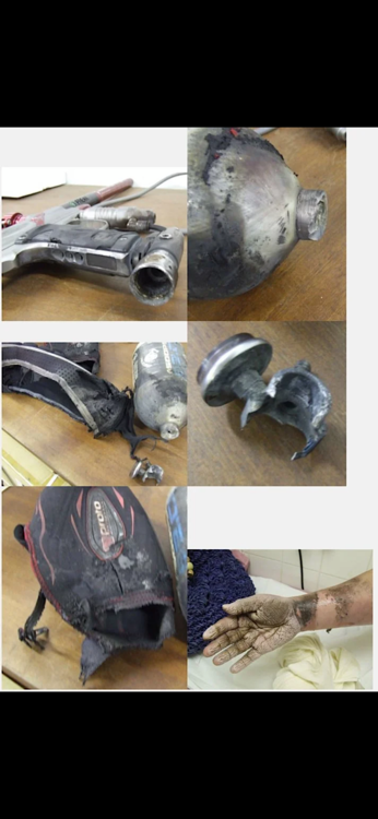

Moderators Tackle Posted September 3, 2021 Moderators Posted September 3, 2021 15 hours ago, Tommikka said: I would recommend against a compressor unless you have a serious level of use out of it, or plenty time to leave one running and allowing for cooling. You cannot use domestic or workshop types of compressors. (Actually there is a way, but I’ll get to that) You need something capable of compressing to 3000psi, and providing clean breathable quality air. That will cost a number of thousands, and needs to be maintained. You can get cheaper ones now that are capable of that level of pressure, but I’m unconvinced and you need to know what you are buying to ensure the quality is up to the job. There are booster compressors such as the discontinued Shoebox compressor by Tom Kaye. This type needs a workshop style compressor as a primary source to feed the shoebox at 100s of PSI which then boosts to 1000s of PSI The source air from domestic or workshop compressors is at high risk of oil or other contamination. Best case scenario is dirty air which clogs the bottle side of the regulator and gives an early burst disk failure. The worst case scenario is when you get any heat from air pressure you end up with a flash fill explosion. I’ve seen the effects and you don’t want that. The photos below are from a flash fill explosion near Southampton a number of years back. It was due to oil contamination remaining from an earlier unidentified player and the player concerned had their regulator explode during filling, their bottle became a rocket, their clothes melted onto them and you can see the state of his hand. He luckily lived to tell the tale. My recommendations are: 1) get a fill from the site you play at. This might not be possible at all airsoft sites 2) occasionally use the stirrup and build up your muscles 3) get a fill at a friendly dive shop - you will probably need to bring your own fill adaptor rig, and it will get expensive per fill for a playing size cylinder 4) buy spare aluminum cylinders and fill as many as you can in one go from a site compressor 5) buy a scuba cylinder, fill it at a dive shop, then use your own fill rig to cascade fill to your playing cylinder Fill by as little as possible and as often as possible, just topping up to minimise the pressure difference between cylinders to make your scuba source last the longest Thanks, you just gave me another reason to not bother with hpa? Never realised it can get that "technical" just to get a good set-up
