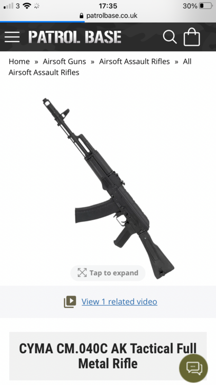

JVacation Posted August 5, 2021 Posted August 5, 2021 Hello, Had a look at the gun suggestion guides on here but they are quite old and out of date now. I recently bought a Cyma AK CM040c but I as soon as I held it I knew it wasn't for me. The weight was fine and it was built very solid I must admit but something personal to me just felt "off". What are some good go tos now? People keep recommending Specna Arms because they come with mosfets already, some people talk about G&G but I used one of the CM16 raiders as a rental 3 times. It felt nice and worked but it did lack range and accuracy. Do G&G do good guns which are a step above those? I am open to all suggestions but unfortunately the long CYMA ak was just not for me. Cheers!

GAMBLE Posted August 5, 2021 Posted August 5, 2021 Hi @JVacation! ? Shame about the AK, I’m looking to get one in my collection, interested in selling it? (If it is this one in the pic.)? Good luck finding the right one for you to start with? ??? ?GAMBLE?
JVacation Posted August 5, 2021 Author Posted August 5, 2021 Just now, GAMBLE said: Hi @JVacation! ? Shame about the AK, I’m looking to get one in my collection, interested in selling it? (If it is this one in the pic.)? Good luck finding the right one for you to start with? ??? ?GAMBLE? I already sold it today! Going to a good home of a AK Collection! 6 minutes ago, Oneshotscott said: buy this -> https://www.patrolbase.co.uk/g-and-g-armament-combat-machine-cm16-r8-l (I just used this shop as example, I'm not biased on retailers) fit this -> https://www.bztactical.co.uk/asg-madbull-black-python-v2-6-03-aeg-inner-barrel-229mm-8037 (again, I just used this shop as example, I'm not biased on retailers) It may not have a Mosfet or be full metal but you will not be disappointed with its performance per £. I can only speak from my experiences and my r8-l still works as well as it did on day one (5+ yrs ago). I reckon its the best beginner/intermediate gun that bridges that gap before you go into the more advanced/expensive options.. Take the advice offered by the other members as they all equate to a tonne of knowledge and experience and whatever you decide to go for, have fun. I did see this one today, I take it is a good solid gun which has a good range and reliable accuracy? What does the barrel upgrade do?
