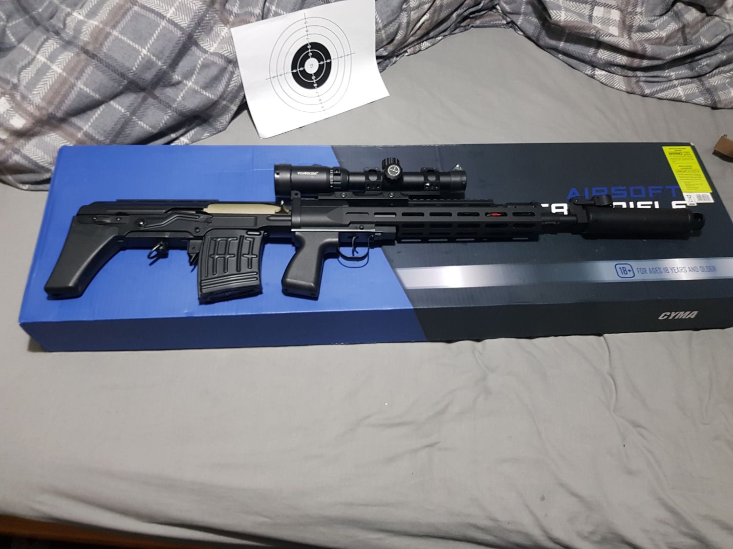

So today is the day the trigger was pulled. I am now a proud owner of a CYMA SVU. Managed to find one second hand for a good price. Got hold of a 1.25 -5x Visionking sight. Got to admit, I thought I preferred it in tan until I got the scope attached.
Game day on the 9th and start seeing what work, if any needs doing.

Were they still doing the minimum spend limit? Glad you got your stuff quick with no issues. I ended up going second hand for the SVU. I am actually glad I did, I honestly thought I preferred the tan variant of the RIF. After placing the scope on top, I really like how this thing looks. From what the guy that sold it me said, was that it was skirmished a couple of times, and he has left it stock. It is currently shooting .20 at approximately 280fps (These readings were really inconsistent and not sure I trust it....found the RIF wanted to double feed quite a bit during this also). I then went for .25 to chrono. Really glad I did this as, it was shooting around 250. Cant remember what exactly it was, but I know it deviated 2-3 fps higher or lower but at least it was a consistent reading and one I could trust. Doing this also eradicated the double feeding issue, not sure why (if anyone can help me with that I would be appreciative ).
I have got it down to where I have got out the inner barrel and hop up out of its frame. Not touched a gear box or motor before so don't really want to go that far, So I think I am going to start looking at changing parts towards the end of this month. I am going to have a game with it on the 9th, should be a good laugh. I'll keep updating just in case this helps someone else also.

Looks awesome with that lpvo!
Thanks man, I was looking at buying the 3x Vortex but my mate steered me away from that and told me about Vision King. I took his recommendation and pulled the trigger. 1.25-5x magnification. This one has a German styled reticle. I think it was around £80 for the optics and £20 for the QD base plate. I think eventually I will grab a couple of Vortex, cant complain about that warranty haha
