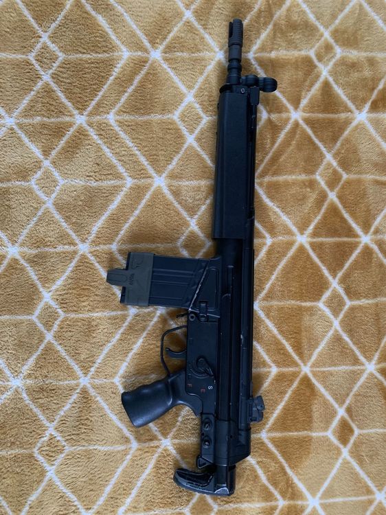

This is my G3KA4. Based on a CA but I’m not sure on the exact model as it was built by another forum user.
So far all I’ve done is cut the inner barrel down and source a correct style flash hider from LCS Engineering.
It doesn’t look like a whole lot has been done other than replacing the fixed stock with a sliding one so based on that I’d say pretty easy to build?
I’ve got a railed handguard on its way too, will see if I like the modern look or not.

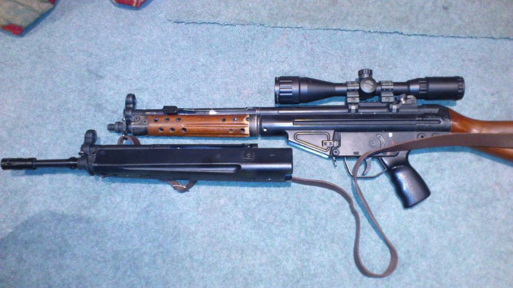

Had a closer look at this, the bit of the barrel at the front (forward of the sight post) is shorter, but the gas tube is still full length. The G3KA4 has the whole forend shortened such that the charging handle rests just behind the front sight post.
You can replicate this particular model by swapping the front outer barrel for an MC51 adaptor and fitting a shorter inner barrel.
You can see the difference here:
Guns - Heckler & Koch G3
The one at the bottom is the G3KA4 - you can see how much closer the charging handle is to the front.
Bunch of different versions here by the looks of things and now I questioning both my eyes and my sanity trying to compare them all.
Jacob's one doesn't look right, because the charging handle is right up on the front sight like an MC51.  I'd assume it's been made by cutting down the barrel at the front and shortening more than usual (because it looks too long to just be an MC51 front end.
The one that George has linked looks right to me - charging handle looks about right and the foregrip is shortened too, based on where the bipod notches end. Probably the easiest way to do it and based on their description (CA33 parts) the same way most people have done it.
I've attached an old pic I had that shows the difference between the CA33 front end and the standard G3 front end.

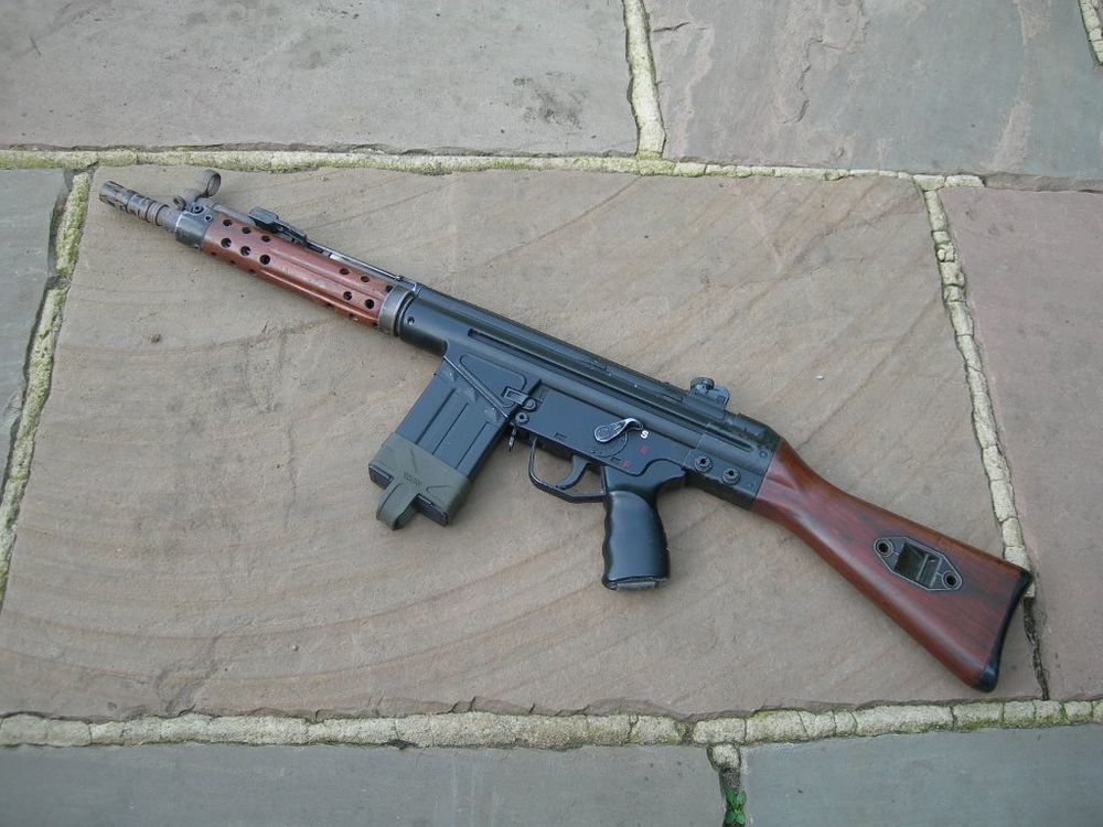

@Jacob Wright I think I've worked it out!
It's a Strike Back custom!
http://airsoftbuilds.com/images/weapons/1936220140306004107.jpg
In Season 3 of Strike Back, Stonebridge used a custom shortened G3 with a South African style vented handguard. The charging handle sits right behind the front sight post which is how yours is. This was a custom made rifle done by the series armourer in South Africa (where it was filmed).

If you bought it from a user here then chances are it's the one that was built by another user @Samurai
You have good memory @Lozart. My one had holes in the front handguard, mimicking the south african one and the small piece of outer barrel between the flash hider and the front was shorter.
I’m pretty sure that’s who I bought it off!
But yes now I look back at the Strike Back stuff you are right!
