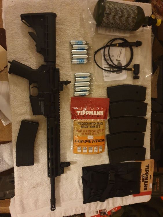

well...   i did it..   i fell to the dark side...
i purchased this start up set, a molle pouch to carry the tank and 5 CO2 mags to get me going....  https://www.battlezoneairsoft.com/tippmann-m4-v2-cqb-airsoft-start-up-package.html
now i need to try and get the tank filled as soon as lockdown permits
DAMN YOU AIRSOFT MIKE!!!   XD
And shes arrived....
Unfortunately lockdown means dive shops etc are closed so i cant get HPA bottle filled, so have fitted the CO2 kit so i can test fire her tomorrow.
The guys at battlezone airsoft also very kindly threw in a bag of .3g tippmann bbs and 10 co2 capsules too ?

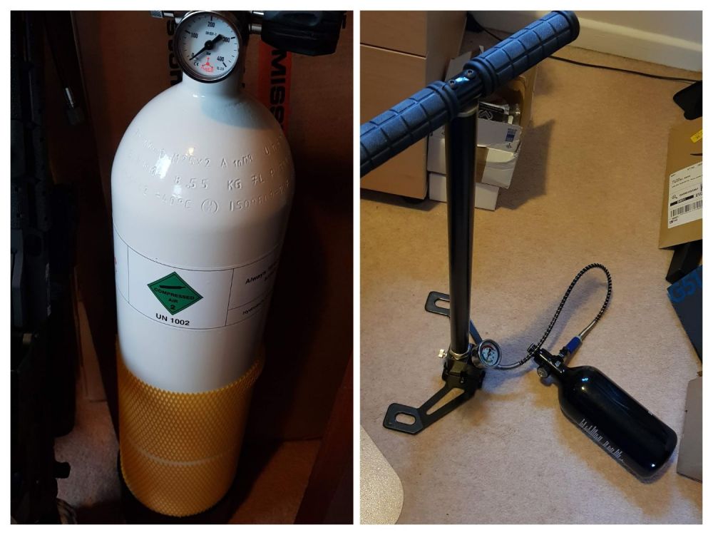

I bought a whole HPA setup when I got my MTW last week.  Unfortunately I cannot get the 7Ltr 300bar tank filled due to COVID.  So I ordered a 4500psi pump instead from Amazon.  Came today...easy to assemble and got cracking.  It does take a lot of pumps...probably 700+ to fill to 3000psi I've been told.  I'm at 2000psi atm, did it in 70-80 reps at a time...
I went for the big tank due to not wanting to run out of air on game days, plus when my buddies decided to join me in HPA World..I can fill their 48cl bottles as well. :)

I’ll recommend getting a filter for the stirrup pump
Something like this:
https://www.ebay.co.uk/itm/303587840945
I’m not endorsing that seller, just an example of the type of filter required
Yeah....   i think i will just wait until the local air rifle range opens again and get my dive cylinder and hpa bottle filled...  im too lazy for that pump, lol
