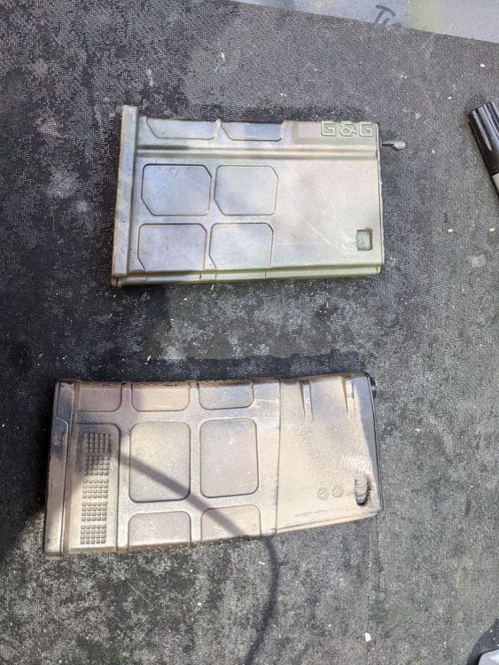

Kls77 Posted December 19, 2020 Posted December 19, 2020 Vrc scar mags are pretty crap at feeding tbh . Try the modded sr25 mags . Feedd do much better . Or try the g+g sr 25 p mags . . Not the metal ones as there crap too Taiwan gun have the battleaxe SR25 for about £7 quid each . The need a little dremil or fileing but work great
