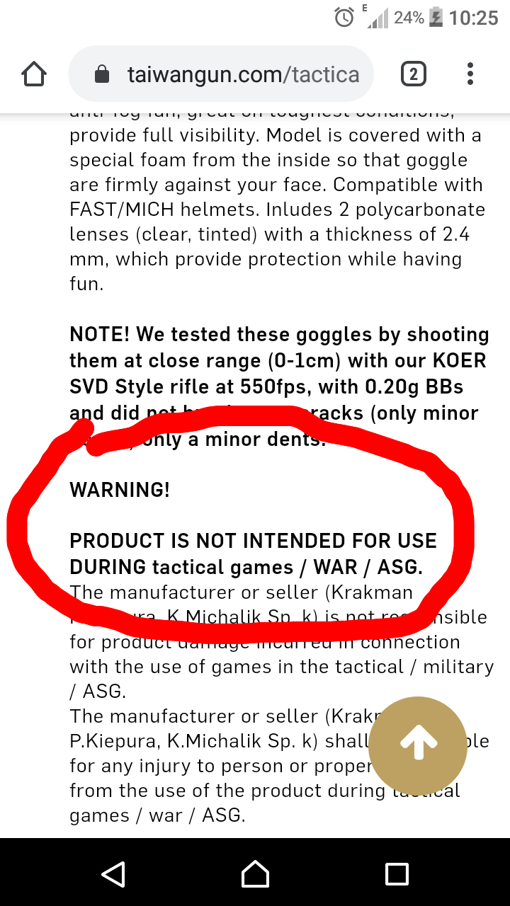

I could not find any impact rating on the website, claiming to survive 550fps from a koer SVD.

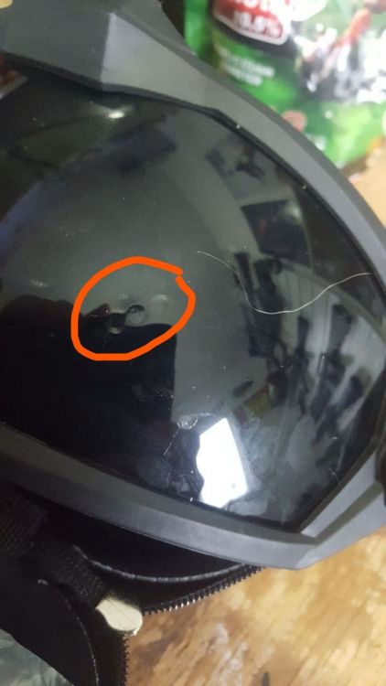

I fired 3 rounds of 0.36g bb's at 490fps from my cyma springer from about an inch away.  It left 3 little dimples where the left eye would be.  All seeming fine so far.

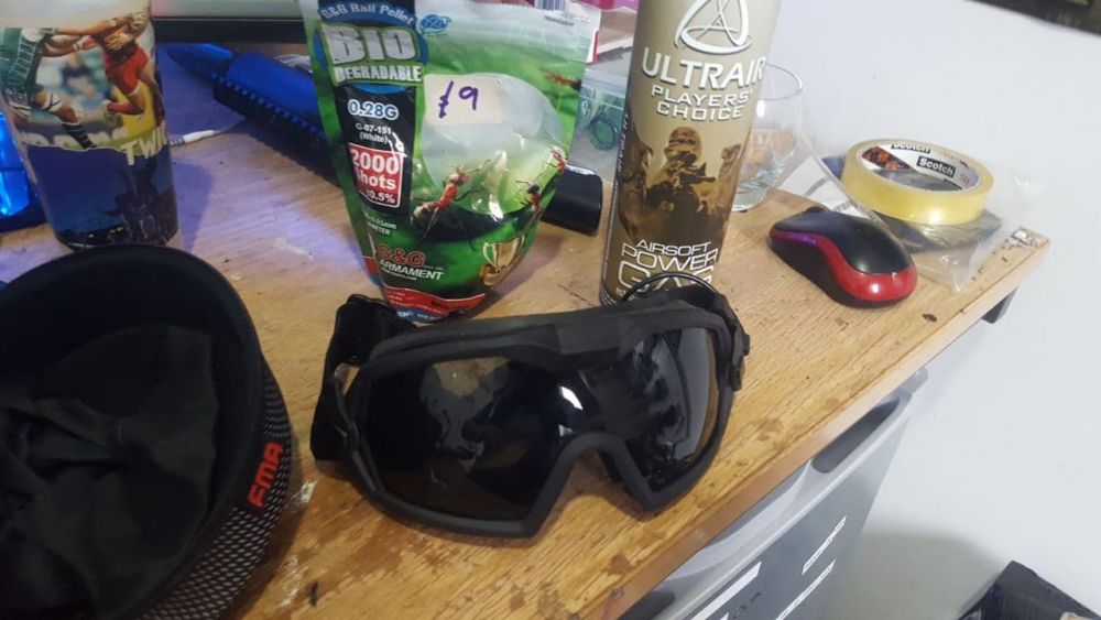

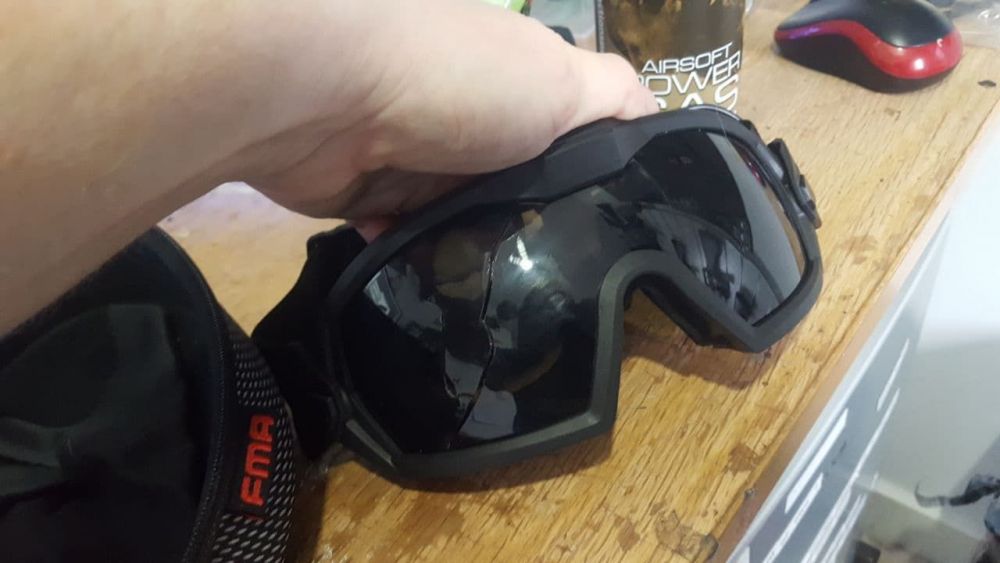

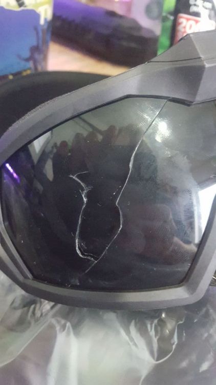

For the second test I brought out my gas TM M870 and fired 2 sets of 3 bb's all weighing 0.28g over the right eye, where it was as yet undamaged.  The first salvo bounced off fine.  The second.... two bb's went right through the lens cracking it majorly.  Not so good.

Was my testing a little too much for it? I mean, it shugged off the sniper with no problem, hell, the scuffs were not even bad.  The BB's and gas used that broke them are included in the photo.

Anyways that sentiment aside, if they are/were fit for purpose - after shooting them the first time you may have created an underlying weakness which has caused them to crack on receiving further hits. If any eye pro you use has suffered damage to the extent it has caused an indentation that large, a crack, or something similar it's at that point I'd recommend replacing lenses. It has been used up to its maximum tolerance and is likely no longer safe and I'm making a presumption here that the maximum tolerance for off brand eye pro is a sub 3 joule impact.

Exact same experience, tested with my DMR and split the smoked lens in two.

Yeah, on closer inspetion, I have removed the lens and its in 2 pieces
Note that the link to the goggles include the small print that they are it for use in ‘Tactical games / war / military / ASG’
Taiwan gun only state that they have shot them for testing.
