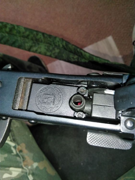

This is going to be a very hard one to photograph, but fortunately I currently happen to have an e&l 105 which can illustrate for comparison, as a note the assembled gun is the e&l and the disassembled gun is the lct (yes I stripped down a brand new gun):
so what you’re looking at there is the dust cover from the lct fitted to the e&l. notice how the bluing on the e&l is, well, blue, and the lct is more of a matt black, it’s much more evident in the flesh compared to photographs.
It’s not a bad finish per-se, and maybe it’ll wear in nicely, but I must admit I really prefer the e&l bluing. The lct’s finish almost looks like the paint you’d find on the lower end guns like jg’s or cyma’s.

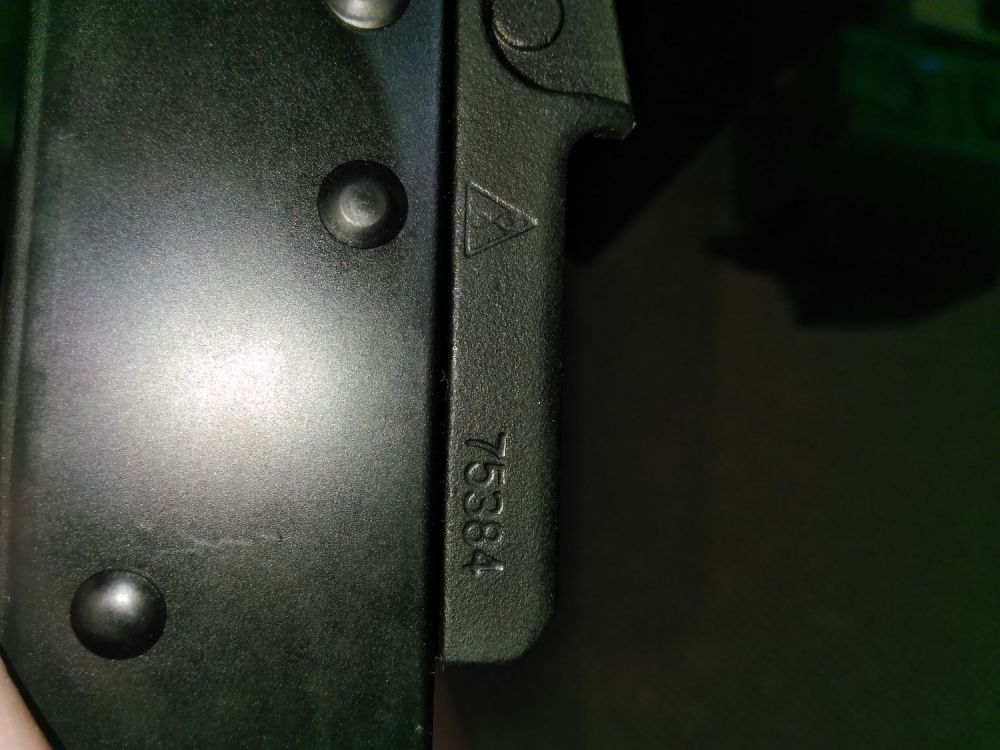

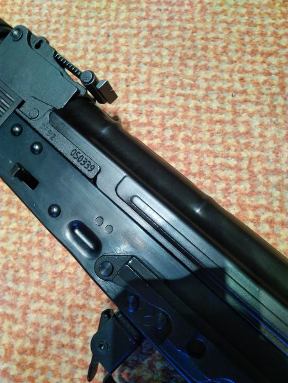

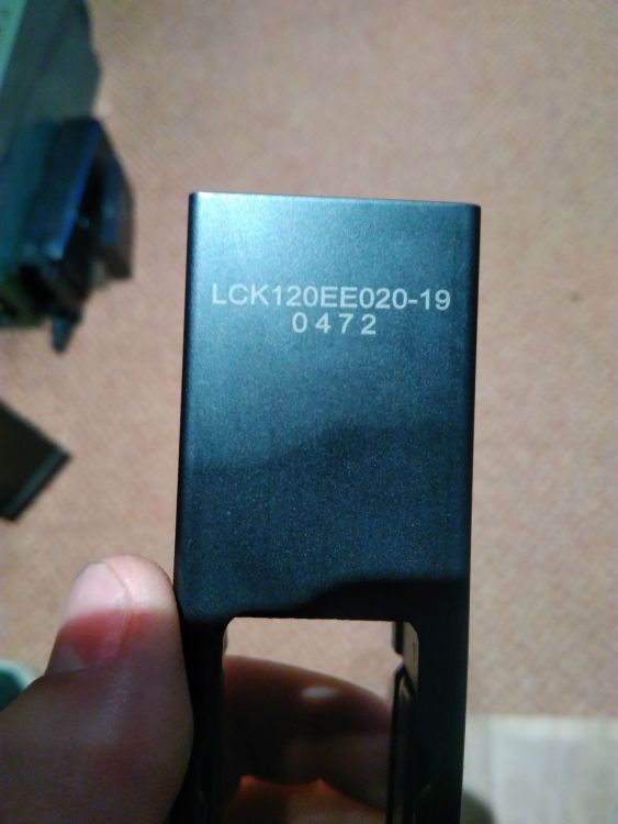

Next issue on the externals is this:
Now I’m not exactly a markings freak, I’m cool with a gun not having markings, but that really irks me having that etched on the bottom of the receiver, especially when they bothered to actually put markings on the trunnion:

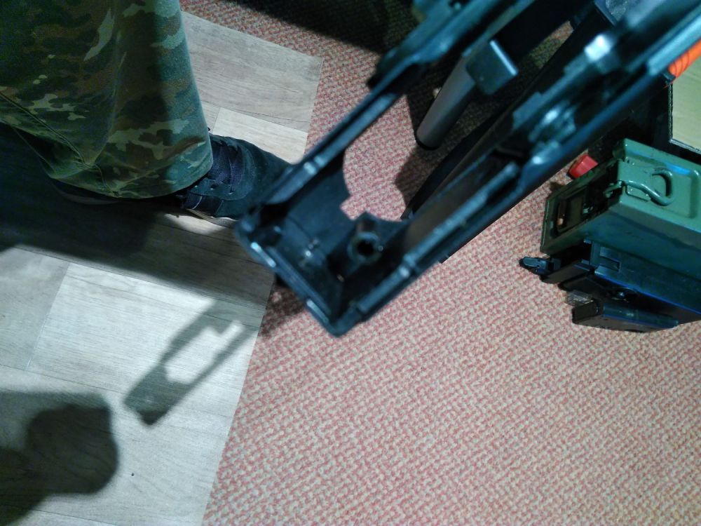

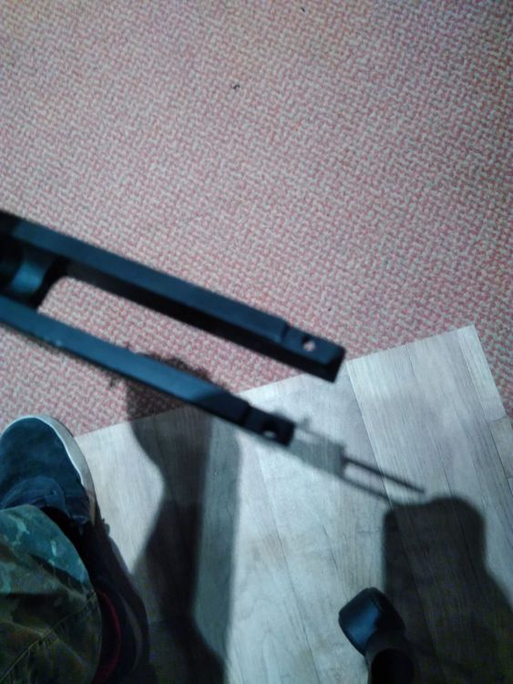

Moving on around the externals lets talk about stock fixing, the stock is held on by 2 pegs and a bolt into the rear of the receiver, but take a look at this:
Yep, that’s 2.5mm of metal if I’m being generous, not exactly the most robust mounting for a gun stock, fortunately the bolt protrudes quite a way so getting a nut and washer in there to secure it properly won’t be too much of an issue.
There’s also other details, this is kind of a spree of comparing lct and e&l and not really a functional problem, but observe that for things like the trigger guard, sight block, gas block etc which on an ak are either pinned or riveted have bolts on the lct. Now granted this means you can more easily remove them, which is a blessing or a curse depending on how look at it, personally I prefer the proper riveting on the e&l

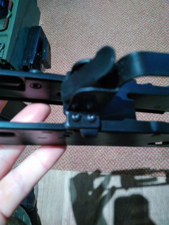

Lct trigger guard with bolts
E&l with rivets
e&l sight block with, well I’m not entirely sure how they’ve mounted that, I’m guessing a press fit because there are no screws or rivets holding it on:
Lct sight block with screws and pins.
Rear sight block where we see our choice of battlesight marking, the e&l appears to be more faithful to the markings on proper sights although I’m not enough of an expert to say that N isn’t also valid.

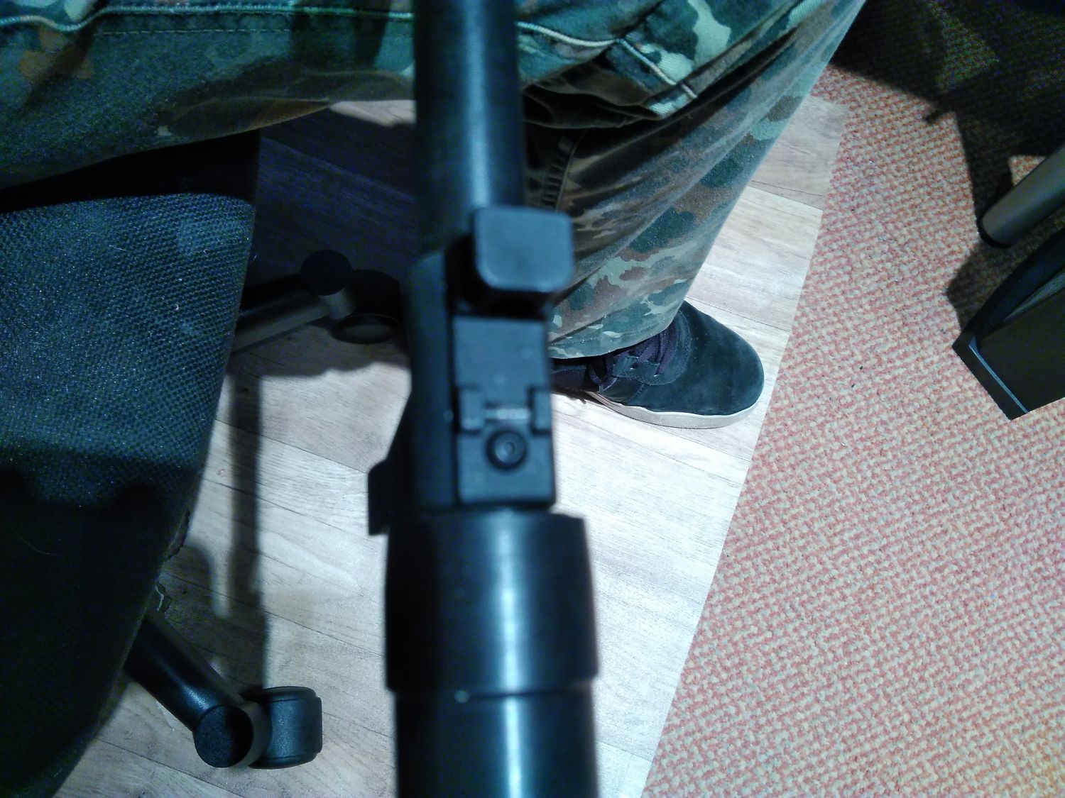

Next is the muzzle device, oh what joys…..

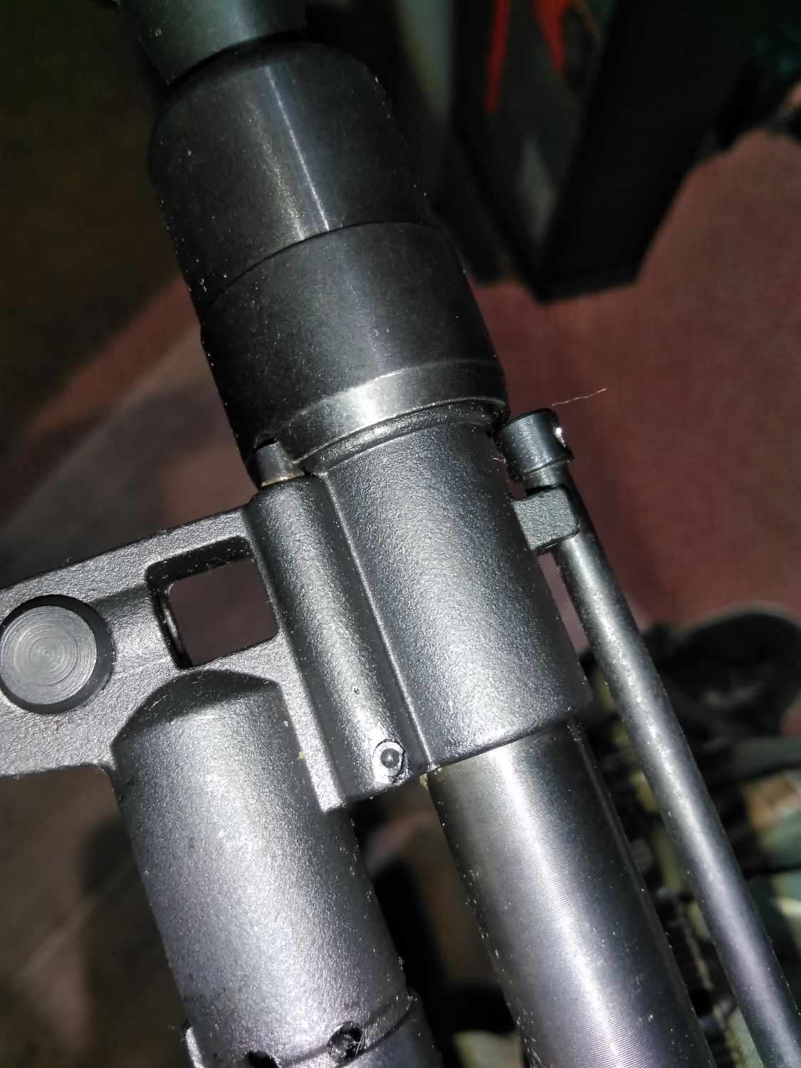

Out of the box it was a bit rattly, no biggie that’s a pretty common one, I’ll just do my usual trick of stuffing o-rings in there until it doesn’t rattle any more….

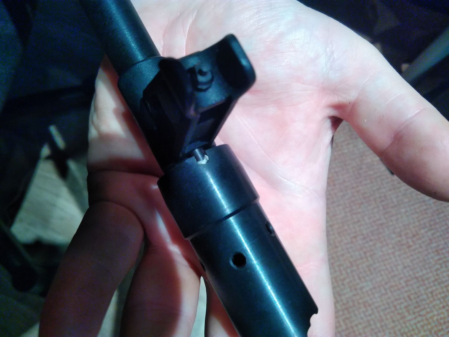

Well this is where we have a problem, for those unfamiliar with the ak platform the way you remove the muzzle device is you push down a pin and screw it off.
So the e&l we can see the pin is accessible with a fingernail also note how the cutout is rounded so you can poke something in there to pull the pin back:
Now contrast that to the lct, ignore the strand of ptfe tape I used to reduce the wobble:
What’s not evident from photos is how much of a pain in the ass it is to remove.
The pin is sunk in due to a lack of chamfer on the rear of the brake, meaning you can’t just get a fingernail on it and pull it back, and the square end of the slot meant I couldn’t even get a needle in the gap to push it back to get unscrewing.
Eventually I had to remove the front sight block completely, punch out the pin that holds the back end of the spring, pull the spring out (really awkwardly as it had to go round a 90 degree bend) then tap the whole assembly until the pin had shifted enough to get a needle in and pull it back.
So what should be a 10 second field accomplished job took 20 minutes and a bunch of tools.

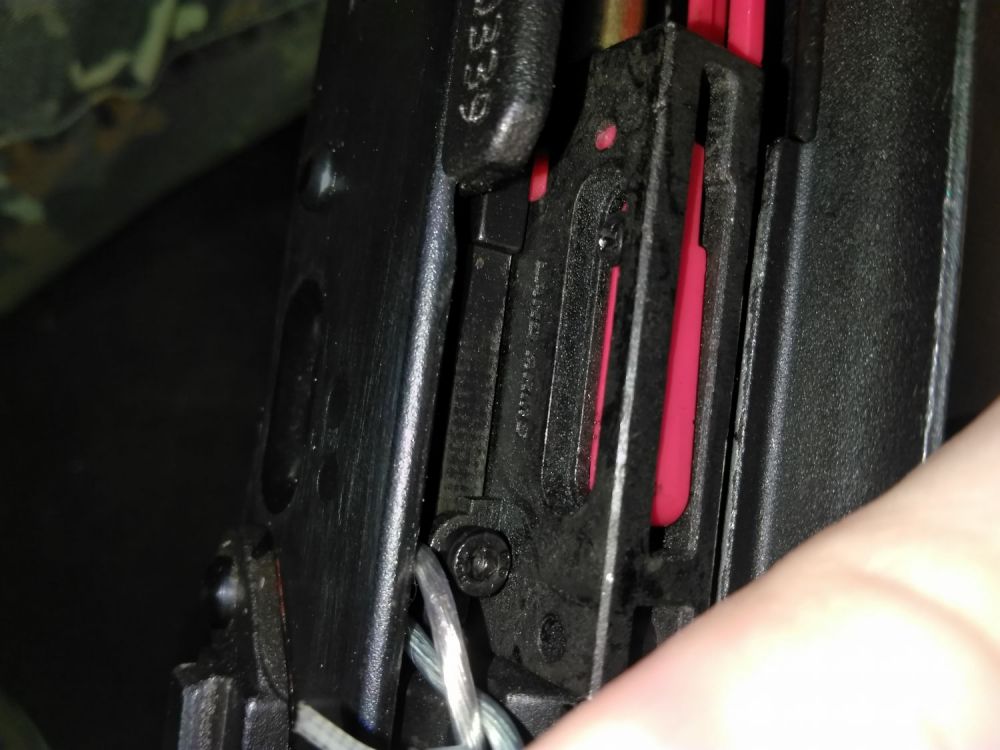

Lets start with the hop and magwell.
E&l you get a spacer as so:
Makes it nice and easy to get the front feed-lip into it’s slot for a speedier reload, not that I’m a tacticool reloading type but it’s a little quality of life feature you also enjoy on jg’s and cyma’s albeit implemented differently.
I haven’t got a photo of the lct’s magwell but it has no such spacer, meaning you’ve got to take a little extra time indexing the mag properly.

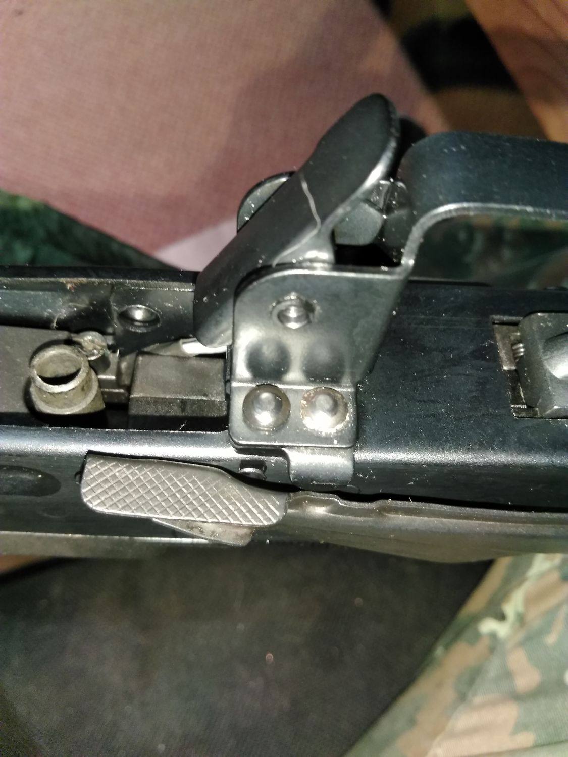

Next up is one of the really big bugbears- the hop mounting
So the standard way for pulling the gearbox on a top-wired ak is as such:
1.       Remove pistol grip
2.       Remove selector lever
3.       Unbolt hop
4.       Slide hop forwards
5.       Gearbox wiggles out the top of the gun
Pretty damn simple and I must say a much nicer process to deal with than say the extended process to pull the box out of an m4.
However, lets do a little comparison:
Note the “step” in the barrel extension, on the e&l this is about 1.5” forward of the hop mounting, meaning plenty of room to slide forward and clear the nozzle, jg’s and cyma’s are the same although they have various blocks that need to be removed/slid forward to make clearance (and require the nozzle to be in the rear position)
However on the lct you can’t do this, so as far as I can tell it’s not possible to remove the gearbox without pulling the whole goddamn outer barrel assembly off, maybe owners can chime in on this if there’s a trick I’m missing but for the sake of a few more seconds milling time they could have made it so much easier.
Whilst I’m going to reserve judgement on the hop for when I actually fire it, it’s a plastic unit compared to the aluminium unit on the e&l, now plastic hop units aren’t necessarily bad (hence reserving full judgement) for example jg’s white plastic hop units are really good, but the lct’s doesn’t look or feel even as well made as the jg unit, in fact it feels much like the unit you got with the ASCU2 mosfet with the microswitch for last round cutoff, anyone unfortunate enough to own one of those knows exactly what I’m talking about.

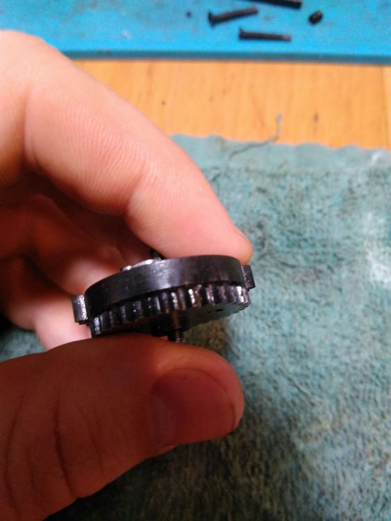

So pull the box and take a look. For starters the air seal isn’t quite as good as the e&l (although certainly passable) however the real problem is the gears….
I mentioned earlier gunfire’s tech department had already opened the box to downgrade the spring but I have no reason to believe they’d mess with the shimming while in there.
However we find 3 shims total of ~0.3mm
After taking the time to do it properly it needed nearly 1mm of shims on just the sector gear alone and it was a massive pain in the ass getting the gears into a position where they wouldn’t rub against each other or the box. However this didn’t fix the issue, she’s still sounds awful, well here’s why:

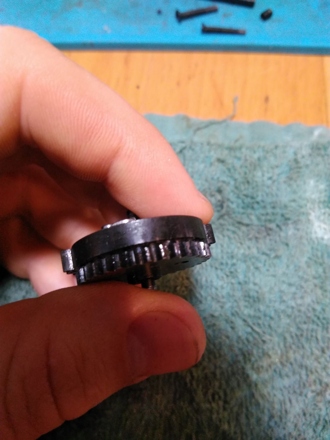

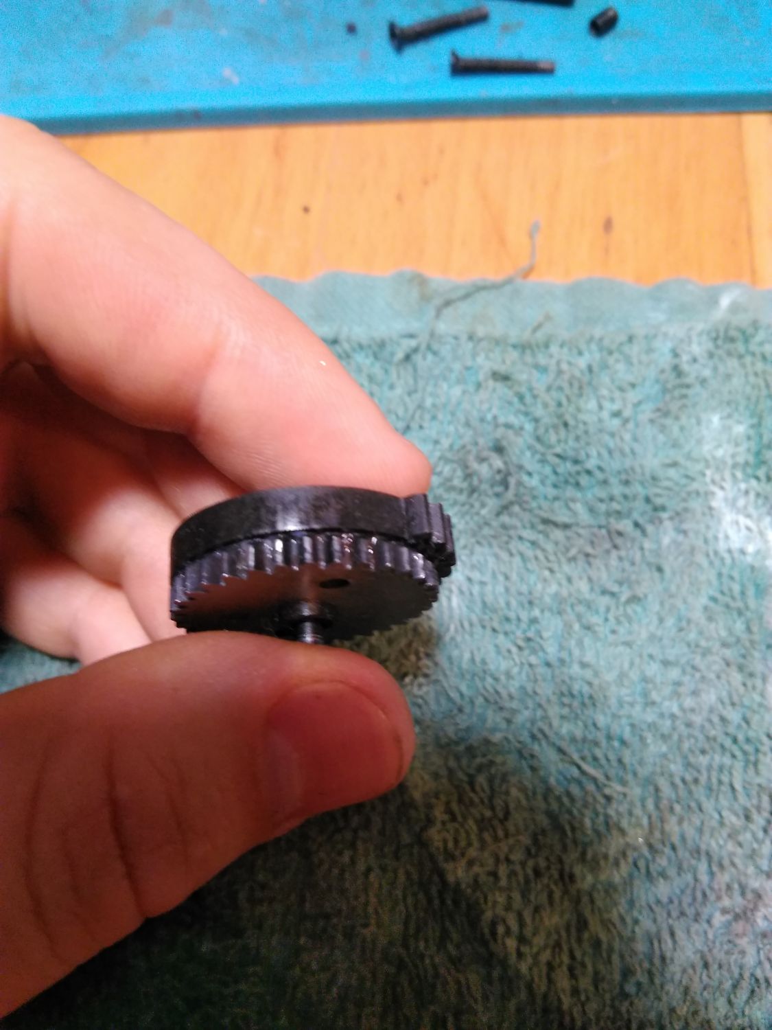

IMG_20200904_120638.thumb.jpg.12522b755eaf21ab9c7dc33de43d45cd.jpgIMG_20200904_120647.thumb.jpg.9021cba940556d56a00f7c2a8b1e25e5.jpg
It’s kinda hard to see on camera but there’s visible pitting and roughness on the engagement surfaces of the gears.
Sure the faces of the gears are all shiny and machined down, but the actual business end that does the needed job is atrocious. It says a lot that a jg or cyma of 1/3 the cost gets this shit right.
the bevel gear admittedly doesn’t have this roughness, instead it’s such a tight fit to the bearings it needs to be punched out and makes splitting the box a massive pain, although granted once assembled a nice tight fit to the bearings is a good thing.

on the subject of welding the spot welds on the reciever are rather visible and not particularly neat, so maybe they are cutting corners there.

Had some issues with the rocket motor, ak2m4 replaced it and she ran a game with it ok but seems maybe they dont like warfets.....
Anyway, that's by the by as what i'm really posting to say is the goddamn trigger broke, pin sheared clean off.
All the brands i've worked on this is a first.....

I can definitely agree with pretty much all of your comments in the OP, that said the fit of the components in the receivers are very good, and the gearbox shell itself is excellent quality with actual threads and M3 hardware.
OOTB I’d agree the E&L is a better buy if you are going to run it stock.
If your buying to build a custom setup the model options and “strip-ability” of the LCT is good.

I have built possibly the finest gearbox to date (by/for me) ever using the LCT as a base gun. Quietest box ever ?
I can PM you a parts list if your interested.
Not sure i'd say this lct at least is as strippable nor the box as good as e&l's. Still cant get her "nice" sounding...
I'm at the point of thinking swapping it out for a cyma box is gonna yeild better results, and i'm really not kidding.
