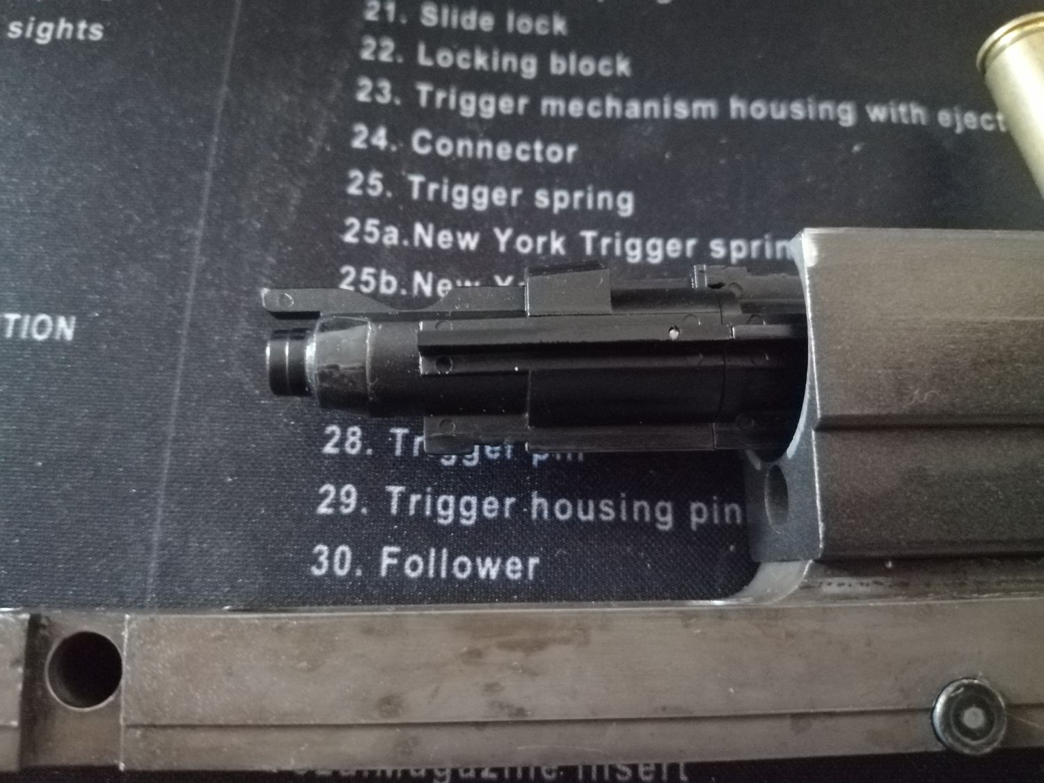

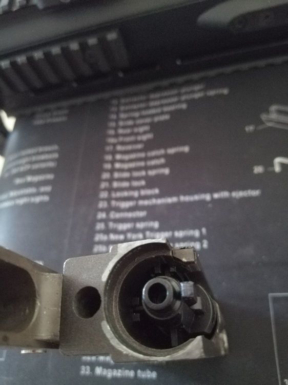

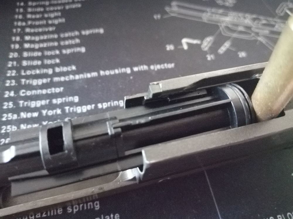

It was stripped and lubed when I got it, I can't see anything funky when it's apart but have included some pics below, hopefully these will help somehow

Back on topic, get the hop up out and check over the bucking. Nozzle to my eyes looks ok so on to the next component.
