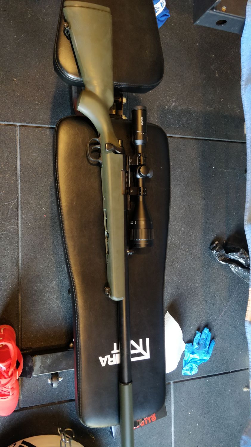

Rifle now looks like this! Had to give the string a hair cut on the supressor at it kept on getting snagged. A few spray painted and burnt maple leaves have found their way on as well!
I've also starting slinging 0.43's. A bit too early to say if I can tell much difference, there were a few windy spells on Saturday where I was having to aim about 10ft to the right to hit someone. Got a massive buzz from hitting folk and them not having a clue where it came from. Especially as my concealment only consists of some fern leaves stuffed into my boonie!

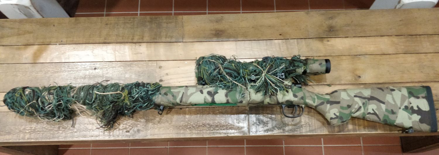

I am currently working on strapping my DTD to a Helikon TMR (using a few zip ties), so I can carry the MK23 with my AEGs.
On my sniper kit I'm using a simple universal fabric holster ziptied to a backpack's left shoulder strap.
EDIT:
https://i.imgur.com/lMfG9nN.jpg
This is a very old kit I built 2 years ago.
The concept is the same.
https://i.imgur.com/Z0dvR0e.jpg
https://i.imgur.com/nkVf1Nx.jpg
A more recent kit, this time the holster is ziptied to a chest rig, but the result is the same.

Medium sized update.
Stripped the rifle down to get rid of the two tone now I've got my UKARA!
I purchased a Gunsmithy TDC and had an email about the G-Spec ML Crazy Jet barrel being back in stock.....
So I thought, why not. I wanted to see if it made any difference at all.
So now we have this
Also got a cheap spirit level scope ring.
A bit of testing and with zero hop (bare in mind I'm just chrono'ing, no range testing is being done) it's kicking out 440fps ish.
Massive difference, maybe I teflon taped it better than the last barrel, who knows.
So I tested my Nov 0.46's and...........as @Groot has been experiencing, JOULE CREEP. Can't remember the FPS right now but 2.8ish Joules. Dropped the weight to 0.43 and then to 0.4 but even then, still slightly over on the joules.
So, just what is a boy to do?
