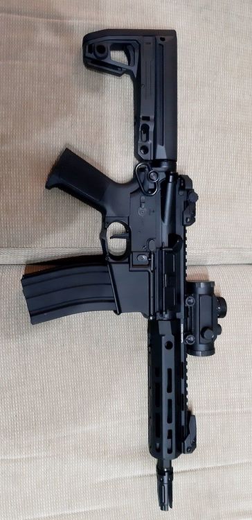

Stevobeavo Posted October 26, 2021 Posted October 26, 2021 There are M4 and pdw stock variants then polymer and metal versions of the same guns. I love my 904g, 229mm zci barrel, maple leaf bucking and omega nub from ak2m4 made a big difference. RostokMcSpoons 1

Stevobeavo Posted October 31, 2021 Posted October 31, 2021 I think I bought the last 904H from patrol base on Friday night! Should go well with my 904G.
RostokMcSpoons Posted October 31, 2021 Posted October 31, 2021 13 minutes ago, Stevobeavo said: I think I bought the last 904H from patrol base on Friday night! Should go well with my 904G. There not much finer recommendation of a gun than buying a second variant of it...!
