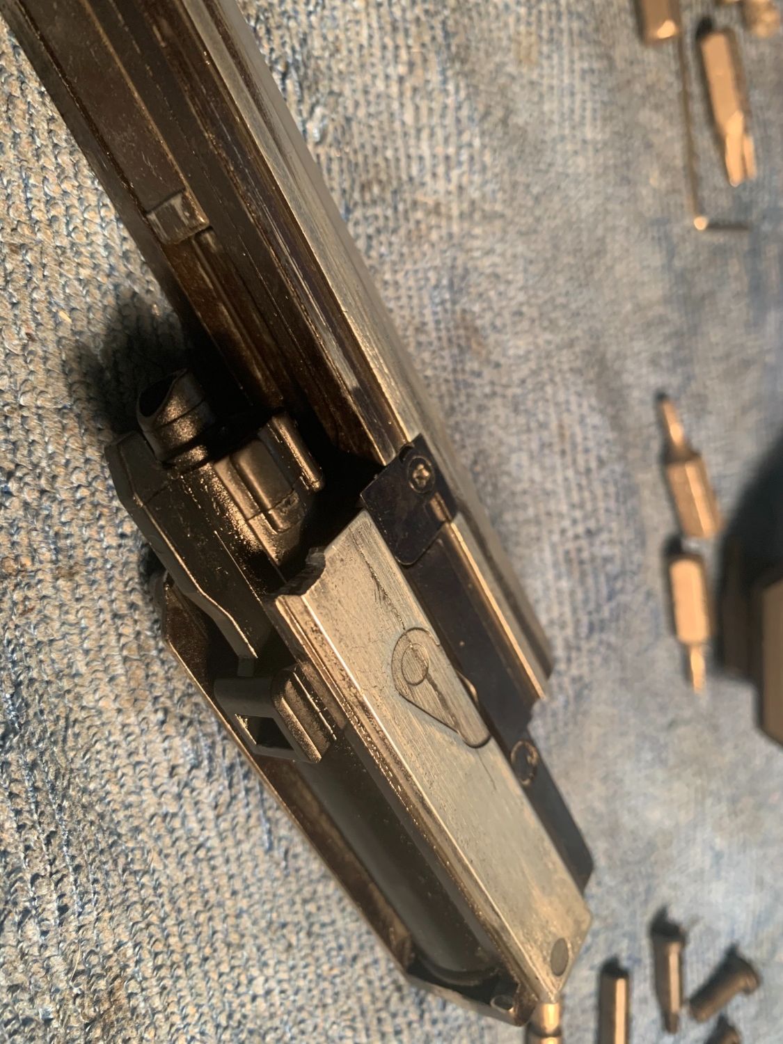

I did, and as I assumed, its the bolt not contacting the full auto sear. You can add all the tape you want to the trigger bar. Its the bolt that has to contact that sear, to release the hammer. The trigger bar doesnt effect it. The best way to simulate this is by removing the chassis from the body.
Remove the trigger bar and spring
Pull down the hammer by hand.
Then pull the semi sear (The part the trigger bar connects to) all the way forward. I guarantee nothing happens.
Reach in and push the Auto sear forward, and the hammer will now fall once you pull the semi sear.
Unless the newer sears are modified slightly, and my MP7 has a very worn out sear/older design. The only fix is to add material to the auto sear, the bolt, or use a stronger recoil spring
I already bought a right hand chassis because of this issue, but now the left hand has broken... urghhhhhh! That’s another £30 odd part I need once in stock
Okay, so actual progress now!
i did my sear mod. 2mm drill bit, extra due care, some glue and 2mm rod.
Rack the gun, she shoots,
bolt locked back? New mag in and send it home, she shoots.
Much more reliable now! Hopefully she stays that way so I can use it for a game!

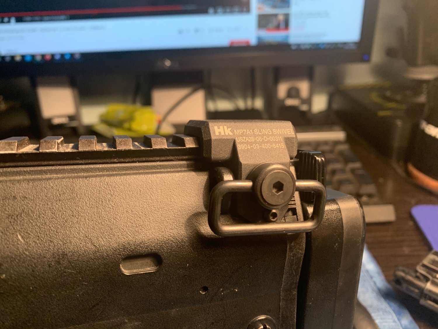

To stop the cases cracking at the pin point buy the rear sling mount. The metal bracket secures the pin to it and eases pressure off the frame. I’ve got one fitted after breaking mine and it’s been great since.
Expand
Im guessing thats how some one singed it in the past. It came with a magpul style RIS sling point with the gun.

Rear slung mounted added. Part of the back plate replaced after a little bridge over the stock broke.
Ive modified the bolt slightly, grinding material away with a deremel to increase bolt lock reliability.
