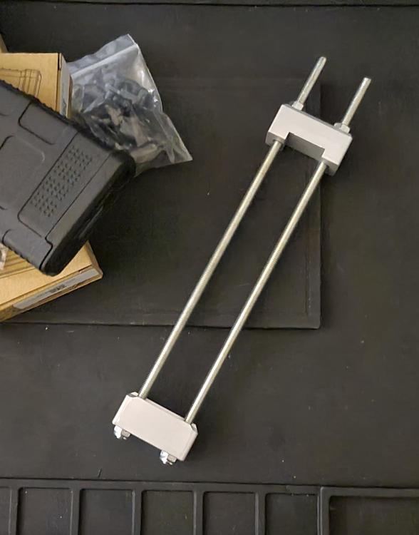

C-Diddy Posted September 28, 2023 Posted September 28, 2023 Anyone know how this Guns Modify MWS magazine maintenance tool works?
SSPKali Posted September 28, 2023 Posted September 28, 2023 2 hours ago, C-Diddy said: Anyone know how this Guns Modify MWS magazine maintenance tool works? I guess it compresses the top part of the magazine (feedlips and gas router end) so you can get the pins in. I usually push the mag against the edge of the work bench with my hip and tap the pins in ??
