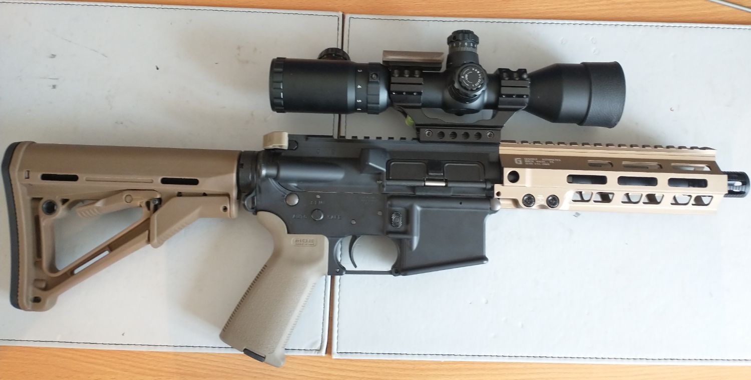

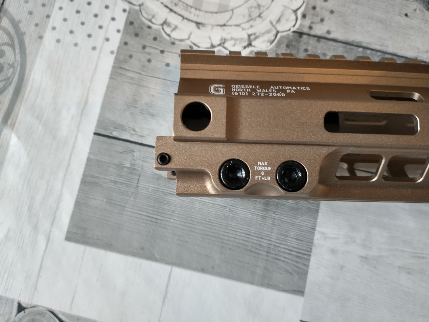

GothicGhost Posted May 15, 2021 Share Posted May 15, 2021 Just got mym-lok rail from JK army and the one thing I am worried about is the rail anti rotation grub screws (correct name?) are metal and not nylon. I take I should not use the anti rotation grub screws until I can replace them with nylon ones so I don't mark the body of the gun? Does anyone know the size I would need ? Thank you for any help. Link to comment Share on other sites More sharing options...
SSPKali Posted May 15, 2021 Share Posted May 15, 2021 2 hours ago, TadsJ2 said: Yes i am talking about this adjustable valve STOP. I am trying to use it in conjunction with G&P plastic nozzle which came with reinforced nozzle set, but I dunno, it just seem not to work with it... Maybe its because my inner barrel is 410mm length? Well dunno, I am going away for vacations, will have to try more when I get back, somehow my TM MP7 is shooting as consistent as MWS does with G&P 5.0 NPAS set and all other upgrades (MP7 wasnt upgraded at all, just nozzle changed to reinforced one), just MWS is shooting further away, probably because of ~33FPS difference between them I found the stop gave lower FPS (260fps?) on the "high" setting than the stock TM one. Mid and Low were noticeably less (220fps and 150fps IIRC?) This was with 0.30g BBs and a 255mm barrel I took 0.1mm off the prongs on the front and it raised the FPS quite a bit (+30 to +50fps depending on setting) so only a small change in position makes a HUGE difference in the output of the gun. Link to comment Share on other sites More sharing options...

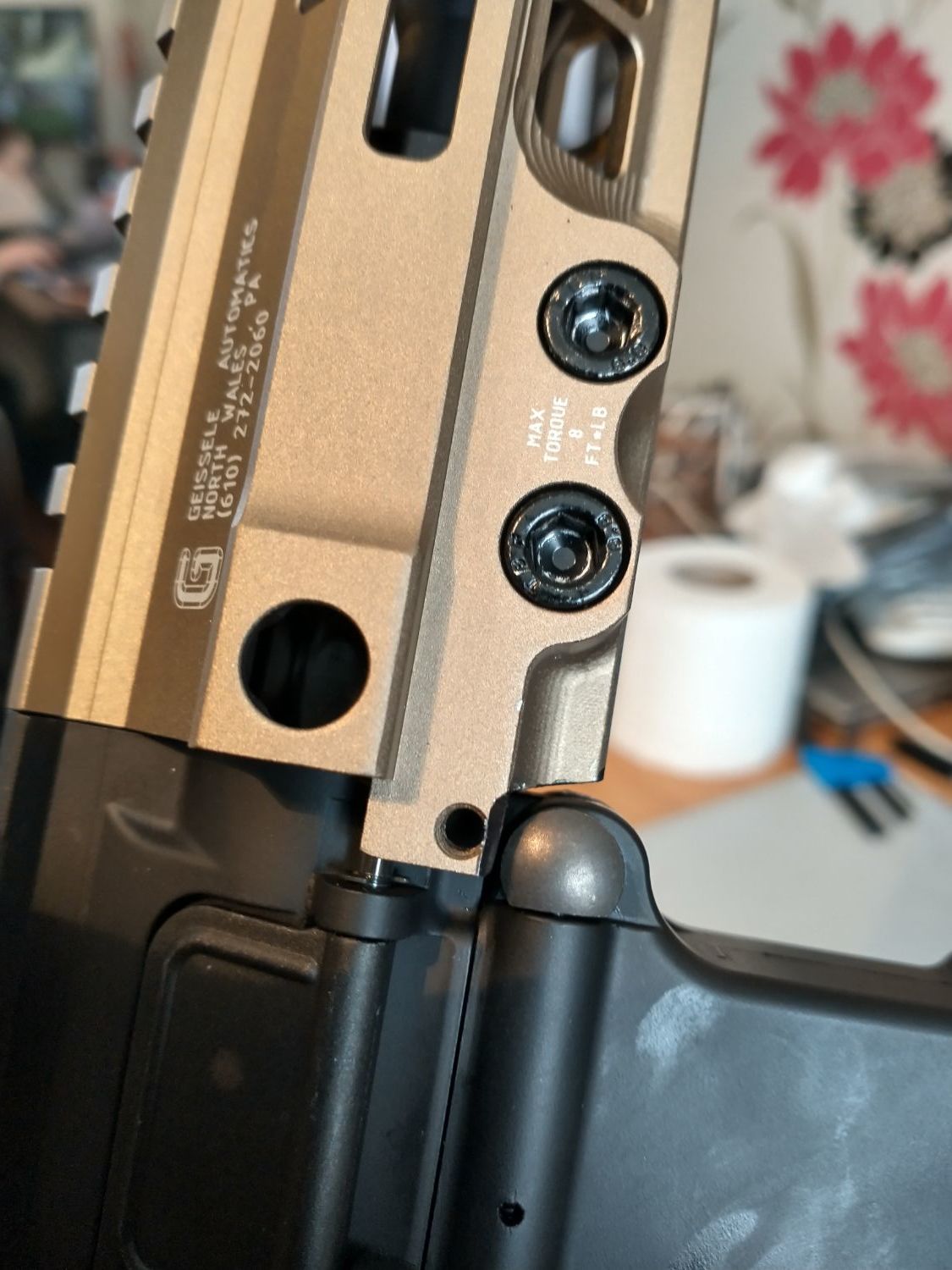

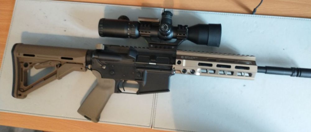

GothicGhost Posted May 15, 2021 Share Posted May 15, 2021 Okay I got the rail on now but I had to file down area where the front take down pin makes contact and the area where the pin goes passed the anti rotation screw block or I could not connect the upper and lower together. Now I did try with my 7inch inner barrel but the fps was bit low with .25 from 200 to 236 FPS on 134a gas so i will wait till I get hpa so I can bump up the PSI aa little. So I added the stock inner barrel back and used extention barrel bit for now but I think the stock outer barrel would be shorter so I will change it again later. Link to comment Share on other sites More sharing options...
quango2k Posted May 15, 2021 Share Posted May 15, 2021 1 hour ago, GothicGhost said: Okay I got the rail on now but I had to file down area where the front take down pin makes contact and the area where the pin goes passed the anti rotation screw block or I could not connect the upper and lower together. Now I did try with my 7inch inner barrel but the fps was bit low with .25 from 200 to 236 FPS on 134a gas so i will wait till I get hpa so I can bump up the PSI aa little. So I added the stock inner barrel back and used extention barrel bit for now but I think the stock outer barrel would be shorter so I will change it again later. What on earth is going on here lol Link to comment Share on other sites More sharing options...
GothicGhost Posted May 15, 2021 Share Posted May 15, 2021 The 50 shades of tan lol quango2k 1 Link to comment Share on other sites More sharing options...

quango2k Posted May 16, 2021 Share Posted May 16, 2021 11 hours ago, GothicGhost said: The 50 shades of tan lol I was more talking about the tiny rail and a long range scope lol all kinds of frankengun going on. Keep doing you lol. Fyi buddy, those anti rotation screws are supposed to be metal. Just use them, mark the body..it don't matter..its gonna get dings anyway. 58 minutes ago, Wild Weasel said: Still on the plastic buffer after two years with no problems. With regards to upgrades if I could go back and tell my younger self I'd upgrade the hop nub (six g) the lightweight bolt catch and green gas mod the mags and save the money for externals as I've tried most 'upgrades' and found for me anyway that there a disappointment and had to spend money reverting to original parts and I now hit a crouching man size target at 60m at under 350fps. listen for the ting of the hits - 2x sprayed joined metal plasterer's hawks targets 325x650mm in size shooting 0.30g Geoff's super natural bio bb's on a windless day. VID_20210514_223111.mp4 27.42 MB · 0 downloads You should be able to lift .46 with the brass nub and reach 70m. Worth trying. Wild Weasel 1 Link to comment Share on other sites More sharing options...
