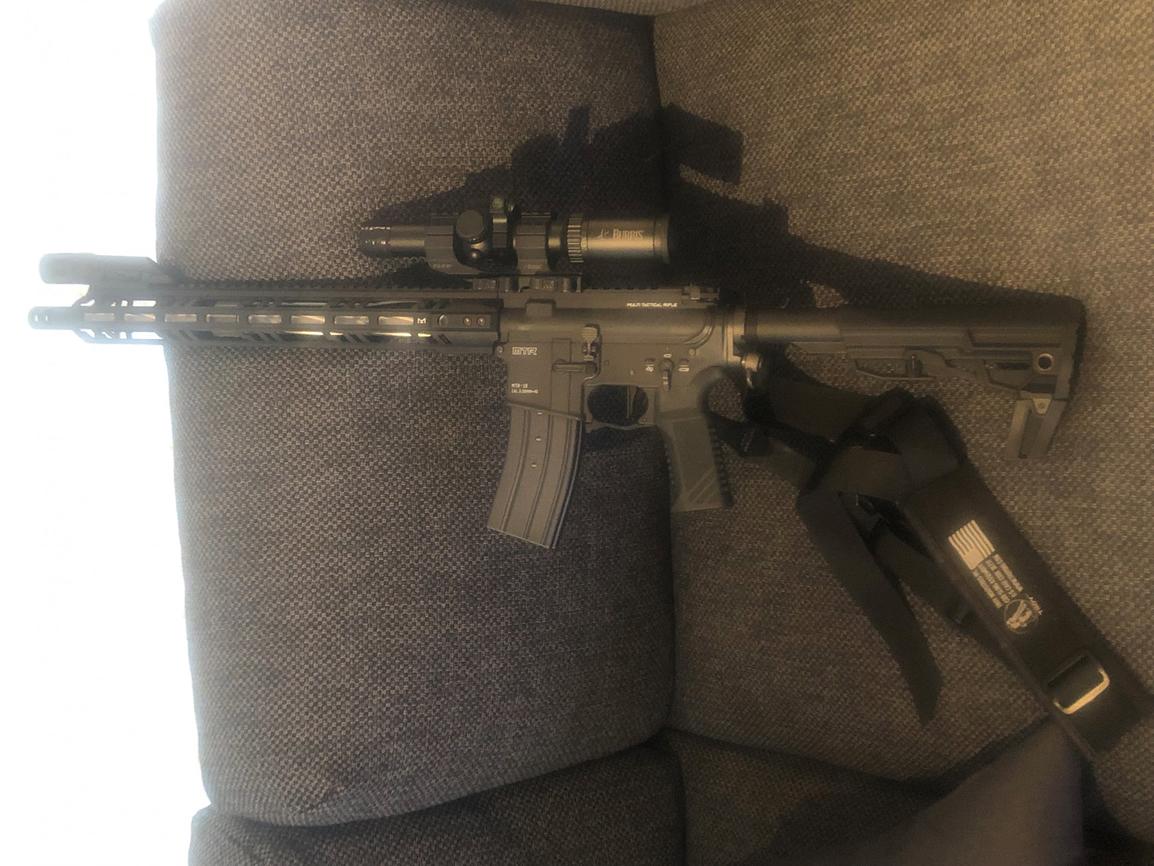

Boristhedriver Posted February 5, 2020 Posted February 5, 2020 Ive just listed my MWS on Prefired if anyone is looking to make the plunge.
Guest Posted February 5, 2020 Posted February 5, 2020 11 minutes ago, Boristhedriver said: Ive just listed my MWS on Prefired if anyone is looking to make the plunge. errr, list it here as well?
